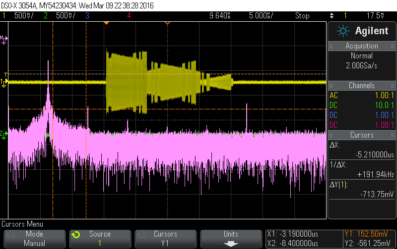

           After established a link between FPGA and DAC37J82, i want to send data  to DAC to check whether it's working properly.
1) when i send constant 0x7ffffff0 (twos complement ), i can get a perfect sin waveform.
2) The data  i  send is :0x7ffffff0 - 50000*i . (twos complement ). the image2 attached is what i got from DAC output using oscilloscope.
     I think DAC output is out of order. Please help me to figure out what's the problem: DAC configuration errors or  DAC is broken
   Thank you so much and best regards

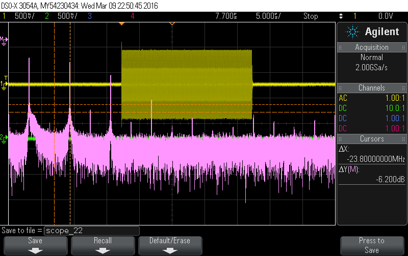

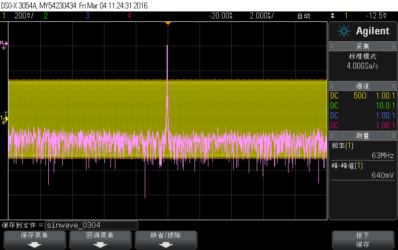

  • Hi Kang:
       the fiure below is the waveform i got from DAC output.
    figure 1  62.5Mhz with constant value
    figure 2  62.5Mhz with  liner data(32768 -->  2678 )
    figure 3  31.25Mhz constant data -1
    figure 4  31.25Mhz constant data -2
    1 ) figure1and figure 2  : same frequency (62.5Mhz)with constant data  and liner data.
    2) figure 3 and figure4 : 31.25Mhz with constant data
    Q: we can get correct waveform when F=62.5Mhz. but  when using other frequency , we can't get correct waveform .  why?

  • Hi Neeraj,
    Thanks for you reply.The constant and linear data are the amplitude of a sine wave. The sine wave is generated by NCO (inside or outside).
    best regards .
    Allen
  • Hi Allen,
    Since the DACs is able to generate a signal with constant amplitude I think the issue is with FPGA. Have you checked DACs output using DACs internal constant data? Please use DACs internal data and NCO to generate the signal at your desired frequencies.
    Neeraj Gill
  • Hi Neeraj,
    thanks for u help, the problem is solved. It's a configuration error, the SerDes lanes is inverted because config63 is set to 0xff. atfter i clearn this register. the output is normal.
