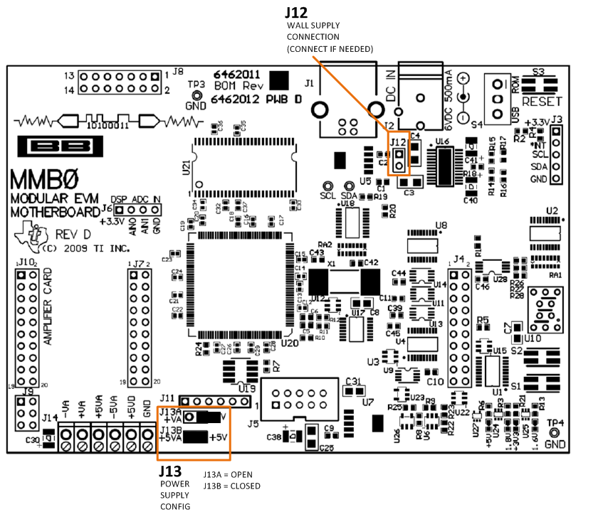

We bought ADS1282 EVM with MMB0 REV-D motherboard. I need default jumper settings for MMB0 Rev-D motherboard as manual shows only MMB0 Rev-C motherboard.

Here is what the default jumper settings look like for the REV D version of the MMB0:
Note that you don't need to configure the S2 (its hardwired on REV D). Also, J13 was split into J13A and J13B.
J13A needs to be disconnected so that you can connect external +/- 10V supplies to +VA and -VA, respectively.
