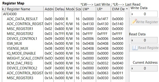

  • I've have put a screen shot of the register tab below. This time I've tested across a 560 ohm resistor with no input impedance and it is still low. Hope there is a clue to the register values.

  • Hello Cameron,
    I do not see any issues with the register settings.
    Do you use the BCM measurement tab or configure the settings directly?

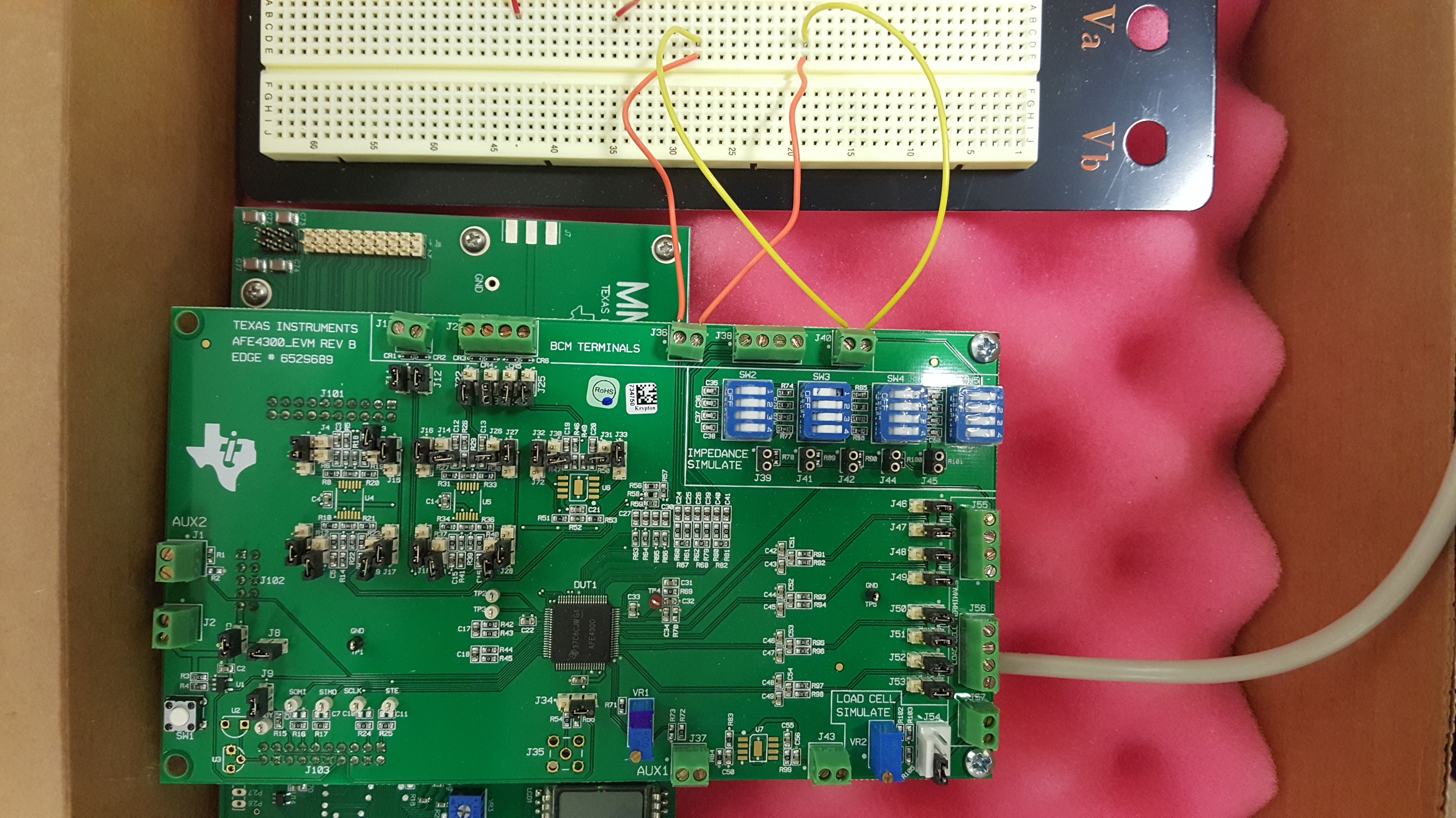

    I hope this reveals something, I notice now that SW4-1 voltage is the only one higher than your results, it's possible I recorded that incorrectly if that is unexpected. I've also attached a picture of the board just incase that will help as well

  • Hi Praveen,
    Sorry to be a nuisance but getting this working is looking to become a time critical job for us. It's been almost two months since I first flagged the issue, could you give me an idea of what your thoughts on the problem could be soon? I will have to look to return it as a faulty unit and try another one if nothing can be identified in the next week.
    Cameron
