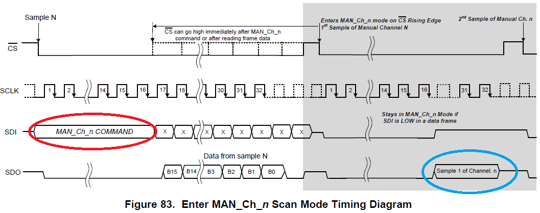

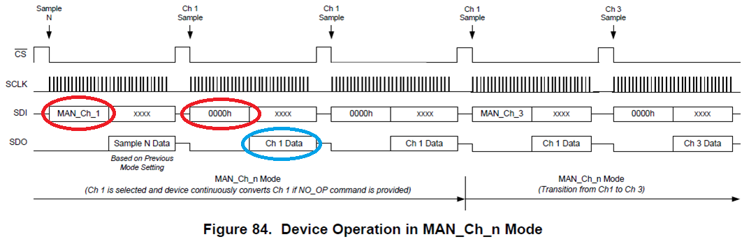

  • Hi Carlos,
    To get the data  on the channel you want, two complete frames of 32 SCLK cycles should be implemented on SPI bus:
    1. Write a valid manual channel n select command(MAN_Ch_n in red circle) into the command register with 32 SCLKs.
    2. Send No_OP command(0000h) with another 32 SCLKs because the conversion will be activated on the falling eage of /CS, the analog input signal on the channel selected in the previous framel will be converted during this particular frame. The converted data will be retrieved in this particular frame(blue circle).
    Please refer to the timing diagrams as below:
    Please let us know if you have more questions. Thanks.

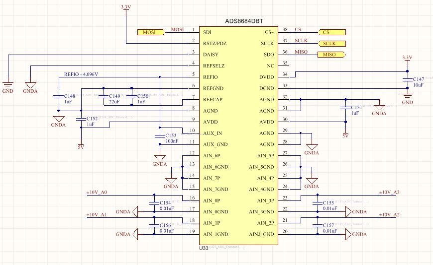

  • Hello Dale Li,
    I thank your time.
    Soon she sent him the CS curves, SCLK, SDI and SDO.
    First of all, I would like to observe my wiring diagram to see if there is a problem.
    Note: I plan to use only one ADS8684 with its internal reference.
    Best regards
  • Hi Carlos,
    One problem for this schematic, the decoupling capacitor on REFIO should be at least 10uF, but 1uF(C148) is used in this circuit. Please modify and check again.
    You have two grounds, GND and GNDA, I would like to see the pcb layout, and wait for the timing screenshot as well. Thanks.

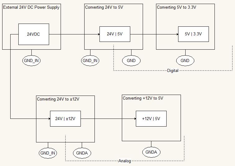

    I use GND (Digital) and GNDA (Analog), as shown in the following diagram:
    Greetings.

  • Hi Carlos,
    Looks like your have three grounds, GNDA,GND and GND_IN. Where is the Ground connection? especially GNDA and GND, I can't get the information from this simple diagram.

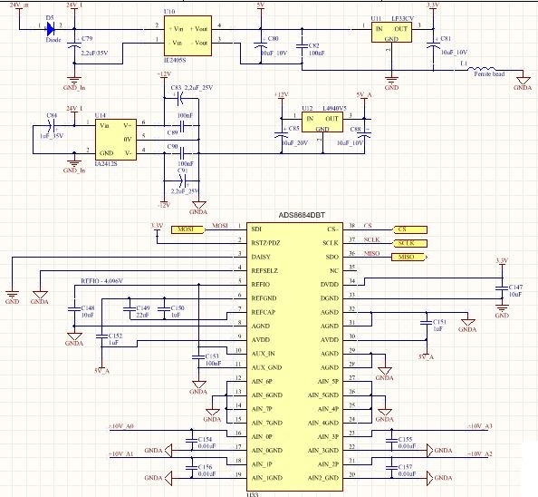

  • Hello Dale Li,
    Thanks for your response.
    Already replaced the 1uF capacitor for a 10uF.
    My SPI configuration:
    SPI_MODE1 (CPOL = 0, CPHA = 1)
    clock source = UCSSEL_2
    clock divider = 5
    My ADS8684 configuration:
    Keep the default setting.
    Vref = 4,096
    input voltage range is ± 10V (± 2.5VxVref)
    Channel 0 in manual mode
    The results obtained are:
    AIN_0P ADC [range]
    0V 30000
    5V 15000
    The electrical schematic is as follows:
    Thank you
    Greetings
  • Hi Carlos,
    The problem to cause wrong conversion code is, your REFGND(Pin 6) is floating and it should be connected to analog ground, please refer to datasheet. Check the voltage on REFIO and REFCAP to make sure correct.
    I still can't get any information for your GNDA and GND because of no pcb layout and I don't know where is the Ferrite bead's position on the pcb board. The guide line is, the joint point should be close to ADC or a whole ground plane can be used and keep the ground clean.The improper design will degrade the performance.
    By the way, Pin 4 should be connected GND if you split the ground. C152 on AVDD pin should be connected to ground for decoupling purpose.
    Best regards
    Dale
    Regarding the ADS8684, I discovered that my problem was to use the spi mode CPOL = 0 and CPHA = 1. When I put the spi mode CPOL = 0 and CPHA = 0, I managed to read the ADS8684 data correctly.
