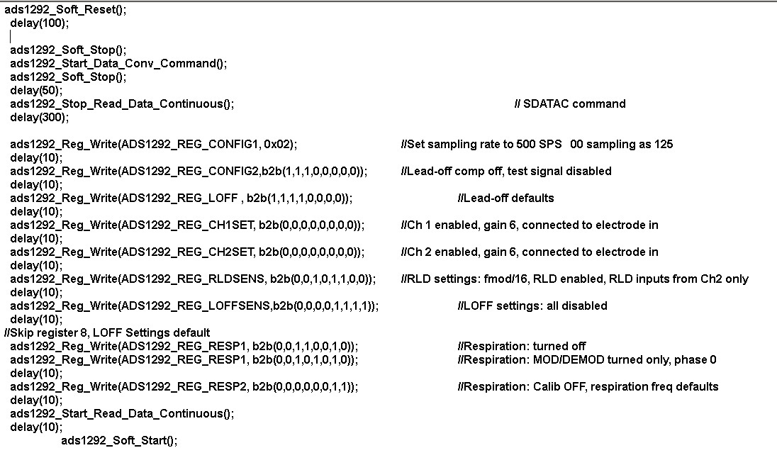

I am using ADS1292R and sampling at 500sps and with the register settings as per attached file.
Our final schematic.
Register settings are also attached.

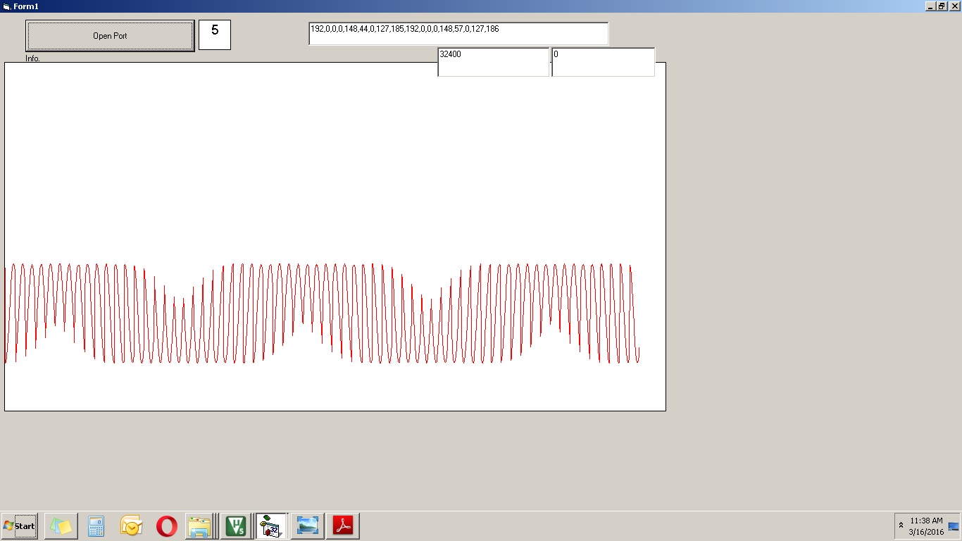

Now I am facing a very strange problem.

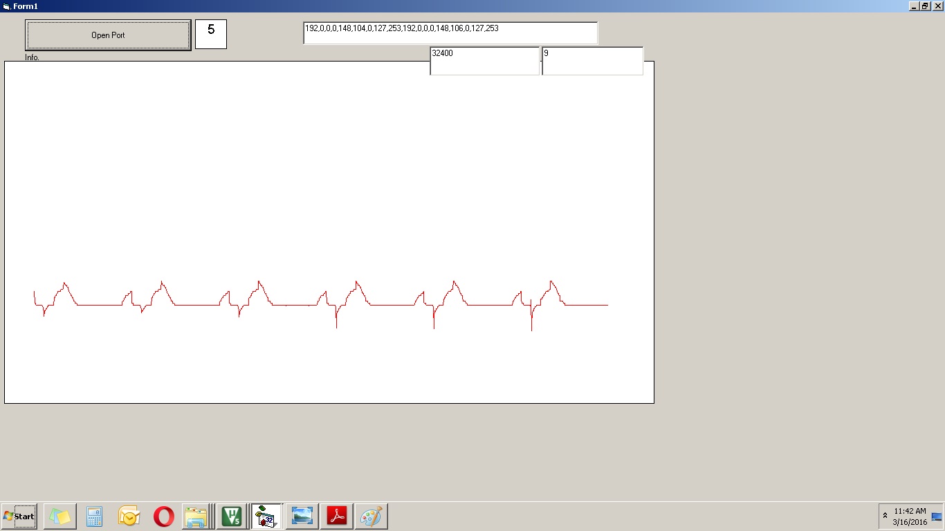

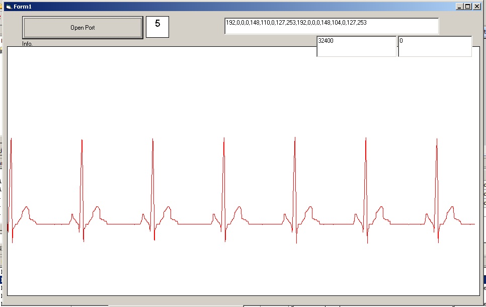

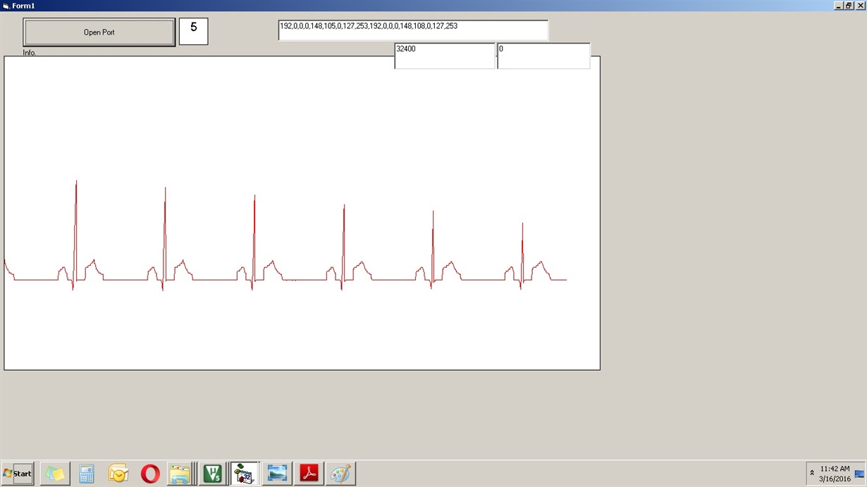

 Also when I connect ECG Simulator, the QRS waves slowly starts to decrease in amplitude then disappears and reappears after few seconds.
 I have switched off the respiration modulator and demodulator. Also I have checked the signal source and simulator for any faults and everything is proper.
 Is there something I am missing?  I feel this is due to some aliasing effect. Can you suggest some changes?
