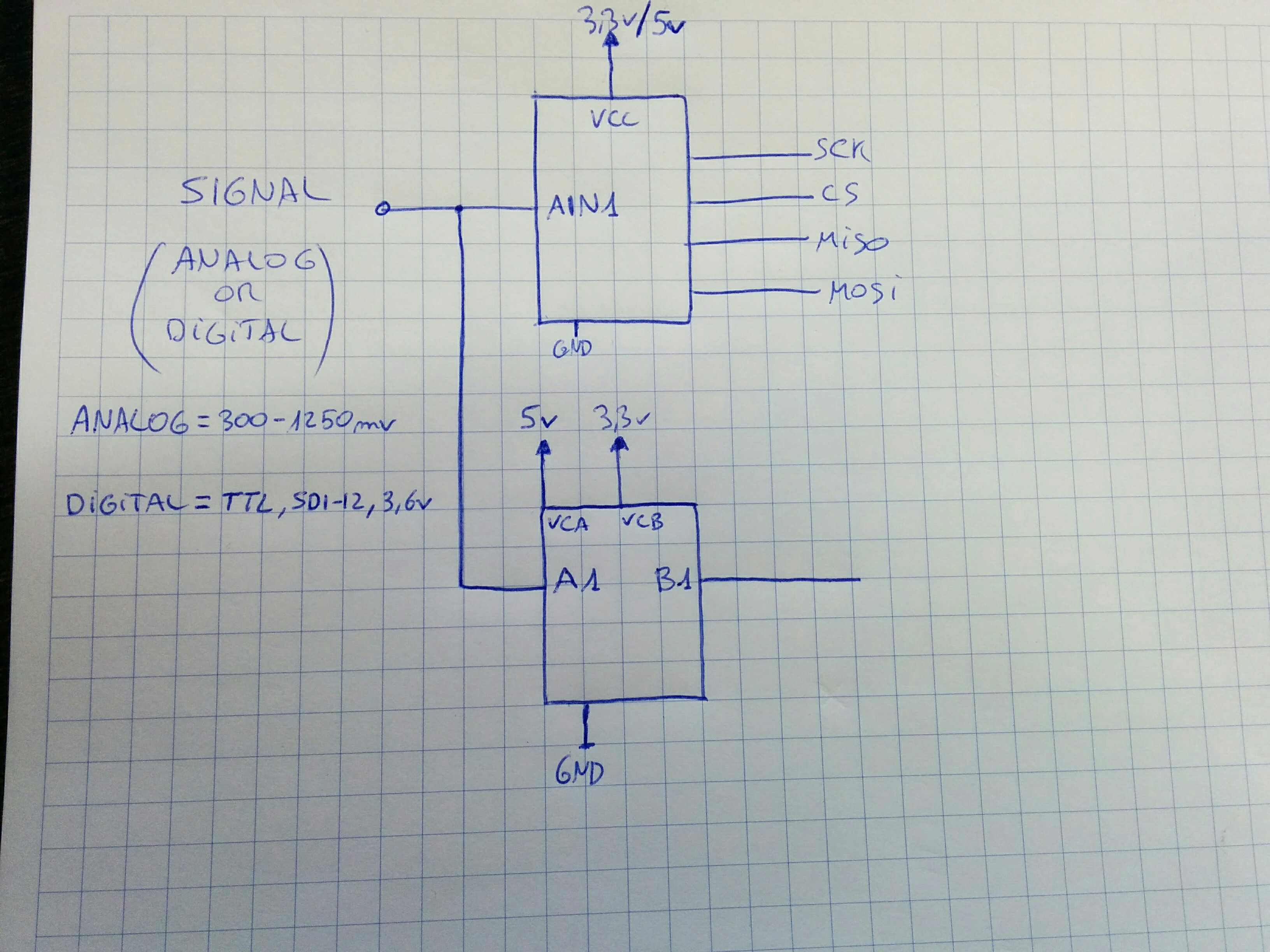

Hi, I have a question about if its good to connect together the same signal from AIN1 / AIN2 / AIN3 to A1 / A2 from a level converter SN74LVC2T45DCTR.
This is beacause in my device its posible to have both analog and digital signal. So I have to connect the same pins together ( AIN1 to A1 and AIN2 to A2 ).
Can I do this directly or I have to put some protections.
Thanks!

    Thank you for your inquiry. Can you please elaborate on what you are trying to do here?
    Do you mean a connection from 1) A1 to both, AIN1 and AIN3, and 2) A2 to both, AIN2 and AIN4
    OR
    Do you mean you are measuring SIGNAL X going to A1 of the level converter SN74LVC2T45DCTR and the same SIGNAL X goes to AIN1 of the ADC. In other words, are you measuring the analog part of the signal with the ADC and the digital part goes through the SN74LVC2T45DCTR?

  • Hello Krunal, thank you for the quick reply.
    I mean your second explanation. I measuring a Signal X that I don't know what type is. It could be analog or digital. So I have to put this Signal X to A1 of SN74LVC2T45DCTR and the same time, Signal X goes to AIN1 of the ADC.
    Analog signal could be from 300-1250mv
    Digital signal could be TTL, SDI-12, or 3.6v level
    I send a photo to see it clear:

    Thank you for the follow up. I just have few comments:
    Just a word of caution, I see that the input voltage to the ADC can go as high as 3.6 V whereas the analog supply to ADC is 3.3 V. This is right on the edge of the absolute maximum rating specification for the input voltage range. I would recommend to keep VIN <= VCC at all times. This could also be useful to prevent any excessive current through the ADC's internal ESD protection diodes.
    I would also recommend using an anti-aliasing filter (a single-order RC) at the input of the ADC to attenuate high-frequency noise to the ADC.

  • Hellor Krunal, I take into account the voltage. This is why I put 5v as alternative voltage.
    But, what I mean is if I can put this Signal X to A1 of SN74LVC2T45DCTR and the same Signal X goes to AIN1 of the ADC.
    Is a good connection, or there is a better solution?

  • Hello user4640884,
    You should be good with this solution.
