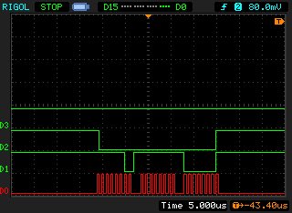

I supplied digital Vdd pin of ADS1256 with +5v dc accidentally. That was my first run. Now i am sending SYNC, WAKEUP and RDATA commands. Logic analyzer screenshot is attached.
D0: SCK
D1: MOSI
D2: MISO
D3: DRDY
I did not monitor chip select pin but it works fine. Do you think my chip is burned out ?

    The Absolute Maximum Ratings table in the ADS1256 datasheet specifies 3.6V as the maximum DVDD voltage. Above that limit, it is very possible to cause permanent damage, which could mean either degraded performance or loss of function.
    From the oscilloscope screenshot, I see that the MISO pin is toggling, which shows that there is some functionality.
    The MOSI appears to be sending 0x03 0xFF 0xFE, which would correspond to RDATAC, WAKEUP and RESET. During these commands the MISO pin will not send any data. Does reading data return valid results?

    I am interpreting my logic analyzer data as follows
    1st byte : 1111 1100 (0xFC) SYNC command
    2nd byte: 1111 1111 (0xFF) WAKEUP command
    3rd byte: 0000 0001 (0x01) RDATA command
    am i wrong?

    Sorry, I got the signals mixed up; you're right about the SPI commands. For the SYNC, WAKEUP, and RDATA commands...
    • Make sure the t11 delay time is included between the SYNC and WAKEUP commands.
    • Also the RDATA command should be issued after /DRDY goes low, and should be followed by three NOP commands  (0x00 - same as WAKEUP), to clock out the data.

    I have 7.68 MHz oscillator frequency. So i have 0.1302083 micro seconds master clock period. I calculate t6 delay as 6.51 micro seconds and t11 dealy as 0.52-3.12 microseconds for 4 and 24 tCLKN respectively. I put 10 micro seconds delays between commands. DRDY pin of my chip does not go low. I don't have any hope but can you check my loop for future works? Here is my code.I am using arduino due.

    The only thing that I would change is the delay time after the WAKEUP command. The ADS1256 will require 210 us between synchronizing and when data is ready (refer to table 13 on page 20 of the ADS1256 datasheet).
