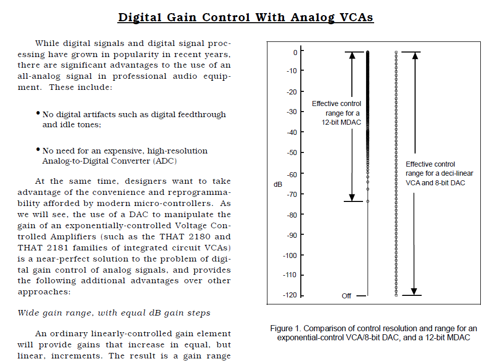

I am designing an audiometer and I am using a tone interrupter to create beeps in the tone. In order to do that I am using the THAT2181. It requires a DAC to control the attenuation/gain of the audio signal. The following are the requirements I need the DAC to have:
  • output voltage from 0 to 5V, the higher the resolution the better (at least 12-bit, 16 or more if possible).
  • Very high precision
  • Simple circuit implementation (not too many external components for operation)
  • EMI immunity if possible
  • SPI or I2C interface
  • check the desing reccomendatio below
Thank you
  • Hi Jake,
    For this signal attenuation we use a DAC architecture called "Multiplying DACs". A great example would be the DAC8812. This DAC is a 16-bit dual channel MDAC, and it features separate reference inputs so you can attenuate two separate signals of desired. This DAC requires a few external components, you check out this TI Design for help with the design. This particular design does not emphasize the feature of using the reference as a sinusoidal, but the design should still be up to the task, since it is so flexible.
    I have a question in order to be able to provide more insight into the best design type, what is the amplitude and DC bias of the input reference signal? This will determine the number of components needed for this build.
  • I'm not using the DAC to attenuate the signal. I'm using the DAC to control the voltage to a chip that will attenuate the signal more precise than any DAC could. Are there any DACs that are preferred for precise voltage control, are immune to EMI, and have less external component complexity? See below for why the DAC is not a good enough to be a signal attenuator for my needs:
