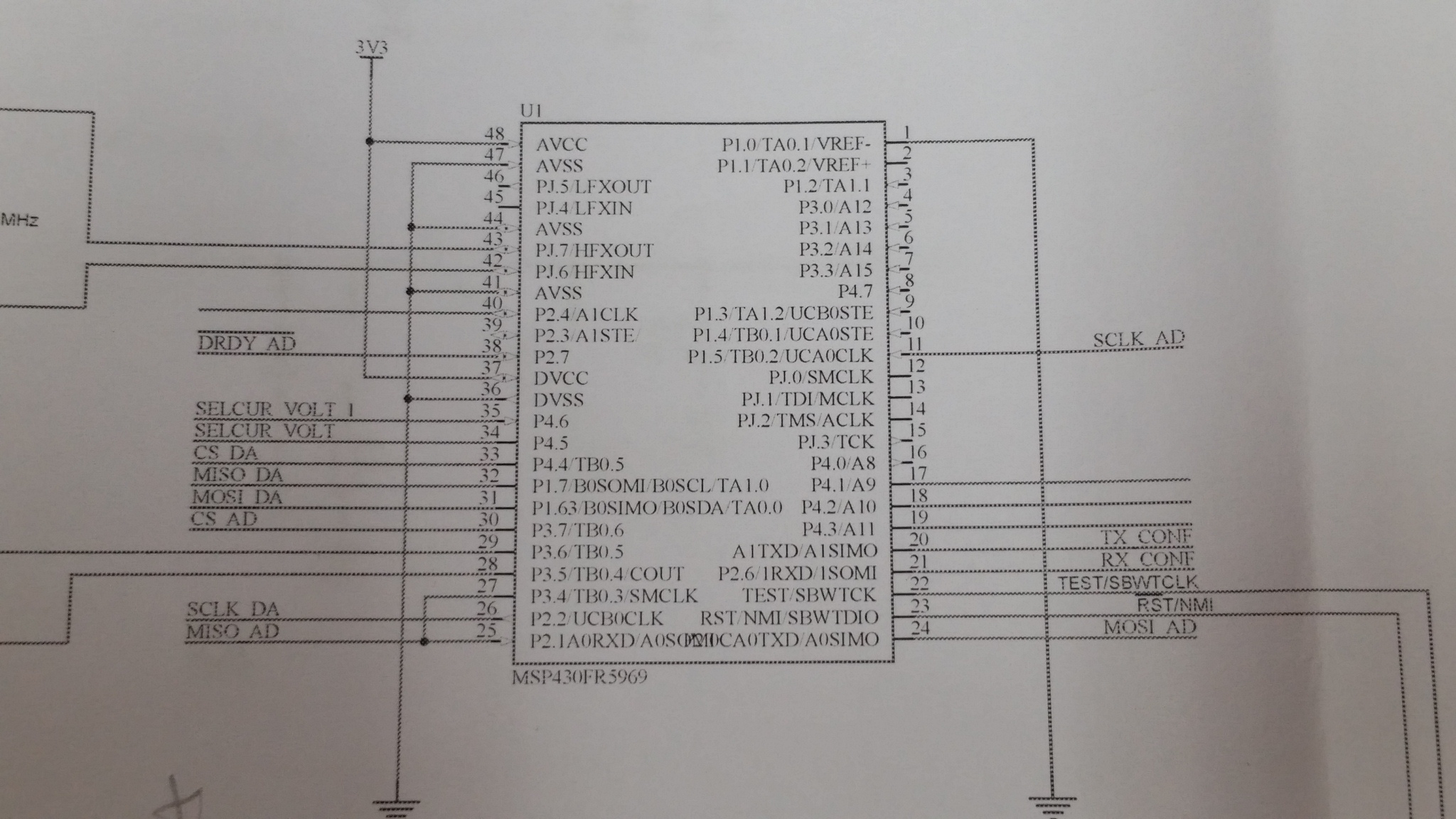

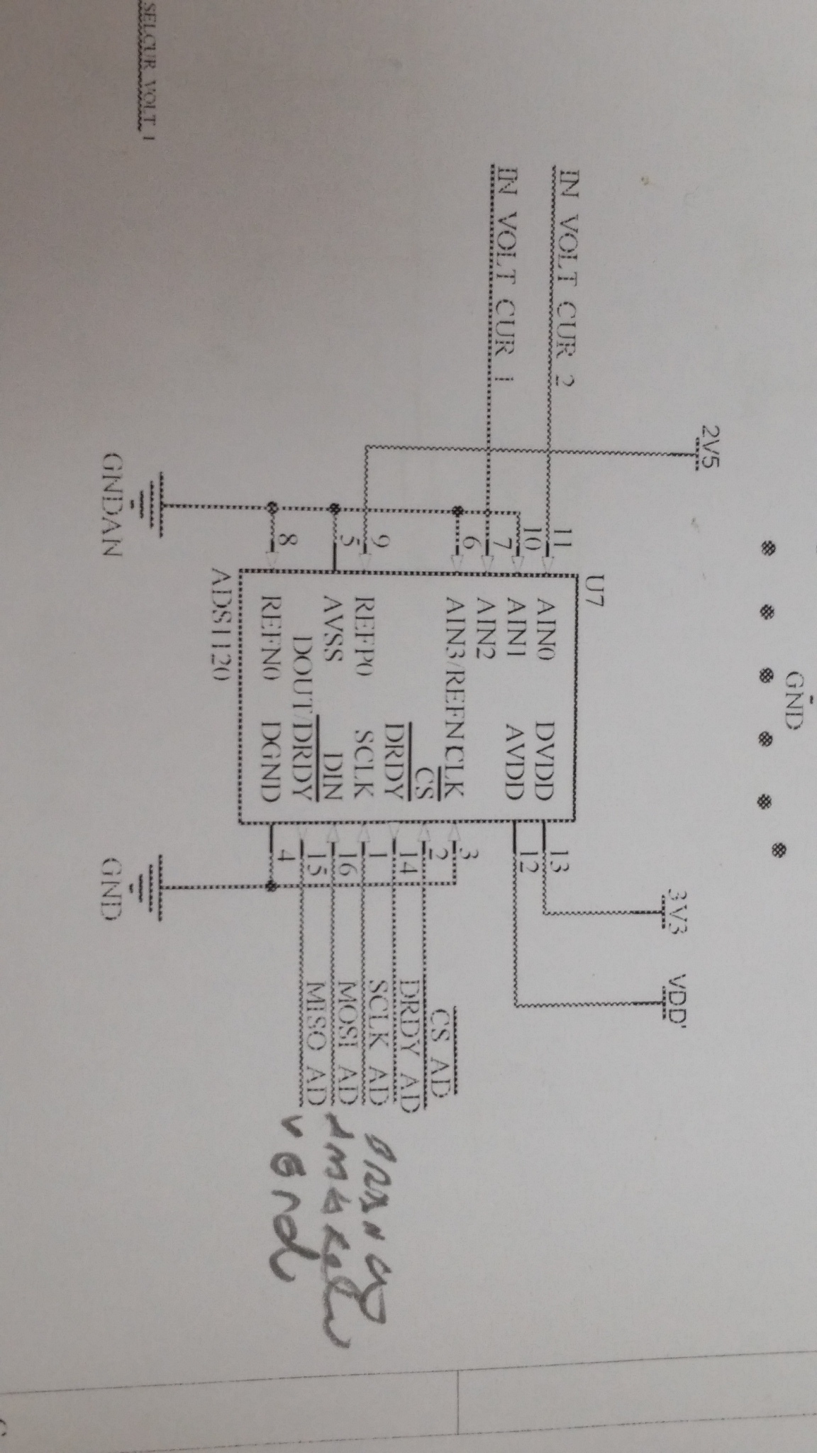

Hi there,
I am using ADS1120 with internal clock, external reference (REFP0/REFN0) to convert an unipolar signal between AIN0 and AVSS, gain 1, bypass mode, continuous conversion, giving me the configuration values of: 0x81 0x04 0x40 0x00.
I can write those bytes and check the SPI signal on oscilloscope. Also, I can double check the write by reading the registers from ADS1120 with RREG.
After the start conversion command, though, no change occurs with the DRDY signal (always high) indicating no conversion was performed...
Extra information:
1-using a msp430fr5969 to interface with ads1120;
2-following the sequence from datasheet: reset adc, delay, write registers, etc;
3-tried single shot mode and same happens.
Any clue about it?
Thanks in advance,
Alex

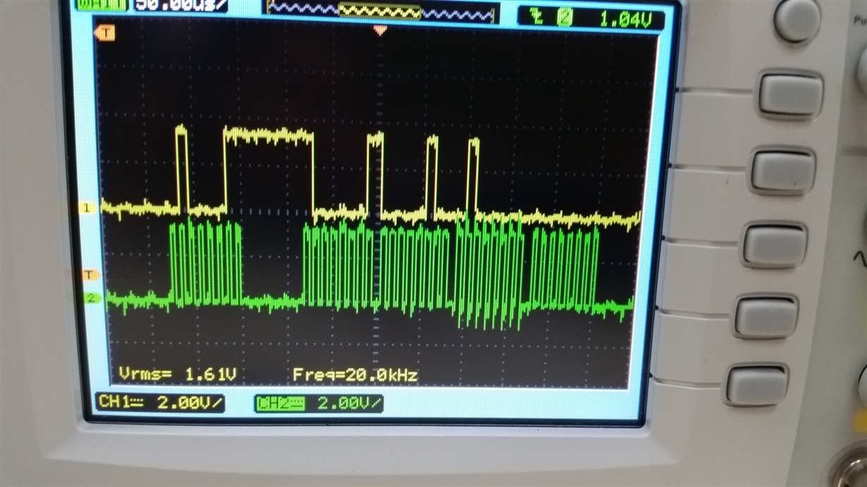

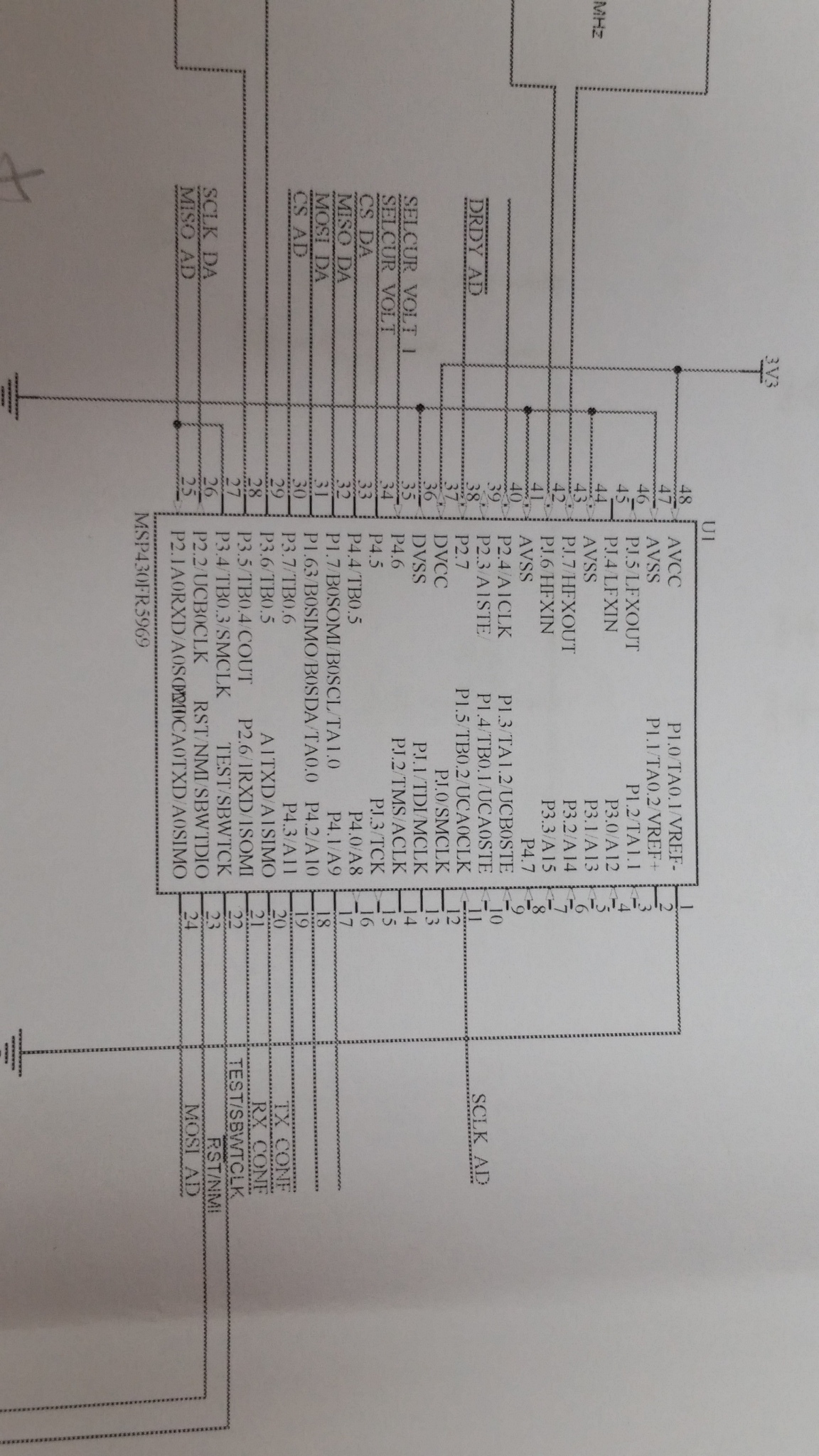

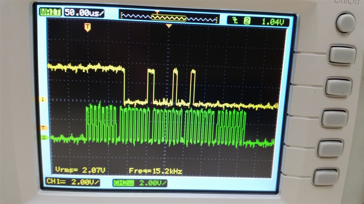

    I'm attaching the pictures from SPI MOSI and MISO. Also the schematic. (soory about the extremely high resolution, by the way...)

  • Hi Alex,
    Thanks for the info.  I may have not been clear about sending the START command.  Did you try sending the START command after DRDY goes low, or right after power up?  I was wanting to know if START was issued after the device returned to the power down state whether or not the device woke up and started a conversion.  I'm also curious if there could be an issue after the RESET command is sent, which is why I want to go back to the beginning and see if we can get something to work early on.
    I must say that this is very puzzling.  What is the AVDD supply voltage?  How is it derived?  Is there a connection between AGND and DGND?  If there is a voltage difference between the AVSS and DGND on the ADS1120 there may be an issue where the control signals are not getting properly passed between the analog and digital portions of the device.
    Do you have a voltage applied to the analog inputs to the ADS1120?  If so, you might try disconnecting the inputs to see if there is any issue related to the input voltage.
    Bob B

  • Hi Bob, good news!
    I transfered the ADS1120 to a simpler circuit and it works (basically with the same firmware). Thus, I assumed the problem was in my initial board. Looking carefully, I realized the DRDY was shorten with 3V3, not in the ADS1120 but near the MSP430 where the input pin for DRDY was right after the DVCC (you can see on the schematic I sent you before).
    Anyway, thank you very much for the suggestions and precious time.
    Alex
