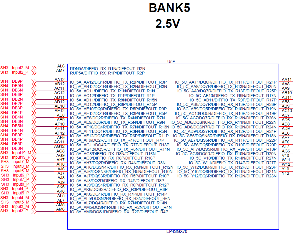

    my plan is to use the the 2xWire 16 bits serialization, as I understood this would mean I would have a bit clock of x4 the Sampling Clock.
    What about the Voltage level of the LVDS Interface? If i get it right, the LVDS Outputs are supplied by 1.8V, and they have a VCM (typical) of 1.2V.
    Would it work if the output lanes of the ADS5263 are connected with FPGA pins supplied with 2.5V insted of 1.8V?
  • Hello Giulio,
    How are you?
    Here is the LVDS output spec from ADS5263 data sheet:
    Please take a look:
    Very similar to what you mentioned.
    If you have a copy of the TSW1400 schematics, then please take a look at its page 3 and page 12.
    You can see how ADS5263 EVM digital output pins are connected to TSW1400 capture board.
    Here are some examples from TSW1400 schematics:
    (You can compare them to the ADS5263 EVM schematics from the User's Guide).
    Thanks and best regards,
    Chen

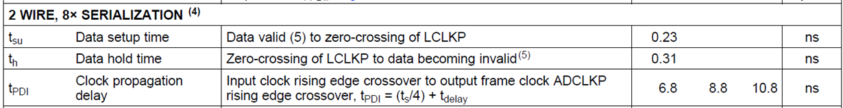

    1) On page 12 of the ADS5263 Datasheet I see the minimum (6.8 ns), typical (8.8ns) and maximum (10.8 ns) values of the Clock Propagation Delay (Tpdi) for 2 wire, 8x Serialization mode. On the next page this values are referred only to the Tdelay Parameter. This means that for correct calculation should I add to the upper values the Ts/4 or not?

  • Hi Giulio,
    For your 1) question:
    Since you may use 2 wire, 8x serialization mode for ADS5263 device.
    Then the propagation delay Tpdi is listed on the ADS5263 data sheet page 12:
    Tpdi = (ts/4) + tdelay
    and tdelay (min=6.8ns, typical=8.8ns, max=10.8ns)
    Assume we are running Clock fs at 50MHz, then ts=1/50Mhz=20ns
    and if the tdelay is = typical 8.8ns, then Tpdi = (ts/4) + tdelay = (20/4) + 8.8 = 13.8ns
