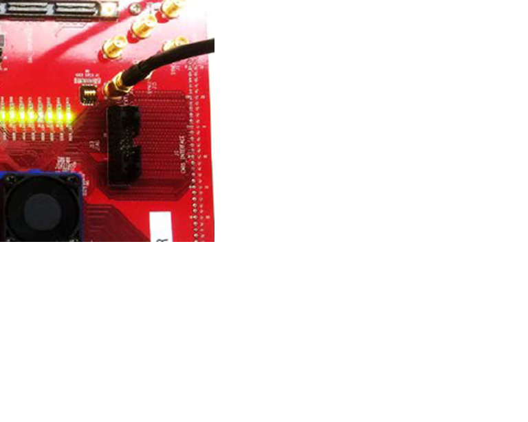

    I have one more query, I connect an external trigger from my laser source(J11). The trigger signal is a negative pulse trigger with duration of 5ns and signal level of 4V.
    The board only acquires the correct signal once in 30 times trail, rest of the time it just getting some unwanted data. (I think there is a not a stable capturing of the trigger signal or am I missing something).

  • Dear Chen,
    It was J11 pin (EXT_TRG_INPUT) in TSW1400 board.
    I'm sorry that I didn't mention it properly.
    I connect the trigger signal from my laser source to this pin in TSW1400. The AFE5808 collect the signal from eight channel and transfers it to the TSW1400 via the P10(AFE5808).
    Prsna

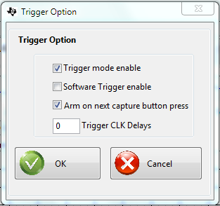

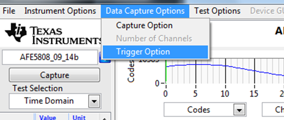

  • Hello Prsna,
    When you connect your trigger signal to TSW1400 board pin J11,
    you also need to do the following on TSW1400 GUI:
    1) connect your cable to J11.
    2) select TSW1400 GUI
    3) check the following two options:
    Check "Trigger mode enable"
    Check "Arm on next capture button press"
    Then after these changes, please run "Capture" from TSW1400 GUI again.
    And please observe the captured data after running "Capture" button.
    Thanks and best regards,
    Chen
  • Dear Chen,
    I did followed the 'high speed data converter pro GUI' user guide(section 3.1.3.3) and used the same setting before.
    It acquires the correct signal once in many number of trail.
    Prsna
  • Prsna, 5ns is too small. I have trouble with anything less than about 125ns pulse. Can you try this with any other trigger source or lengthen your pulse? I think you mean the pulse is 4V and then goes to 0V for 5ns, right? Can your trigger source also take an input? The TSW1400 could be the master source and then trigger your laser source. Would that work?
  • Dear CSmyth,
    Yes you are right my signal goes from 4V to 0V.
    I can make LED as my trigger source and lengthen the pulse (I will try this, if this ain't working I can make TSW1400 as the master source).
    Will let you know soon.
    Prsna
