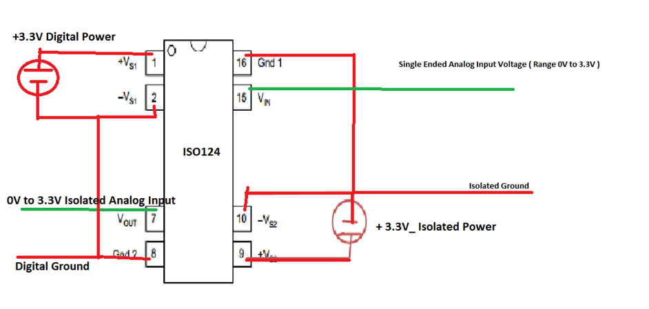

    I don't have the bipolar supply option in my board. I have  Isoated +3.3V supply. Is it possible to operate the ISO124 , if i connect the Ground terminal ( 0V potential ) of my Isolated power supply to the -VS1 pin of the ISO124?.
    Below is my reference circuit. Will it work with single ended supply and single ended input?
    Best Regards
    Sharvy
  • Hi Sharvy,
    Unfortunately no, the ISO124 needs minimum +/-4.5V to operate properly.  The -VS1 rail cannot be tied to ground.
