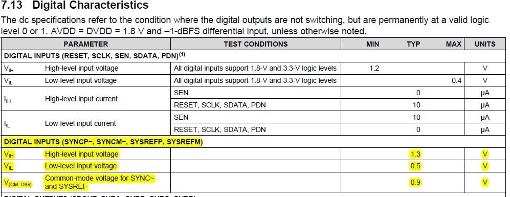

I would like to confirm the specification of SYNC pin of ADC34J44.
According to the datasheet, the VIH is 1.3V and VIL is 0.5V.
And it seems to be a single end level specification.
However the SYNC input is the differential.
How do I understand this specification?
Is the voltage from o,5V to1.3V the differential input voltage?

    The SYNC input spec needs to be updated to have a more meaningful spec for input high and low. It is currently spec'd as a single ended level and should be spec differential. The typical specification for SYNC and SYSREF should be common mode of 0.9V with a +/-400mV swing. The differential voltage should be +400mV for a high and -400mV for a logic low.
    We have used LVDS signaling and it works fine. . You can use any of our LVDS or LVPECL buffers such as CDCLVP1102 or others in that family to buffer LVCMOS to LVDS/LVPECL.
    Ken.

    1. Is there the minimum value of Vid (differential input voltage) of SYNC pins because the LVDS Vod is 350mV(typ)?

    1. There is no min or max spec on this differential swing at this point.  We will gather data and put that into the next data sheet release.  The input circuits will look for some differential voltage to switch either logic low or logic high.  I do not anticipate any issues with 350mVpp differential swing.
