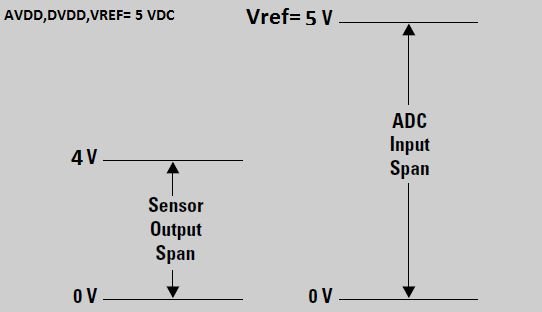

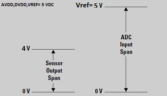

    I am re-opening this thread again. We have started the design with ADC. I need some clarity on the below topic.
    Lets assume,
    • ADC will be having AVDD,DVDD & VREF with +5 VDC power .
    • If we have a sensor analog output voltage ( Input to ADC ) of 0-4V
    My Queries are given below,
    1. Can I apply this kind of variation in the input voltage span?
    2. Will there be any issue in the performance of ADC?
    3. Will that input captured properly by ADC ?
    4. What are the best method to provide give VREF voltage to ADC? Can I use Zener Diode for the Vref?
    Best Regards
    Sharvy
  • Hi Sharvy,
    yes, you can operate the ADS1220 with AVDD=DVDD=VREF=5V to measure a 0-4V input signal. The only important thing will be to bypass the PGA in that case (set bit PGA_BYPASS=1).
    This is a valid configuration of the ADS1220, therefore I do not expect any performance degradation and the 0-4V signal will be captured properly.
    As we are talking about a high resolution ADC, it would be recommended to use a precision voltage reference. For example a REF5050 or something similar.
    A Zener diode should work as well, but as the Zener voltage might have quite some variation you will probably see a large gain error.
  • Dear Joachim,
    Thanks for the feedback.
    Lets talk about the below scenario.
    If I am feeding VREF=AVDD=DVDD= 5V from the same power supply rail and restrict the Analog input voltage swing to 0-4V. There is a 1V margin ( 20%
    tolerance variation ) between the Analog input voltage span ( 0 to 4V) and the ADC input acceptance span ( Vref =5V ).
    1. If there is a 20% tolerance variation in the Vref supply. It cannot alter our Analog input's capturing and performance of the ADC. What s your thought on  this? correct me if I am wrong.
    2. Can I avoid the VREF special IC and Zener diode from my circuit, if I am going for the above scenario? since we are looking for a low cost solution.
    Best Regards
    Sharvy
  • Hi Sharvy,
    as long as your input signal is smaller than the reference voltage you are using (assuming you use Gain=1 and bypass the PGA) you will be able to somehow capture the 0-4V input signal.
    However, please remember that the ADC outputs a code which is proportional to the ratio between VIN/VREF. Means if your VREF changes by 20%, you will have a 20% measurement error in your system. That is why it is extremely important to have a very stable and low noise reference source. I can therefore not recommend to use a supply with a 20% variation as the reference source.
    In the beginning you mentioned you are looking for 20bit resolution. If you target such high resolution numbers you will have to spend money for a proper voltage reference (or at least a good LDO that you can use as a reference). Your measurement will only be as good as your reference is.
