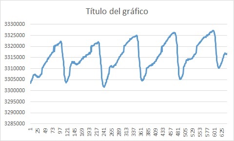

I have my own board with afe4400 connected with a sfh7050 sensor to read pulse and oxigen. At this moment I use sensor with my finger and all works, the signal and values of my pulse are correct.
This is a graphic with all values that it reads on my finger:
The problem is when I read values on my wrist. The aplication can´t detect pulse correctly.
This are the register that I use.

  • Hello Javier,
    For reflective plethysmography especially on the wrist, the quality of PPG signal is dependent on, but not limited to, numerous factors like the mechanical design (Ambient light interference), the skin tone/pigmentation level, the hirsuteness of the test subject, the position of the arteries w.r.t to the sensor placement etc.
    Please follow the test setup guidelines mentioned in section 2.4 of the AFE4404 Users guide.
    The timing register settings look fine. Can you also ensure that the LED current and TIA gain settings are not too high that the TIA output is getting saturated?
