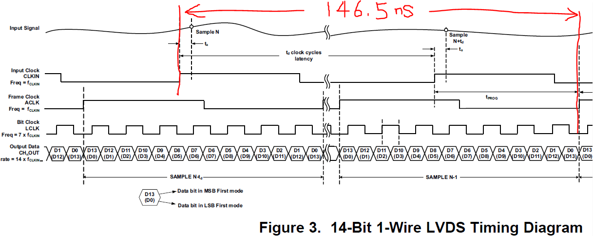

(1) For the ADS5294, the data sheet latency states 11 sample clocks (see 8.7). However, it can't be determined from the information if this latency includes the time taken to serially transfer the data out of the device. I.e., there is a high-speed bit clock that transmits all bits within a sample clock interval (1 wire DDR mode). Is this clock interval included in the 11 number; or with the transfer included should I use 12?

  • Hi Bob,
    Thanks for using ADS5294 device.
    Let's assume you are running ADS5294 at 80MSPS (12.5 per period) input clock speed
    and you set 14bit 1-wire LVDS mode.
    Please look at the ADS5294 Data Sheet diagram:
    When ADS5294 captures an analog input signal "Sample-N" starting at External Input Clock's rising edge,
    Internal ADS5294 circuitry needs to take time to do some processing inside ADS5294 device before it can send out digital output "Sample-N" signal from its LVDS output pins.
    It needs to take total time = td (11 clock cycles latency: 11 * 12.5ns) + tprog (around 9ns: 12th clock rising edge to Frame Clock rising edge) = around 146.5ns delay time
    Note: But this delay timing is not 12 clock cycles (12 * 12.5ns = 150ns) delay time.
    Please look at the following diagram:
