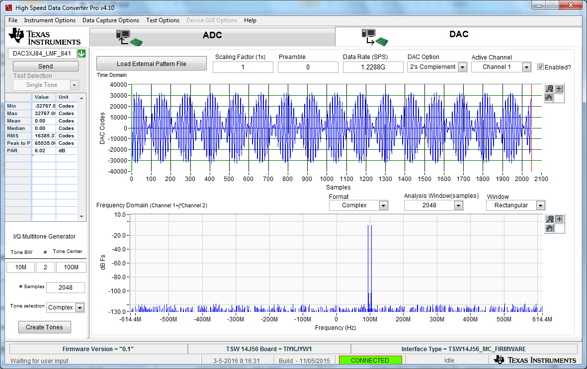

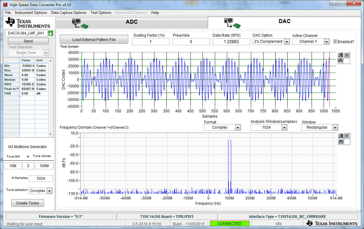

    In fact I have started working with these boards with a lower sampling rate, using the matlab dll libraries that you provide, and everything is working fine, except at the maximum sampling rate (1.2288 GSps). When I detected the problem, I have started doing tests directly with the HSDC I/Q tone Multitone generator, and I have detected that the output spectrum only makes sense with a #samples <= 1024. After concluding this, the same is also valid for the matlab case, i.e., if I send a signal with <= 1024 samples via matlab everything works.
    Additionally, I realize that changing the number of points produces changes in the resolution bandwidth, that also may change the tones frequencies. However, when using periodic signals, which was the case when I was using the matlab interface, if the signal is periodic with 1024 samples it is also periodic with 2048 and any multiple of it. Nonetheless, as you may see in the captures below I do not think the problem is related with the signal generation, either in matlab or in IQ multitone generator.

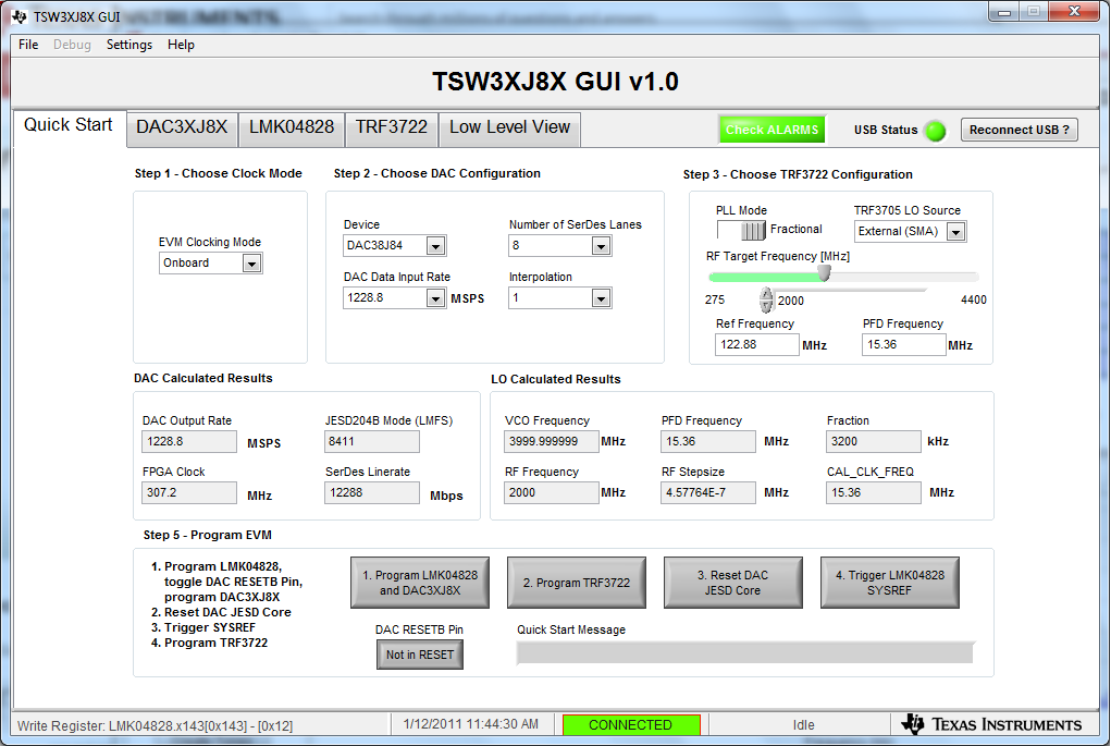

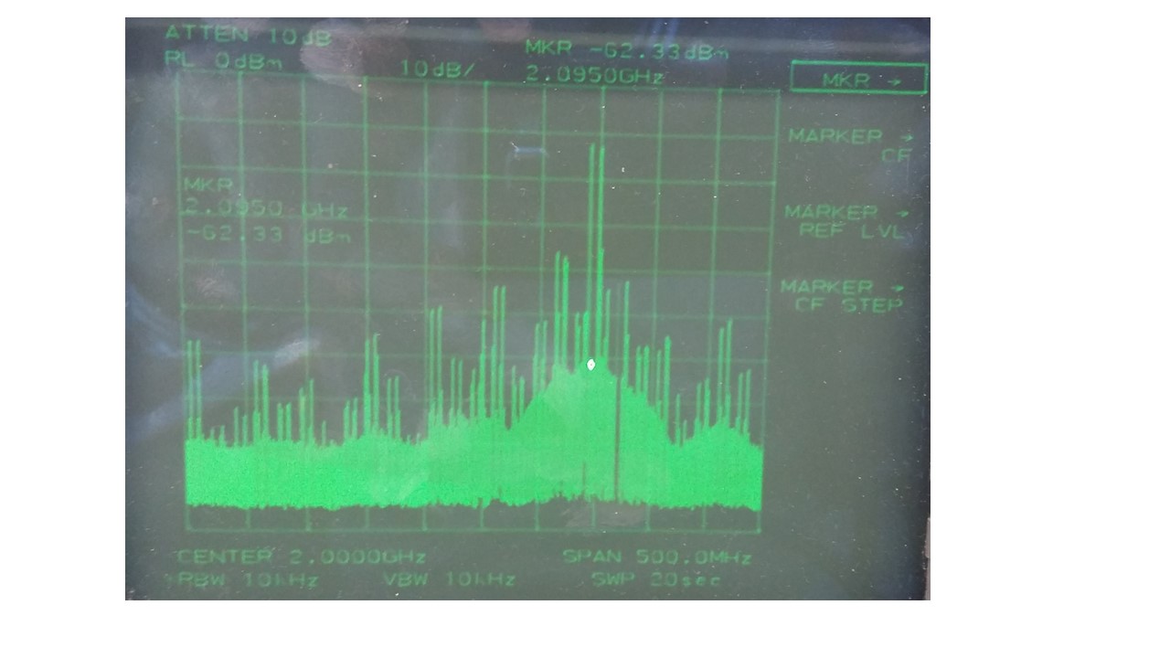

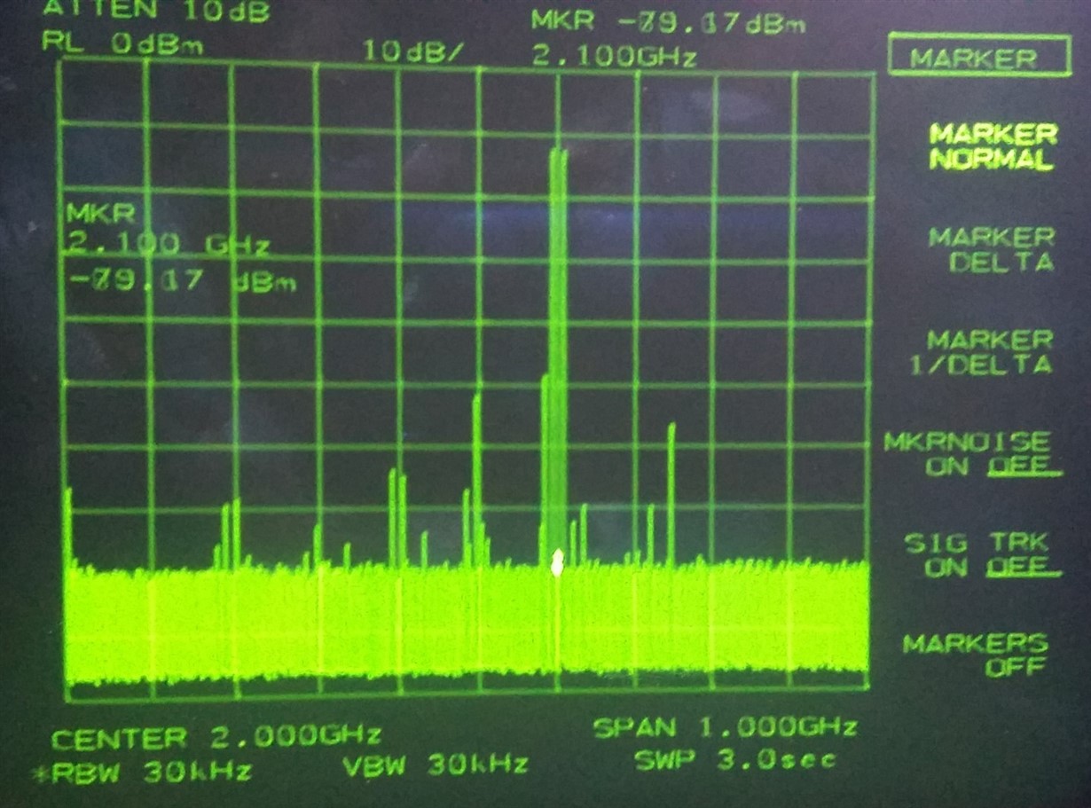

    As you requested, I send a capture of the DAC TSW38J84EVM configuration, and two pairs of captures of both HSDC with 1024 samples plus output spectrum, where the output is correct, and by last a capture of HSDC with 2048 samples plus a capture of the output spectrum. As you can see, the last one should not be like that.
     - TSW38J84EVM configuration

    However at 983.04MSps both the test with 1024 and 524288 passed but the test with 2048 samples failed (see Figure below, where the spectrum should be similar to the above correct case). The failure seems again that occasionally exist some wrong DAC samples (the wrong tones vary). This is presenting a behavior different that with the 1.2288Gsps case, where every number of points > 1024 failed. In this 983.04MSps case only the 2048 fail, which I think is strange.

    I just tried the case with 983.04M sampling rate, 1x interpolation with 1024, 2048, 4096 and all these cases look fine.  See attached.  I did have an issue if I tried to go to 512 or 256 - there was not enough samples to create a coherent 2 tone.
    Ken.

    Additionally, I noticed that I am using the GUI  v1.0 for the TSW38J84EVM revB configuration and  you are using the v1.1 of the GUI.
    Do you think that is important?
    Andre
  • Andre,
    Complex or real do not matter.
    If you are using a TSW38J84, then use that GUI (this has controls for the TRF3722 device). If you are using the DAC38J84EVM then use the DAC GUI. The DAC GUI slac644a.zip is the DAC38J84GUI v1.1
    Ken.
  • Hi Ken,
    I did not noticed that you were using the DAC38J84EVM. I am using a TSW38J84 revB and the TSW3XJ8X GUI v1.0, which I think it's ok.
