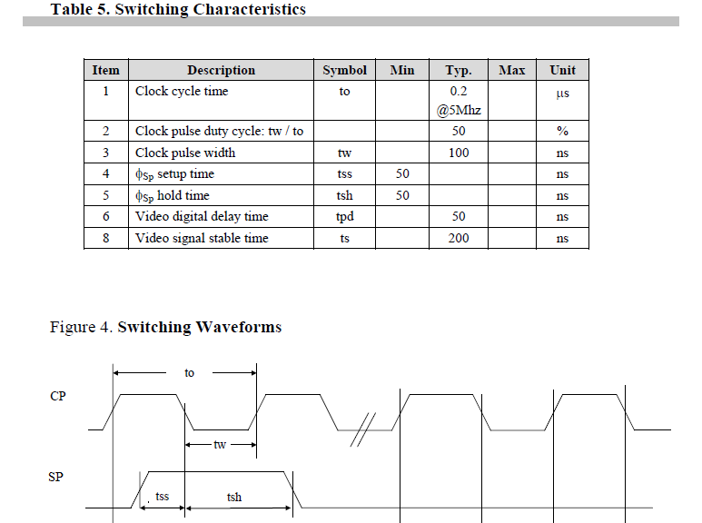

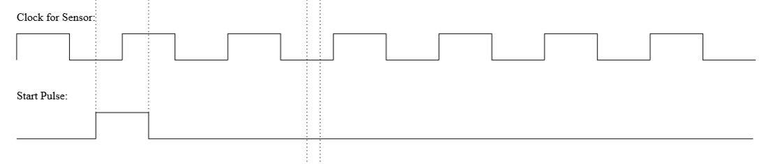

    CIS sensors like this one only require a single clock for the SP signal, once per line. CCD sensors can require much more complex Shift pulses (transferring charge from the pixel sensing array to the CCD transfer array). Sometimes the high resolution sensors even need different timing for different lines in their sequence. That is what the multiple SH interval feature is primarily intended for.
    For the CIS sensor you have, you just need to make the SP signal go high for 1 pixel period. So you probably will only have one SH interval with 1 or a few states. The SP signal will be programmed to be low during the line portion and high during a single pixel period in the SH interval.

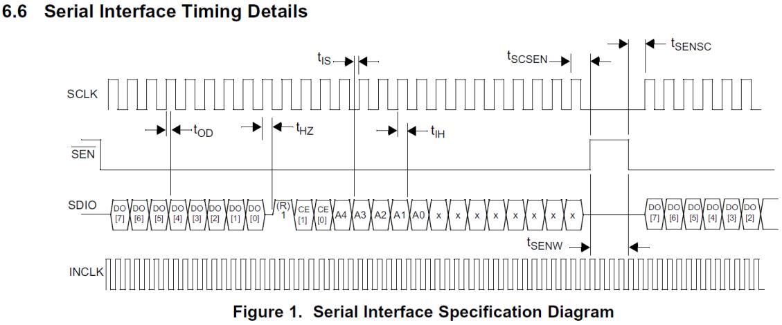

    Please also tell me how to do a serial interfacing to send data to ADC chip.
    The serial interface must comply with the sequence/timing shown in Figures 62-67. There are a few different possible modes of operation of the interface that should provide the needed flexibility to allow a wide range of control devices (ie. uC, uP, FPGA) to work with the LM98725.

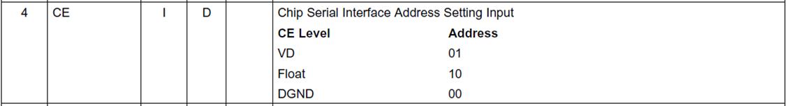

    There is a description about CE pin (chip enable) on page 84 should I connect it to the GND? The CE pin can be logic low (DGND), logic high (connected to VD) or left open circuit (floating). The state of this pin determines the values of the 2 CE bits in the address field of the serial interface timing diagram. This allows multiple LM98725 devices to share a common SPI bus if needed.
    Hooman

    I want to know about the voltages of SCLK and the SDI, my Arduino SCLK voltages are 4.7V and on SDI pins it sends data which high logic is upto 5V. Is there any voltages limit for the clock and SDI data like 3.3V or 5V is okay?
    As I'm using only one slave so I connect CE pin to the GND and send CE bits (00), its okay or should I left then unconnected and send bits (10) ?
    Maximum voltage limit for SH_R Pulse?
    How can I access different pages of registers, my Arduino sends 8 bits at once so I have choose to send 16 bits in two steps. First 8 then next 8.

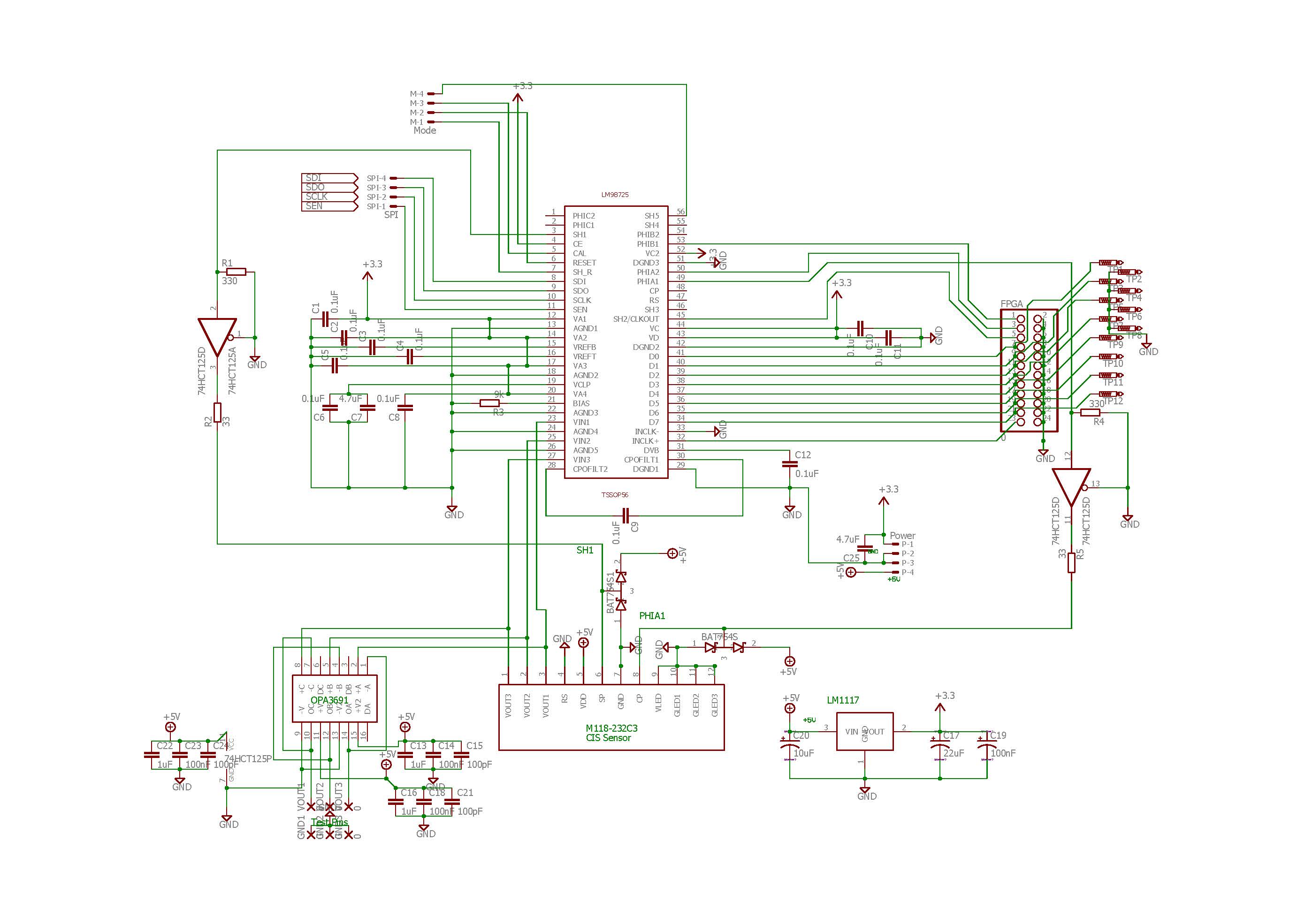

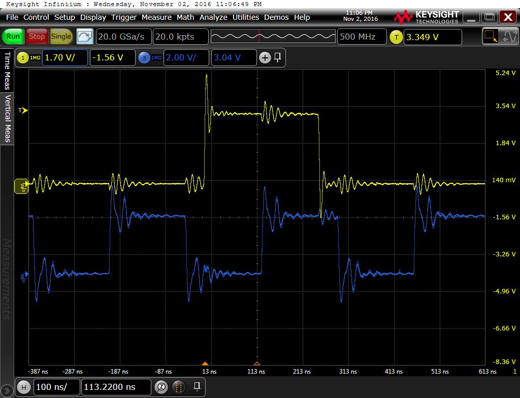

    I need to set the SH state length (0) to high for a short period (100ns) like in the picture I have attached. How can I configure registers 0-3 on page 7 for SH1 pixel on off. but there are 8

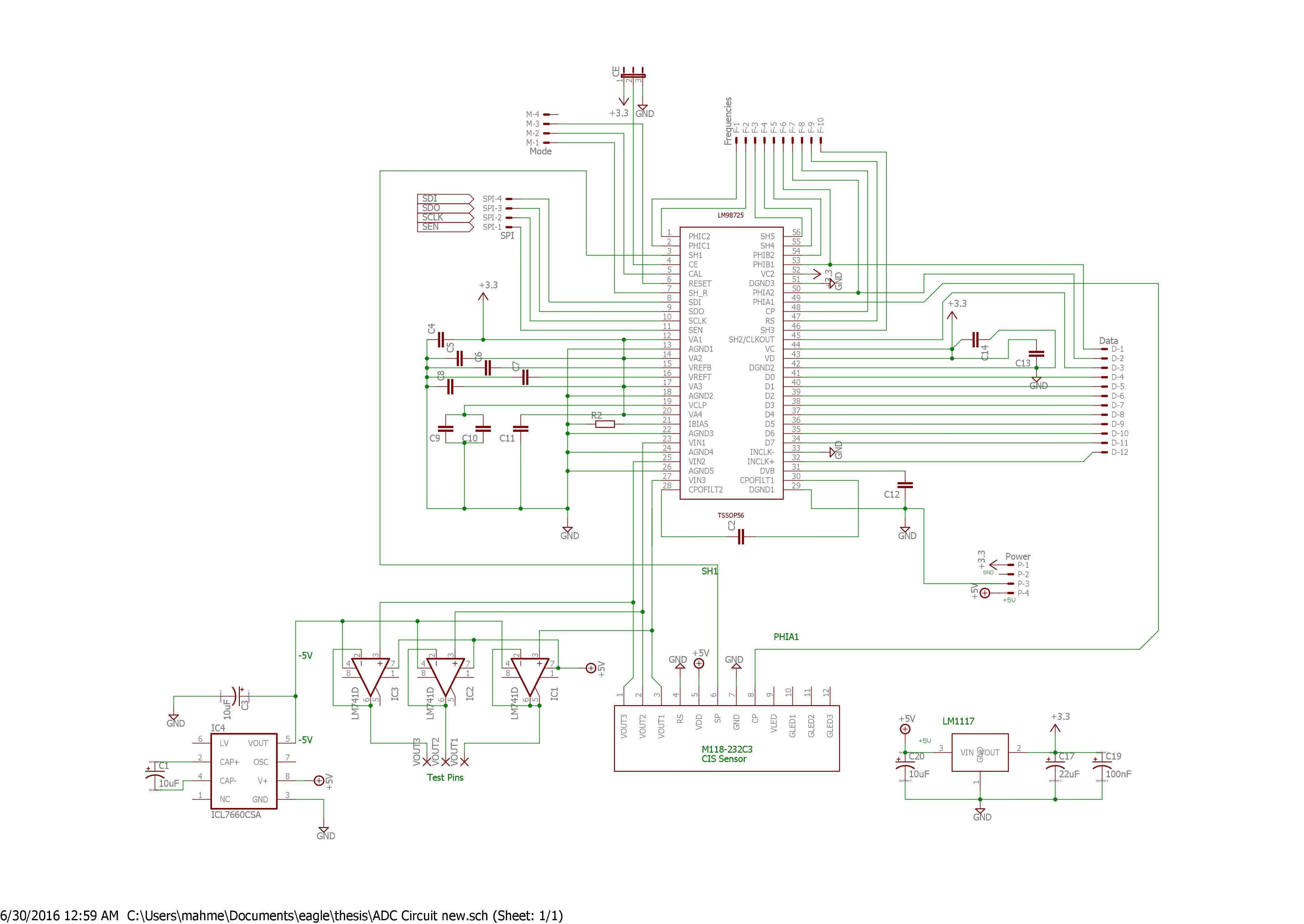

  • Hello Hooman,
    I'm waiting for your response. H ere is my circuit schematic for the circuit.

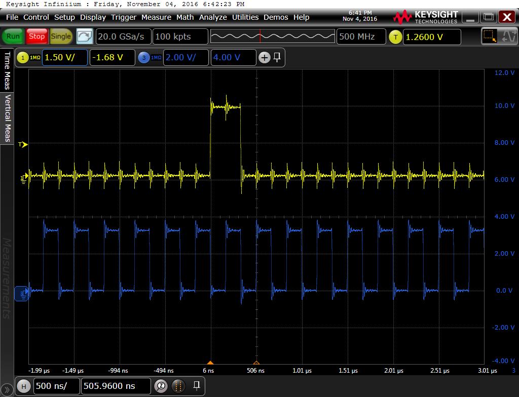

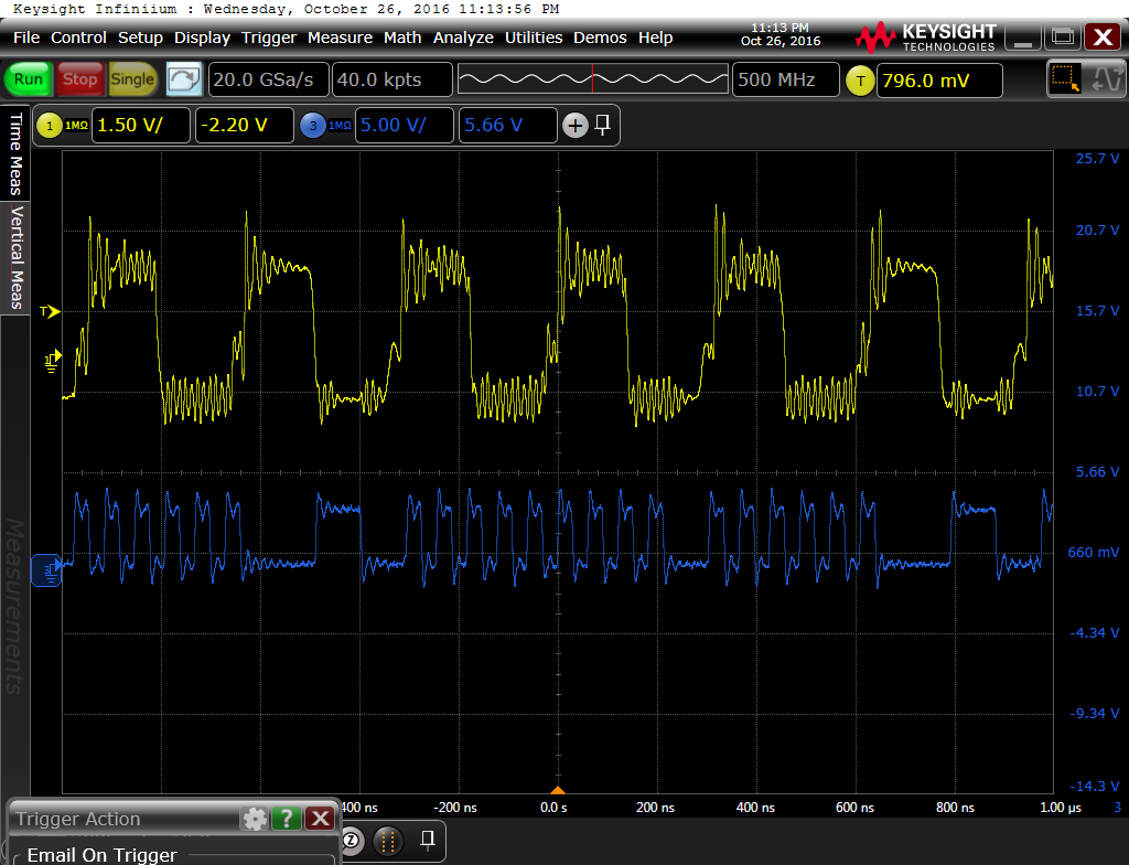

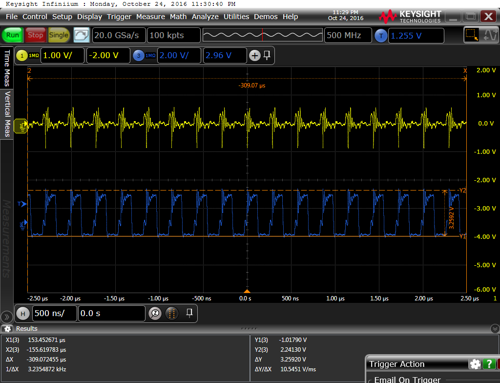

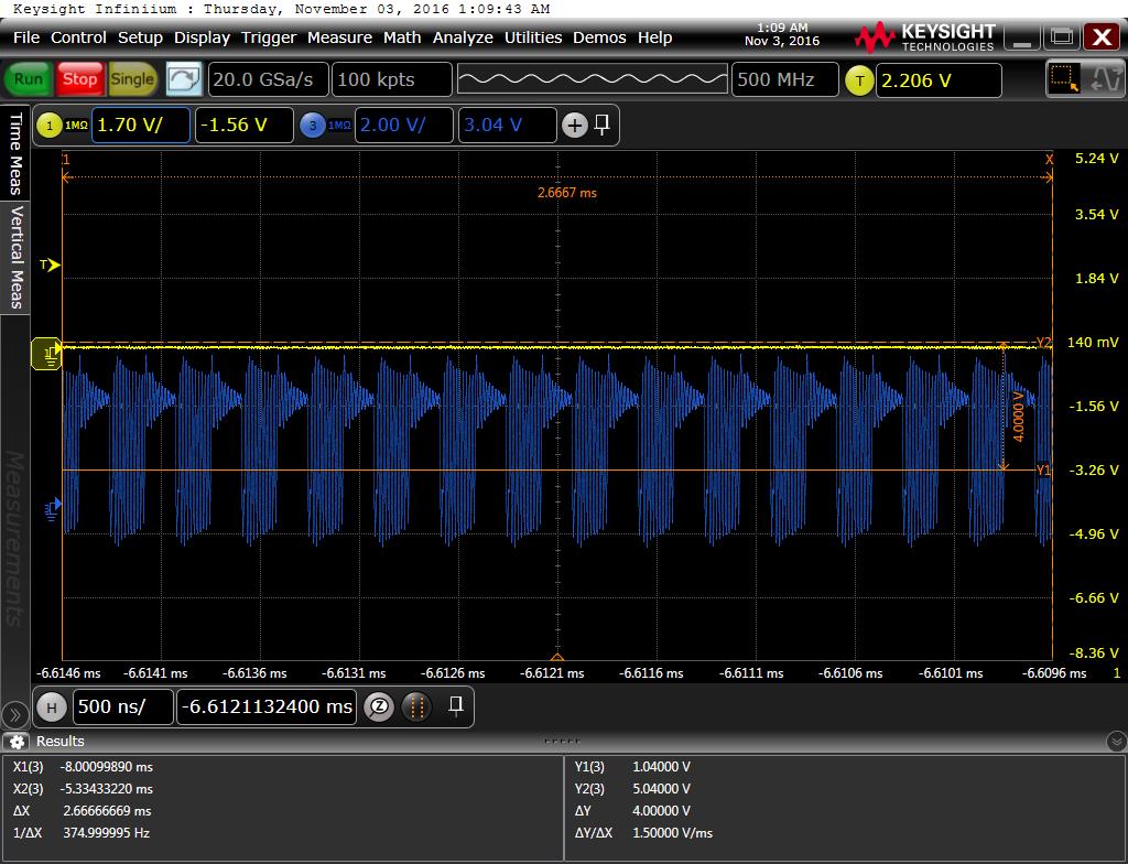

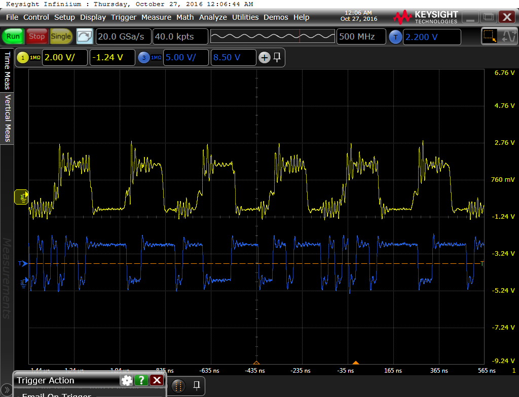

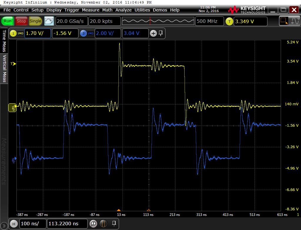

  • Here is the schematic of my PCB circuit, I have configured the registers but still didn't get any output frequency from the chip can you please where the problem could be?
    I need 5MHz output clock from PHIA1 and a SH1 interval with only one SH state.
    I'm sending you register configuration that I did, I used Arduino UNO to perform registers configuration via SPI.
    I used 16+ clock with 4 wires. CE pin is connedted to the VD (CE bits are 01 then)
    At first I send Dummy Bits to get 16 clocks and data values of last configured register and then the actual 16 bits.
    Please have a look on register values data below and let me know where the problem is as soon as possible.

    I used 16+ clock with 4 wires. CE pin is connedted to the VD (CE bits are 01)

  • Hello Hooman,
    In the datasheet on page 87, Figure 66 & 67 shows that the SDI pin is receiving the data commands before the 9th clock but in the description its written that master will take control of SDI pin after the falling edge of the 9th clock.
    Secondly I'm also not reading the correct data values of the registers after configuration, I have sent you the register data file and I have also read the register data on oscilloscope but there is one problem when I configure the register 0 on page 0 at the end to lock the register bit and PLL bit but the data I read showed that only register bit is locked and PLL still unlocked.
    I send 0hA3 (1010 0011) to lock the registers and PLL but I received 0h23 (0010 0011).
    Thank you.

  • This is the clock signal I'm getting from the chipm. Blue one is the INCLK 3MHz and Yellow is PHIA1

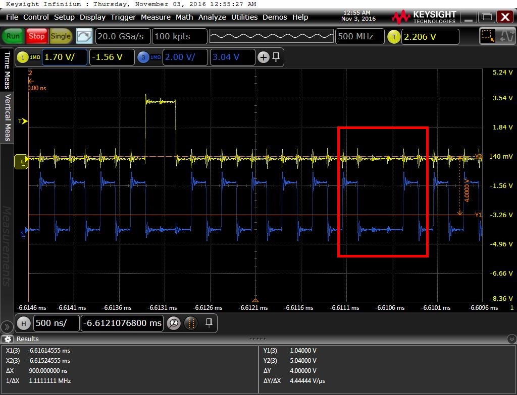

  • Hello Jim,
    I have attached an updated Registers configuration file, please have a look. Today I configured the registers with this sequence while +INCLK was applied continuously and I get some sort of clock pulses on the PHIA1 and PHIB1 but its not correct (see images below) because I have set the duty cycle to 50% but the wave form is random. Kindly guide me where is the problem in the registers data or in the circuit. I have also configured the SH1 but didn't get any output from this pin.
    One more thing I want to know that when I switch OFF the circuit and turn it ON again, all the registers data get erased and I have to configure all registers again. Is it normal?
    Yellow is the INCLK and Blue waveform is the PHIA1 and PHIA2.

  • When I read page 0 register 0 it shows that PLL is not locked, how can I solve this issue?
  • Hi Martin
    I'm trying to understand what is preventing the PLL Lock Detect bit from being set.
    I reviewed your schematic again and I wanted to confirm what logic level you are setting on the /RESET pin of the device. It is connected to M-3. Since this is active-low, this signal should be either floated to allow the built-in pull-up to hold it high, or driven to logic high from whatever it may be connected to. You shouldn't need to apply a RESET signal to the device but it is good to have it available in case it is needed for other debug purpose.
    To answer your earlier question, the register settings of the device are volatile. Every time the power is turned off the register values are cleared.
    Can you try applying a somewhat faster or slower INCLK signal to see if this has any effect on the PLL Lock bit? I did notice in your oscilloscope images that there is a lot of ringing on the rising edge of the INCLK signal. Is this due to a long ground lead on the oscilloscope probe, or does the signal at the INCLK input really have that much ringing? If the ringing is real that could cause problems. In that case it would be good to add some series termination at whatever is generating the INCLK signal. This will reduce the edge rate and the ringing.
    Please let me know the answers to these questions. I'll let you know if I think of any other issues that would prevent the PLL from locking.
    Jim B
  • Hello Jim,
    I think the ringing on the rising edge is may be because I'm using passive probes with the oscilloscope.  The /Reset pin status is floating, its just connect to a connector M but there is no logic on it because connector is open and not connected to another device.
    Today I have tried to run the chip on 2MHz frequency and when I read the register for PLL lock it shows me locked for a while and then again it showed unlock on the same frequency in two consecutive read commands in a loop (see the images). As you can see in the First image PLL lock and Registers lock bits are high (Bit 7 and Bit 0) but in the Second image PLL is LOW again and only Lock bit is high. This happens only once I don't know what causing the PLL lock bit 0.
  • Hi Jim,
    I have tried INCLK with different frequencies but same result PLL unlocked and output waveform is random.
    Any solution for the PLL locking? I'm waiting for your response.

    We'll next convert our setup to single ended clock (it is currently using LVDS differential clock) to see if we can recreate the PLL not lock that you are experiencing.
    I'll keep you posted as to what we find out.
    Hooman
  • Hi Hooman,
    Today I was working on the project and used 3MHz CMOS clock from FPGA, I notice an unusual condition for the PLL lock. When I start my FPGA and Lm98725 circuit for the first time the PLL don't get locked but if I restart my Lm98725 circuit only and not FPGA the PLL gets locked and generates output clock pulses. I don't know why is this happening, can you tell what could be the reason behind this saturation? I have attached both pictures of the clock pulses on the first start without PLL lock and after restart picture .
    Blue=output clock pulse
    Yellow=SH interval
    After restart
    My second question is why there's a delay in the clock pulse after the SH interval (Marked in RED).
  • Hi Hooman,
    Yellow=SH interval
    After restart

    I want to ask you that how can I configure the SH interval like its shown in the diagram. I'm using  SH1 to generate Start Pulse for the sensor but this stops the Clock Pulse. What could be the better solution for generating the Start Pulse withour affecting the clock pulse.  See the waveform diagrams that I need to generate SP and CP for the sensor.

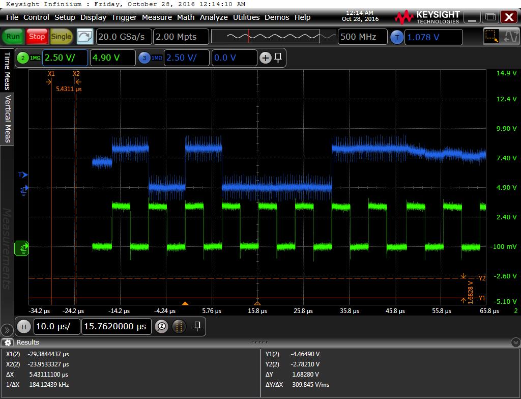

  • Today I used 3MHz CMOS clock, I notice an unusual condition for the PLL lock. When I start my FPGA and Lm98725 circuit for the first time the PLL don't get locked but if I restart my Lm98725 circuit only and not FPGA the PLL gets locked and generates output clock pulses. I don't know why is this happening, can you tell what could be the reason behind this saturation?

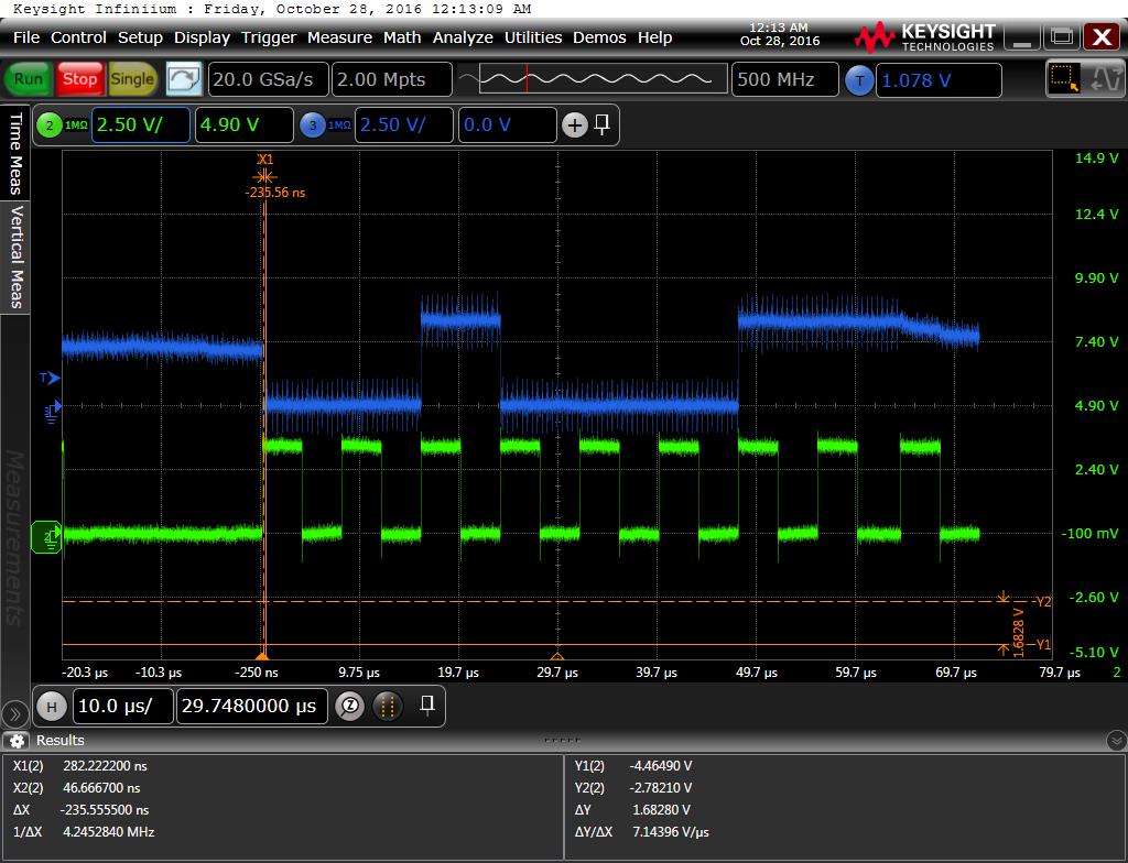

  • Hi Jim and Hooman,
     I have attached both pictures of the clock pulses on the first start without PLL lock and after restart picture.
  • My second question is why there's a delay in the clock pulse after the SH interval (Marked in RED).
  • Hi Martin,
    With regard to the clock pulse "skipping a beat" after the SH interval:
    This has to do with a need for the LM98725 SH interval (Register page 2, address 10h) to be higher than a minimum or otherwise the HSTG (High Speed Timing Generator) does not get initialized correctly. The system needs to be run for at least 1 line with the SH interval at 12 or greater, and then set the SH interval to 0.
    So, here is a procedure that we've found would work. You should follow these steps to see if your problem can be resolved:
    1. Set the SH state lengths to at least the minimum (12) and start generating lines.
    2. Run it for at least 1 line.
    3. Stop generating lines.
    4. Set the SH state lengths to 0 for CIS operation.
    5. Start generating lines.
    This should allow the high speed line timing to get loaded properly and to avoid the glitch in your high speed clock.
    To create the signal for the CIS sensor:
    You can create the short pulse on one of the SH channels by setting SH1 PIXEL ON at 1 and SH1 PIXEL OFF at 2. This is the signal that can be sent to the your CIS. The detailed timing between this signal and the high speed CLK sent to the CIS sensor can be adjusted by setting the fine timing of the PHIA (or B or C) signals as needed.
    Hooman
  •  Hi Hooman,
    I have configured the registers as you mention but how can I finely adjust PHIA1 for the sensor. I have looked on page 6 registers but here we can only set the shape if the waveform. Right now my CP and SP pulse rising edges are appearing together. See picture
