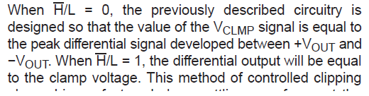

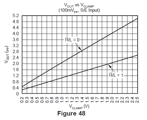

I have one question about the Vclamp function.
I think that the description of "Fig 48" and the explanation of datasheet "page 22" seem to be different.
<Fig 48>
<Page 22>
Though page 22 explains that "Vclmp is equal to the peak differential signal" at H*/L=0, the output is about x2 value of Vclmp on Fig 48.
Probably I misunderstood Vclmp function.
Could you please tell me what I mistook?
