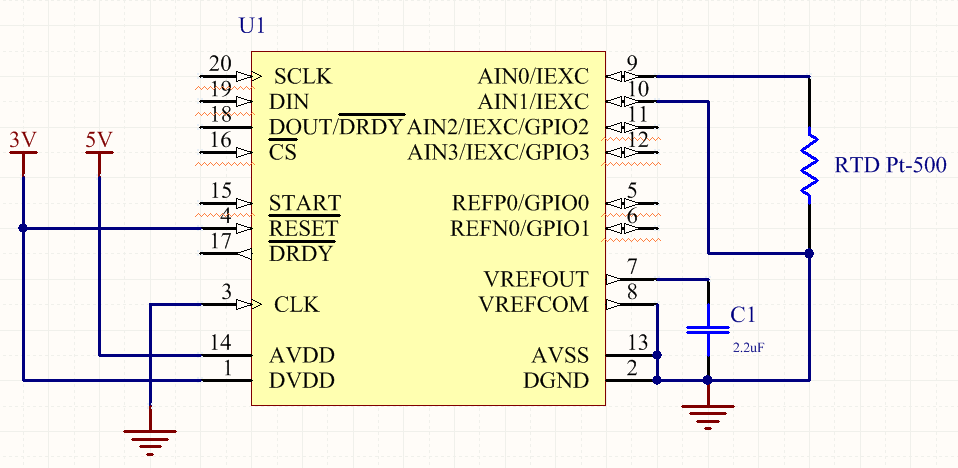

  • Hi, Joseph. I'm stuck with another issue, so could you help me, please?
    As I was able to write&read from registers and convert input voltage, I decided to connect pt500 to ads1247 in simplistic 2wire connection for a start, but couldn't get appropriate output current. Here's the snippet to check current source:

    AIN0 - Pt500 - GND
    RESET tied high, CLK, VREFCOM tied low, 2.2µF cap between VREFOUT-VREFCOM. IC soldered on mockup board for tssop. AVDD - 4.7-4.8V DVDD - 2.9V

  • Roman,
    It's hard to know what the problem is with so little information.
    First, can you read back all of registers and report them back here? There are plenty of settings on the device that might make affect different measurements. Then, can you provide a basic schematic? It's important to show all connections and components on your board.

  • Roman,
    First, I think it's worth reading back all of the registers just in case. If there's something wrong, this is the easiest way to rule out a bad configuration. It's also important that's read back just to ensure the SPI communications are correct.
    I would start debugging this by making some measurements. Use a multimeter to make sure that C1 has 2.048V across it. Second make sure that you have your 3V and 5V supplies correctly connected (I think you've done that though, based on your last post). One you establish the IDAC current measure the voltage across the RTD.
    I can't see your digital lines, but make sure those are also connected properly. Make sure START is high.
    Note that the RTD is not inside the common-mode input range. The input will not measure ground in this configuration. Analog inputs must be within AVSS+0.1V to AVDD-0.1V. This is an even tighter range when the device is in gain. This might account for a small loss in voltage measurement, which becomes more pronounced at smaller IDAC currents.
    I would also note that most will use a ratiometric measurement for measuring an RTD, using a precision reference resistor and connecting it to one of the external reference input. This way the output code is proportional to the RTD resistance divided by the reference resistance. If you get a current copy of the datasheet a two-wire RTD is shown in Figure 115. Just make sure that you don't route the internal reference to the external reference pins (for REF0 if you use it).

  • Hello, Joseph.
    I've read all the registers:
    Сurrent is set to 1.5mA this time(0x97). Voltage drop across rtd is 0.25V(550Ω).
    Voltage on VREFOUT as expected 2.04V.
    I've noticed, that after reading all the registers, ic went into sleep mode with START pin high, as I assume, because there was 0V on VREFOUT and 2.04 when I deleted rreg line from code and reran it.
    In my future project I would use ratiometric 3-wire configuration with hardware compensation, this setup is just for experiment.
