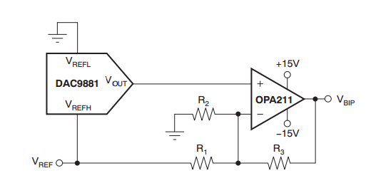

BIPOLAR OPERATION USING THE DAC9881 (data sheet page31)
Is the calculation formula of VBIP(CODE) right?
VBIP(CODE)=[ 1+R3/R2+R3/R1 ] x [ CODE/262144 - R3/R1 ] x VREF
For example,
R1=1K
R2=2K
R3=2K
VREF=5V
CODE=0 --> VBIP=-40 ?
CODE=262143 --> VBIP=-20 ?
I think the following calculation formula is right.
VBIP(CODE)=[ (1+R3/R2+R3/R1) x CODE/262144 - R3/R1 ] x VREF
For example,
R1=1K
R2=2K
R3=2K
VREF=5V
CODE=0 --> VBIP=-10
CODE=262143 --> VBIP=+10
itabi
  • Hi Itabi ,
    Great job , thanks for pointing it out
    I believe what you have derived is correct
    I will get in touch with my team to rectify the typo in the datasheet
    By superposition theorem
    Vbip (due to Vout)= 1+ (R3(R1+R2)/(R1*R2))Vout               Non inverting amplifier
                                        = (1 + R3/R2 + R3/R1)Vout
    Also
    Vout = code /262144* Vref
    Vbip (due to Vref) = - R3/R1 * Vref
    Vbip = Vbip (due to Vout) + Vbip (due to Vref)
    Vbip = [ ((1+R3/R2+R3/R1) x CODE/262144) – (R3/R1) ] x VREF
