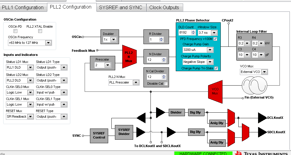

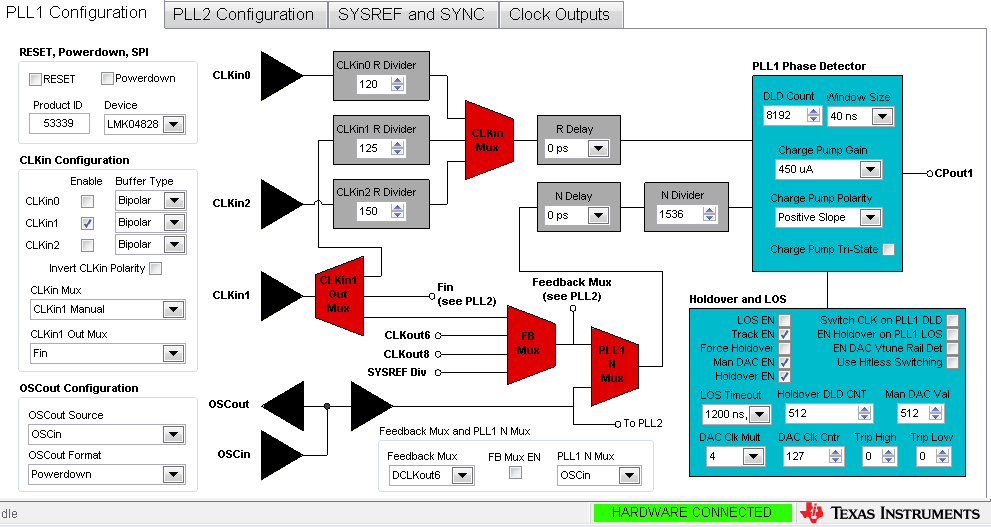

    If you are using the right configuration files for the LMFS_82820 mode external clock, you should see a sysref divider of 640 on the LMK tab of the GUI.  (this was also mentioned in your other posting thread when you originally had the revB capture card.)

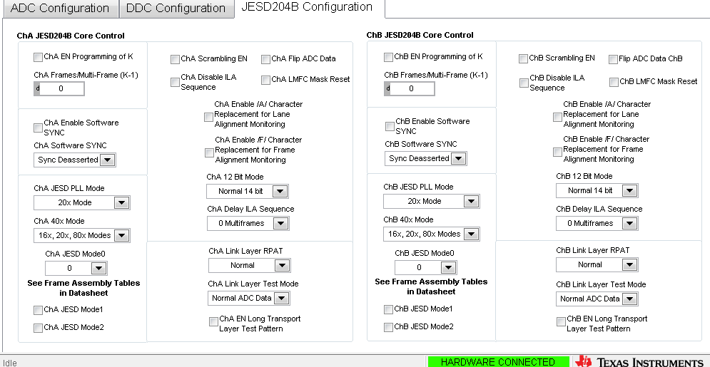

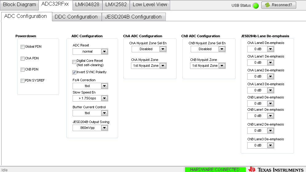

  • I have been able to get a few FFT plots at 3Gsps. It has been very hard to get the ADC configured correctly though. Almost 90% of the time after writing the ADC config file, then reading back the registers over SPI I obtain the results below and I am not able to change any controls in the GUI. My filtered clock sources are @ 3GHz at +15dBm and my analog in is at 1.75GHz at +5dBm. I am very disappointed in the performance of the eval board and SW so far as I have been not been able to adequately obtain performance results at > 2Gsps, which is the deciding factor in my design.
    HSDC is v4.2
    the screenshots for the LMK tabs look ok.  Just like they should for the config file that was to be used.  The screenshots for the ADC tab would indicate that the SPI readback is not reading back what was written.   for example, the 'K' value reads back as 0 even though the config file writes this as 16.   (it should display k-1 being 15)
    now if it were only the readback that was not working then the HSDCPro should capture anyway.  But if the SPI writes were not working either then you would just get timeout.
    There are only two conditions that I run across where the SPI accesses do not work.  One is that the clock and sysref are not present to the ADC before loading the config file for the ADC itself (including pressing the hardware reset button before loading the ADC config).   If the clock and sysref are not present first then the ADC will not be configured   And you have indicated that you are following this sequence.  The other case I had run across was if a bench supply was used for the EVM and the current limit were set too low.  There is an inrush current at the time the ADC cfg file is loaded and with too low a limit I have seen the voltage droop enough to lose the SPI configuration that had just been written.   Are you using a bench supply, and what is your current limit?  if normal current draw is a bit above 2A from the 5V bench supply, I would set a limit of 3A or more just to account for inrush current.

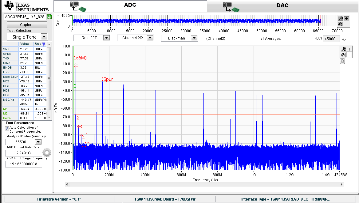

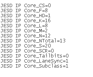

  • I am capturing now a FFT plot at 2.94912G samping rate. Why am I seeing this poor of performance? I believe my JESD204B settings to be accurate since it shows the appropriate lane rate (see below).
    Can you provide any input?
    I also use a 3A power brick in the lab and find that to be adequate.  So I don't think power supply droop would be the issue.  We've started shipping just power cable recently due to the difficulty in finding power bricks that meet the regulatory standards for every country we might have to ship to (and the regulations keep changing all the time), so I may be seeing more people using bench supplies.
    The poor FFT plot looks to me to be a mismatch between the configuration files used and the silicon on the EVM.     But is the SPI still not doing a proper readback during this time?  If so, the ADC may not be properly configured even with the correct files.   I would suggest this - please tell me the markings on the top of the ADC that is on the EVM (just to make sure it is the latest silicon and that there isn't still an early silicon board that got out) and attach the two config files you are using.  Then I can power up in the lab and use the exact config files that you are using.    And then I can suggest a webex where I power up in my lab and you can watch me bring it all up, and if you wish then I could watch you bring up yours.  We have to get to the bottom of this.

  • LMK_ADC32RF45_LMF_82820_ExtClock.cfgADC32RF4x_12bit_LMFS_82820.cfgSPI appears to be working as I am reading back the ADC settings from the ADC tab in the gui as well can set controls.
