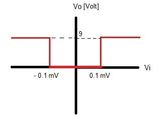

Hello. I am working on surface EMG signals. So you know their voltage range is max 10mV (peak to peak) and it has positive and negative components!  I need a comparator. If my Emg signal is over +0.1 mV , the output is +9v...and if my Emg signal is under -0.1 mV, my output is +9v too..But if my signal is between +0.1mV and -0.1mV, output is zero. Is there any suggestion for this application? Thanks in advance!
