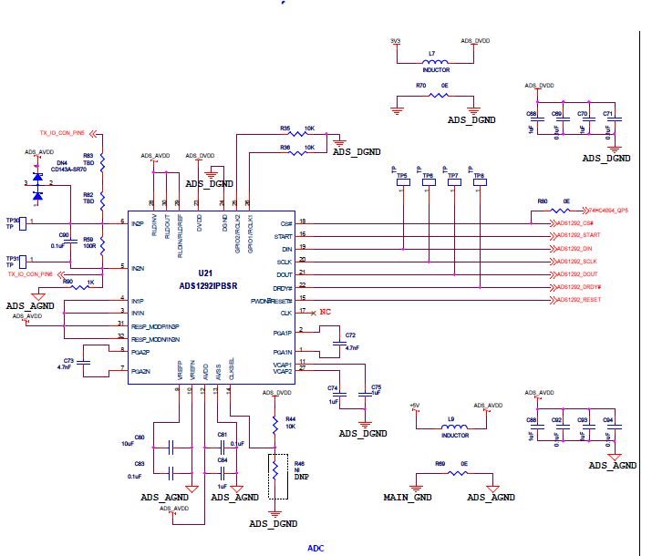

I am working with ADS1292 using MSP430F5659 controller SPI. I have done the firmware referring the ADS1292ECG-FE firmware coding.
I am able to read and write the register, but i am not able to read the ADC value from channel 2 when i vary the input, it give constant value always.
What could be the problem here.
I have selected internal CLK and internal Reference voltage. Please refer the attached h/w interface diagram.
ADC is running @ 500 SPS, SPi clock is 1M for initialization phase as well as Data read
My initialization routine will follows here which is similar to ADS1292ECG-FE firmware init.

  • Hi Nitesh,
    What values are you getting from the ADS1292 when you read the data? Can you please include screen shots/plots (O-Scope or Logic Analyzer) of your communication with the ADS1292?

  • Hi Cameron,
    We are now able to read the ADC data from ADS1292 for different input and its working fine. Problem was SPI clock frequency and some ADS 1292 register settings.
    But still we are not measuring correct value. We are seeing some drop in calculated value and actual value.

  • Hi Nitesh,
    Scope captures showing your communication would be helpful. Providing the raw codes received and the measured voltage on the inputs would also be helpful.

  • Hi Nitesh,
    Please describe your hardware setup. How is your ADS1292 hardware configured? Is this a proper PWB or is it a breadboard/prototype setup? How many samples are you taking for each DC input value? Have you verified that your reference and input voltage levels are stable?
  • Hi Tom,
    Please share your email i will send the schematic. Its proper PWB, with internal reference and sampling 500 sps. I forgot to mention we are using ADS1292 to measure the current and across 100 Ohm we are taking the voltage which is input for the channel 2. We gathered 500 and 1000 samples and took the average.
