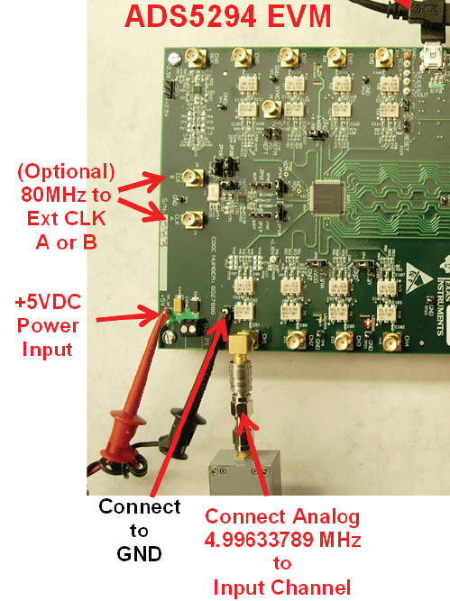

I bought ADS5294 EVM + FMC-ADC adapter to interface with Xilinx (Nexys Video board). I connected +5V to P1 connector (according to instruction in manual, pg-7) of the ADS5294 EVM. According to the manual, there are 4-LEDs should have turn ON. Unfortunately, Only 2-LEDs are becoming ON (+5V & 3.3V). 1.8VA & 1.8VD is kept OFF.
Unfortunately, I am not getting any signal from LVDS output at xilinx I/O terminal. I am suspecting something wrong with power supply of the ADS5294EVM module.

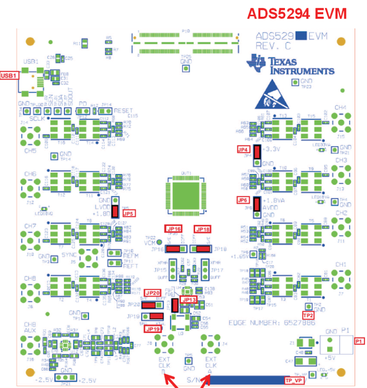

    1) Please check all the jumpers on ADS5294EVM and make sure all connections are right:
    (Note: in this case, you are using on-board OSC as the clock input for ADS5294 device.
    So you don't need any external clock connection.)
    2) Please check +5V Power supply connection for ADS5294 EVM:
    3) If you only can see:
    LED33VA => ON
    LED_+5V => ON
    other two LEDs are not ON, that is Ok!
    because we measure Jumpers for (1.8VA and 1.8VD):
    measured JP6 => we got 1.8V => correct !
    measure JP5 => we got 1.8V => correct !

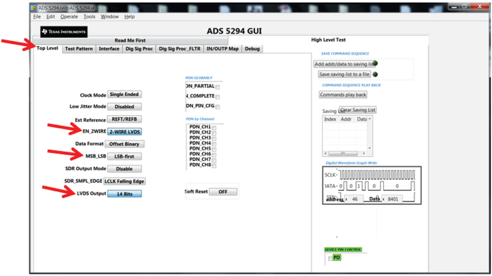

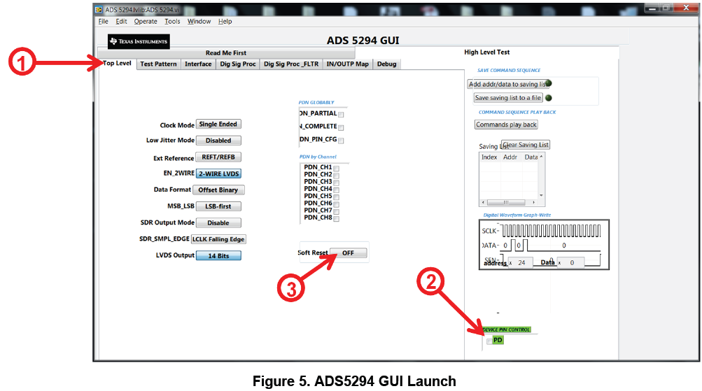

    4) And then we started to follow the user's guide to run ADS5294 GUIs:
    (Note: Please Click all the following checked options as below to enable the ADS5294 Registers.)
