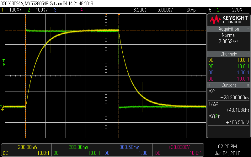

I am using two ADS8332 configured in daisy chain mode to provide a total of 16 analog readings. The ADC voltage conversions are about 20% less than the expected value.
The ADS8332 is configured as follows:
VA=5V, VBD=3.3V, VREF=4.096V. There is a buffer with a 5.3 MHz filter to drive the ADC Pin
I've taken some DC measurements when the voltage at IN1 is 1V:
  • IN1: 0.986V
  • VREF = 4.09505
  • VA=5.043
  • VBD=3.287
In one case, the IN1 voltage is expected to be 1V, however the conversion result is 0.78V. (a count of 12335 decimal)
I took some scope measurements of the ADC IN pin during conversion. The green trace is the unfiltered OPA211 output, the yellow trace is at the ADCIN pin.
Pin IN1 has 0.486V on the input and all other channels are 0V. The ADC reading is about 0.38V (ADC count 23996)
The figure below shows ADCIN as the mux is switching sequentially from I0 through IN7.
Any advice is appreciated!
Igor

  • Hi Abhijeet,
    Thanks for your help.
    Is the low input impedance of the OPA211 the reason the rise time of ADCIN is slower than expected? The output filter on the OPA211 should have a rise time of 70ns, but I am seeing a rise time greater than 5us in the yellow trace above. The green trace is the output of the OPA211 and it is not slew rate limited.
    For the increased Va, do you mean increase the Va of the ADS8332 or increase the supply rails of the OPA211/209
    Will the using the OPA209 solve the acquisition error or will it just improve the offset error?
    Thanks!
  • Hi Igor
    OPA211 input impedance may not be causing rise time delay at ADCIN. As you are seeing different voltage at ADCIN I wanted to make sure if that is caused by amplifier stage.
    To ckeck this you can short  series resistor 10k on input channel and repeat the test to see if you get right code. If this solves the problem then we need to look at OPA211 stage
    If this does not solve the problem then we have to look for other possibilities.
