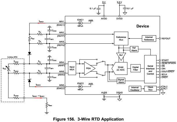

There is a drawing for 3-wire RTD application with lead wire compensation, from this, it seems that 6 analog inputs are already occupied. Does this mean only single 3-wire RTD can be connected with ADS1692/3?

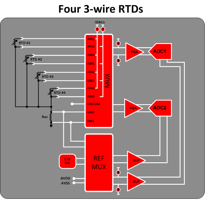

Or AIN4, AIN5 and AIN6 are dedicated for w-wire RTD-1, then AIN7, AIN8 and AIN9 can be used for RTD-2?

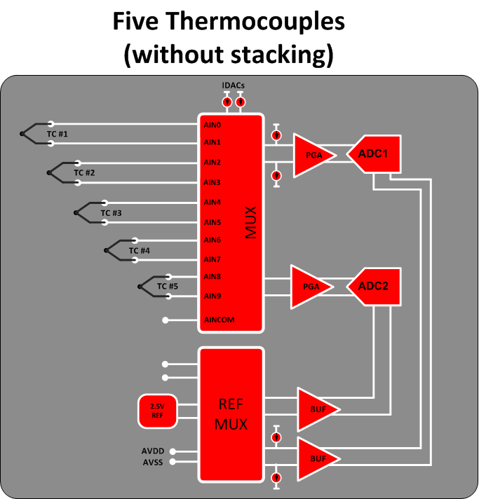

As same as above, how many thermocouples can be connected to ADS1692/3?
My customer would like to use total 12 sensors either RTD or thermocouple. What is the best solution for this?

    You can increase the number of RTDs connected to the ADC by sharing a common reference resistor and removing the dedicated IDAC current outputs (the IDAC currents can be routed through the input pins). This allows for a total of four 3-wire RTD as shown below:
    For thermocouples, you can simply use two pins per thermocouples and connect up to five thermocouples, as shown here:
    To support 12 sensors, you'll need to consider the trade-offs using either multiple ADCs or external multiplexers. Multiple ADCs would make the routing much easier. If you use external multiplexers, you could take the RTD example above and replace each RTD with a 6:2 MUX, for example.

    In Four 3-wire RTDs circuit, can you please let me know what is the cycle of IDAC switching in typical application? Normally how much settling time need to be taken care?
    Also, with regards to five thermocouple configuration, do you have any ideas how CJC(Cold Junction Compensation) can be implemented?

    The settling time required after switching the IDACs mostly depends on external "R" and "C" component values, including the RTD, lead, reference, filter, and parasitic values.  You could simulate it to get an idea of the order of magnitude, then it would be fairly straight forward to measure after building the circuit.
    Here is a TINA-TI template RTD circuit: 3-Wire RTD Simulation.TSC
    Measuring the cold junction can be done in many different ways (for example, with a dedicated RTD, thermistor, or IC temperature sensor). It's common to see thermistors used for CJC as they are simple and cheap, but again it depends on what level of performance you need to achieve. An RTD or IC temperature sensor could give you better accuracy. The IC temperature sensor wouldn't use up an ADC input channel, but on the other hand, some junction blocks have built-in clamps made for thru-hole RTDs.
