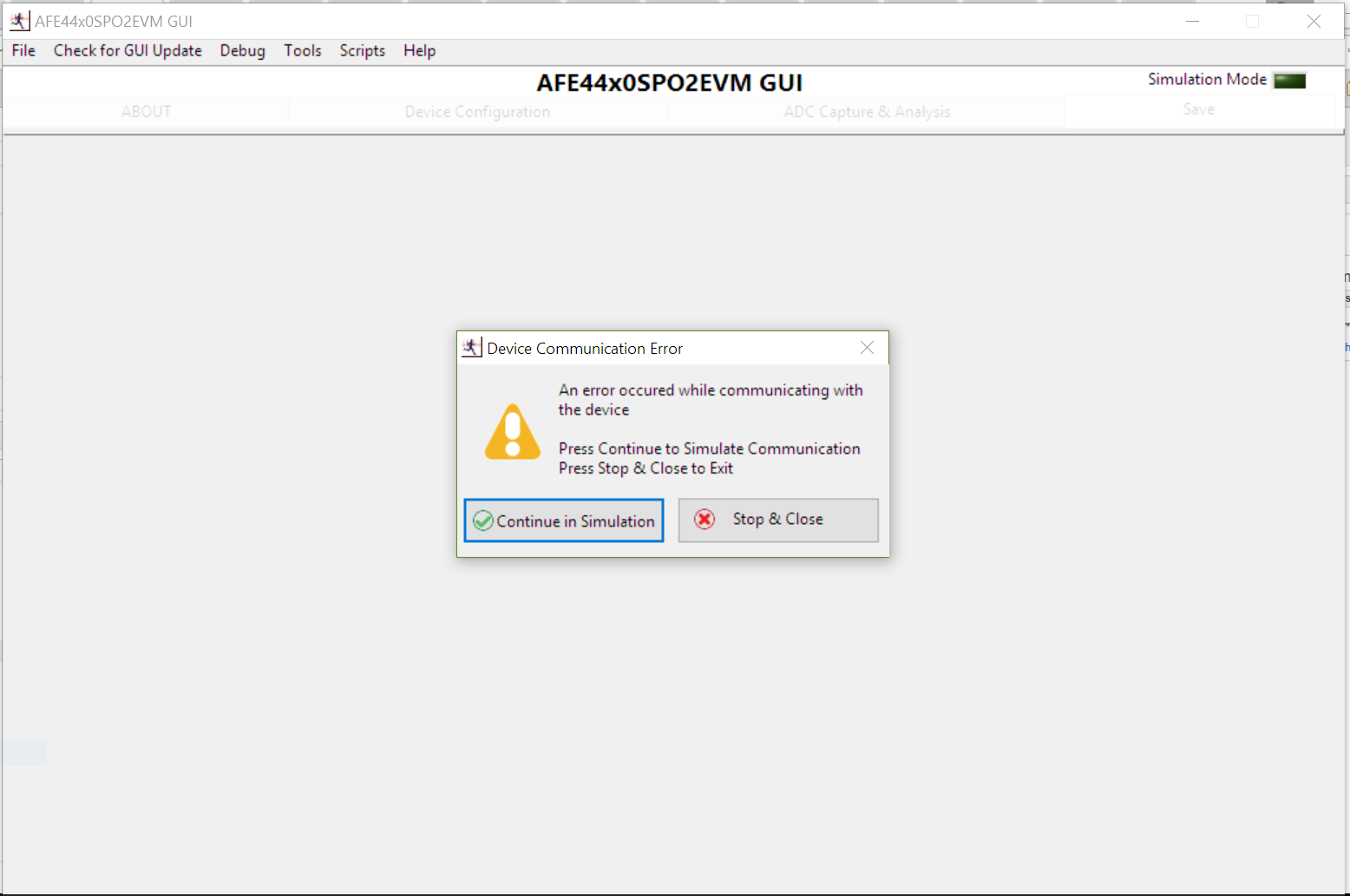

Every time I start the GUI I receive the message "An error occurred while communicating with the device." I have checked in my Device Manager and the board registers until Ports as USB Serial Device (COM3). I also followed instructions in the User Manual to make sure the firmware and software was up to date. However, I still receive this message every time.
Pressing "Continue in Simulation Mode" causes the program to freeze until I force quit. Pressing "Stop & Close" successfully exits the program. Occasionally, if I press "Continue in Simulation Mode" and wait long enough, the program will start in Simulation Mode; however, this mode does not seem to interact with the device.
Do you have any suggestions as to how I can successfully start the GUI and interact with the board?
