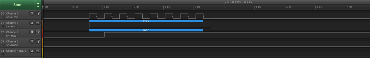

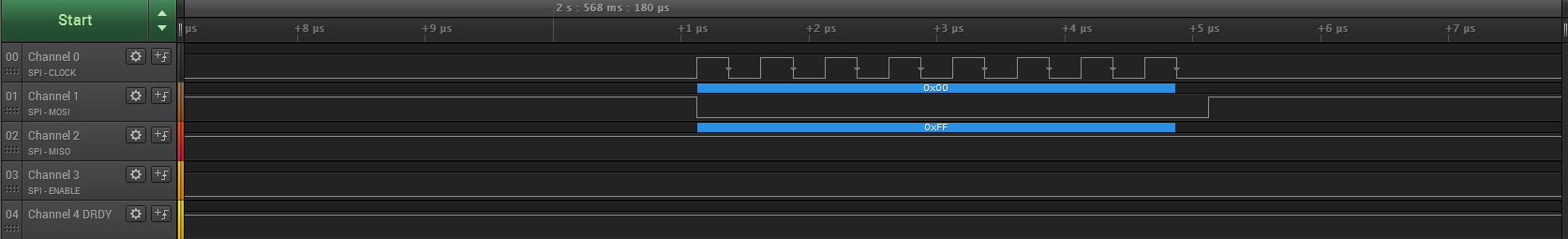

  • Hello Brian,
    Thank you for replying. I didn't answer sooner cause I didn't have a logic analyzer.
    Below I present you my arduino code and result through the logic analyzer.

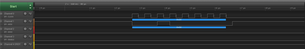

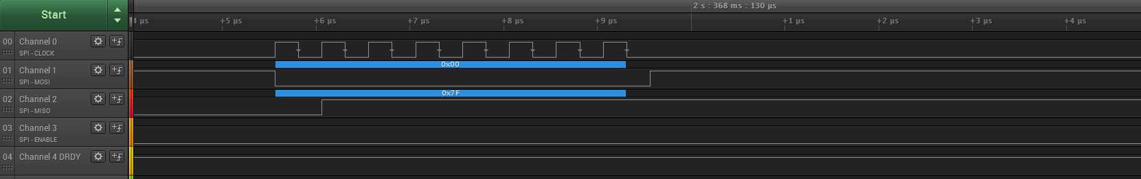

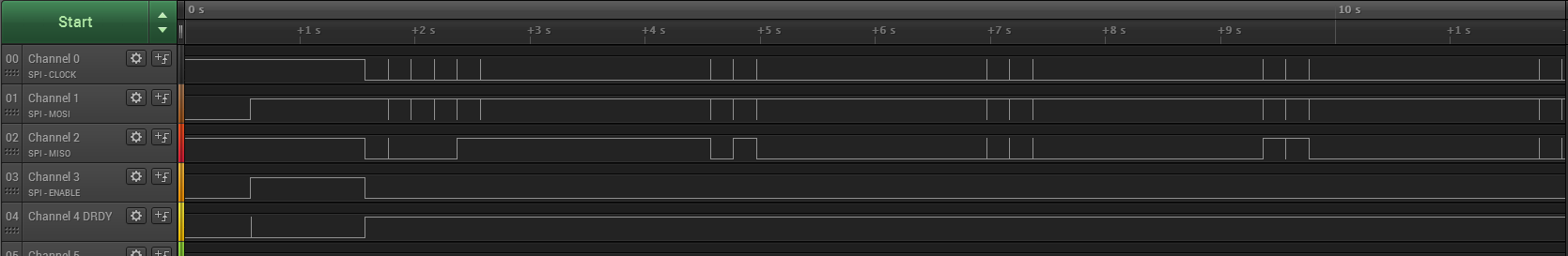

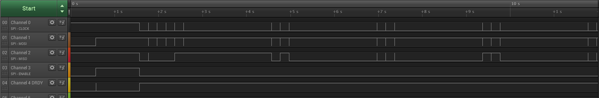

    And here is what I get as a result:
    An overall preview

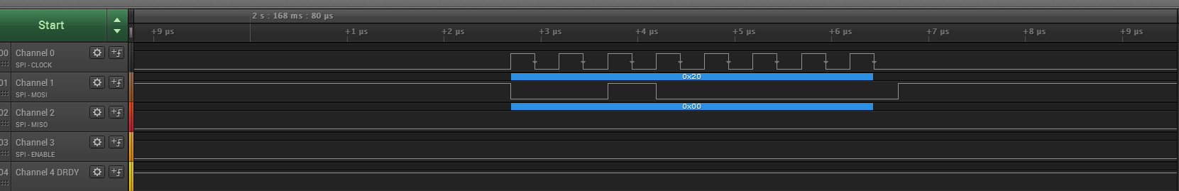

    The wake up command

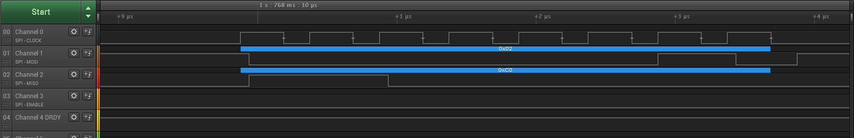

    The SDATAC command

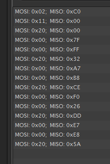

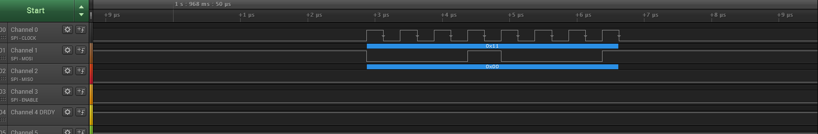

    And the three command for reading the register (2 commands and one 0 transfer to print)
    And the rest of the transactions
    I should mention that when I check my results through serial after some repetitions all I get back is zeros.
    Spiros

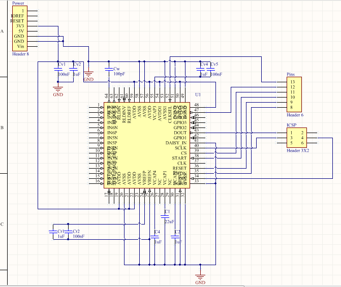

  • Hello Spiro,
    Your communications look as though they should work. Can you upload your schematic?
    Brian
  • Hello Brian,
    thank you for taking the time to help me with this,
    I could really use some help.
    Here is the schematic, sorry it is a bit messy, I only made it for my pcb layout.
    Let me remind you some connections.
    I put the capacitors as they are in datasheet's page 63 instructions for a unipolar supply.
    I've also grounded pins RESV1(31) and DAISY_IN(41) as it is mentioned at page 11.
    I can control/read CLKSEL, DRDY, CS, START, RESET and PWDN pins using Arduino's digital pins 8-13.
    I've connected Din(MOSI), Dout(MISO) and SCLK to Arduino's ICSP.
    The supply is same for the analog and the digital part 3.3V.
    Thank you, Spiros

    DRDY pin is shown at the first pic of the logic analyser's results at channel 4.

    I am expecting 1.2 V at VCAP4. Please also check VREFP. It is strange that it seems DRDY is working fine and then stops when you begin communicating with the device. This seems to indicate to me that something happens to the chip where it is no longer powered properly.

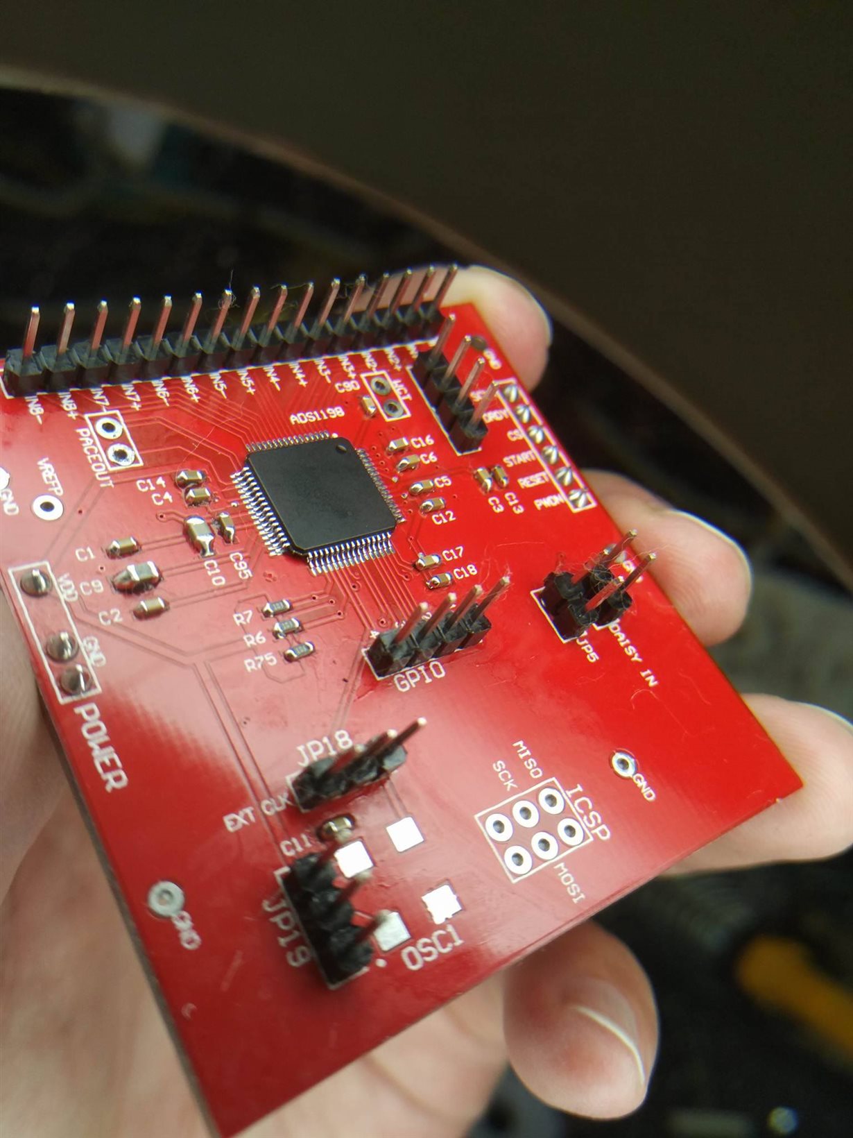

  • I'm back after so much time to give an answer to this problem.
    You were right after all Brian!
    I got my professional pcb, did my soldering and now chip works fine. I can read registers and get the correct values.
    My pcb layout was based on the demostration kit ADS1198ECGFE-PDK.
    So i'm not completely sure what the problem was, if it was a pcb issue or now that I changed a bit my layout but it works.
    Here is a picture of my pcb working as an arduino shield for my convienience.
    Thank you very much for your support Brian.
