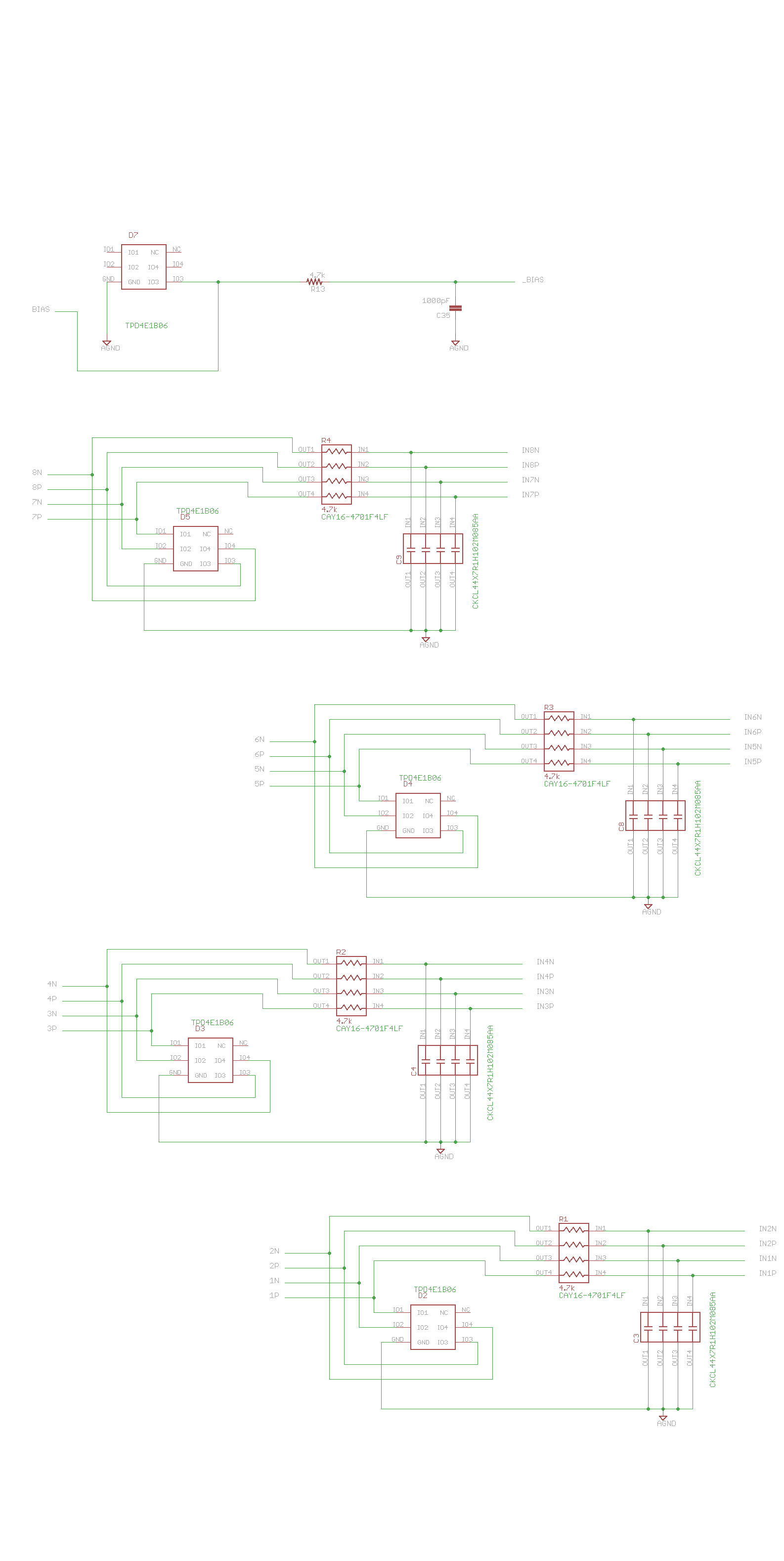

Simple schematic for EMG using ADS1298
Other Parts Discussed in Thread: ADS1298, ADS1299
Hi everyone, I'm trying to draw simple schematic for EMG based on ADS1298. I want to connect it via SPI to STM32F4 discovery. So, can I ask you to check my schematic and help me to understand how to connect common reference electrode (I'm planning to use all 8 channels). As far as I know we use only one common electrode for this chip. How it will affect to my other channel if I place this electrode on elbow for example (other electrodes are placed on biceps, triceps, trapezius, etc).
And how can I connect RLDs pins for measuring EMG. Also, according datasheet I can use 2 chips and get 16 channels. It could be using DAISY_CHAIN or
Slave -> Master <- Slave connection (SPI). If I'd like to use daisy chain, how can I draw my schematic for this purpose.
I have a level shifter to use it with Arduino (probably), cause it has 5V pins. As I know stm32 SPI works well without shifter
My schematic
  • Hello Ivan,
    Unfortunately I am unfamiliar with the clinical aspects of EMG (like electrode placement, etc.), but I can certainly advise you as to how to properly use the ADS1298.
    It appears that you've adapted this schematic from another that used the ADS1299 since you still have "SRB" connections and a "Bias" electrode. The ADS1298, however, does not have "SRB" capabilities so those connections should be removed. If you want to collect data with respect to a single reference electrode, that electrode will have to be routed to the INxN pins for each channel.
    The RLD can be configured like it is shown in Figure 43 of the ADS1298 datasheet. The feedback loop between RLDOUT and RLDINV must be closed if you expect the common-mode rejecting features to work properly.
    For details on multi-device configurations, refer to section 9.4.2 of the ADS1298 datasheet which begins on page 56.
    An error I noticed: do not connect the WCT pin to ground. This can create a short circuit.
    Brian
  • Thanks for your reply. The bias electrode is used only with ads1299, isn't it?
    I found several schematics there are RLD is routed to both pins INP and INN, you mentioned to connect it to INN. I can't realise how to use it? And if I connect RLD to channel, should I use a resistor in my connection?
    One of those schematics processors.wiki.ti.com/.../SCHEMATIC-ADS1298_Test_Circuit.pdf
    And WCT, most of found schematics have this pin connected to AGND via capacitor, is it correct?
    And can I use ads1298 for emg and ecg purposes. I mean 7 channels are measuring emg and the 8th channel is measuring ecg for heart rate tracking
  • Hello Ivan,
    Yes that is true. But the bias on the ADS1299 and the RLD on the ADS1298 function in the same way - bias the patient so some known voltage.
    I'm not sure what you mean. Why are you trying to connect the RLD to both channel inputs? That schematic does not show the RLD connected to channel inputs.
    Yes the WCT is usually shunted to ground via a capacitor. Your schematic shows it directly connected to ground, which is a short circuit.
    The ADS1298 should be ok for EMG as long as the signals you wish to measure are larger than the input referred noise specifications of the ADS1298. You can find the noise statistics in the tables beginning on page 22 in the datasheet.
    Brian Pisani
  • Indeed, it seems to me I was wrong with RLD example schematics, but I saw some "working" schematics where inputs are routed to RLD. Nevertheless, according to datasheet, this chip has 2 modes of RLD (external and internal). Does this mean that I can measure EMG without RLD electrode (configure it in other way). If I understood correctly, if I set RLD as internal mode my common reference will be initialised inside the chip. And I will have only 8 pairs of input electrodes instead of 8 pairs + 1 electrode. Am I right?
    And I 'm confusing about power supply. Page 76 Figure 74 shows +- 1.5V for bipolar analog supply and + 1.8V for DVDD. My schematic, which I adapted from ADS1299 has +-2.5V and +3.3V for DVDD. Is it okay for ADS1298 or I must change it according to datasheet?
    And one more question, I guess I a little bit confused, can I use schematic for ECG to measure EMG without changes or I must change for this purpose? I mean are the signals the same or not (I watched a couple of videos where guys measure EMG with ADS1298ECG-FE)
    And big thanks for your reply, I think it 's becoming more understandable for me now.
  • Hey Ivan,
    You will need some way of biasing the patient's voltage. Even if you were to use the RLD output as a reference on the board for measuring the channels, there is nothing keeping the patient electrode voltages from swinging well outside the range of the ADC. I would recommend using a separate RL electrode or some other reference electrode with an actively regulated voltage that is connected to the patient.
    The +/-2.5V analog supply and +3.3V digital supply are a valid configuration.
    The only difference that I am aware of between EMG and ECG is the magnitude of the signals. As long as the intended signal magnitude is larger than the noise level on the ADS1298, then I do not believe any special considerations must be made.
    Brian
  • Brian, thank you for your reply!
    What is better to use 1 low-pass filter or 2? My schematic uses 1 low-pass filter, is it enough to read more quality signal without noises? And what are the values of resistor and capacitor better to use to decrease the noise?
    So, and my question about RLD, if I wanna use my external RLD electrode, I have to connect RLDOUT to RLD electrode (with low-pass filter and ESD protection such as channel's pins), I connect RLDIN to RLDINV via 1M resistor and 1.5nF capacitor, which are connected in parallel way, RLDREF to AGND and WCT via capacitor to AGND too. Am I right?
  • Ivan,
    Using a second order RC low-pass filter will likely provide better anti-aliasing, but it may not be required. The relevant formula then is fc = 1/(2*pi*R*C). The resistor R can double as your patient protection resistor, so you can pick that value first. Then I recommend you pick C such that fc is somewhere around 32 kHz. The ADS1298 is a delta-sigma ADC, so sampling happens significantly faster than the output data rate.
    That is a valid RLD connection scheme!
    Brian Pisani

  • Hey Brian, I reconfigured my schematic, could you please check it for mistakes?
    Also, Figure 109 of datasheet recommends to use resistors on SPI lines to prevent reflection. Is it necessary to connect SPI of slave to master via those resistors, my main MCU SPI pins have 3.3V.
    And I decided to pass voltage regulation circuit, cause according to datasheet +3.3V should has around 250mA of current, but my MCU has up to 180 mA, so can I use my MCU's +5V as a RAW POWER?
  • Hey Ivan,
    The schematic looks fine.
    I wouldn't worry about digital communication reflections if the processor is reasonably close to the ADS1299.
    The ADS1299 will consume less than 10 mA when using a 5 V AVDD and 3.3 V DVDD. Either source should be sufficient to power the device. The logic level for communication should be equal to DVDD.
    Brian Pisani
  • The processor is too far (aprox. 10 cm) from ADS1298, they will be connected by wires, it is 2 different pcbs. My processor has 3.3V on SPI lines, I think it's enough and I don't need shifter, am I right? And what about the schematic, is it correct?
  • Ivan,
    As long as you are also using 3.3V for DVDD then you should be fine. The schematic looks good.
    Brian
