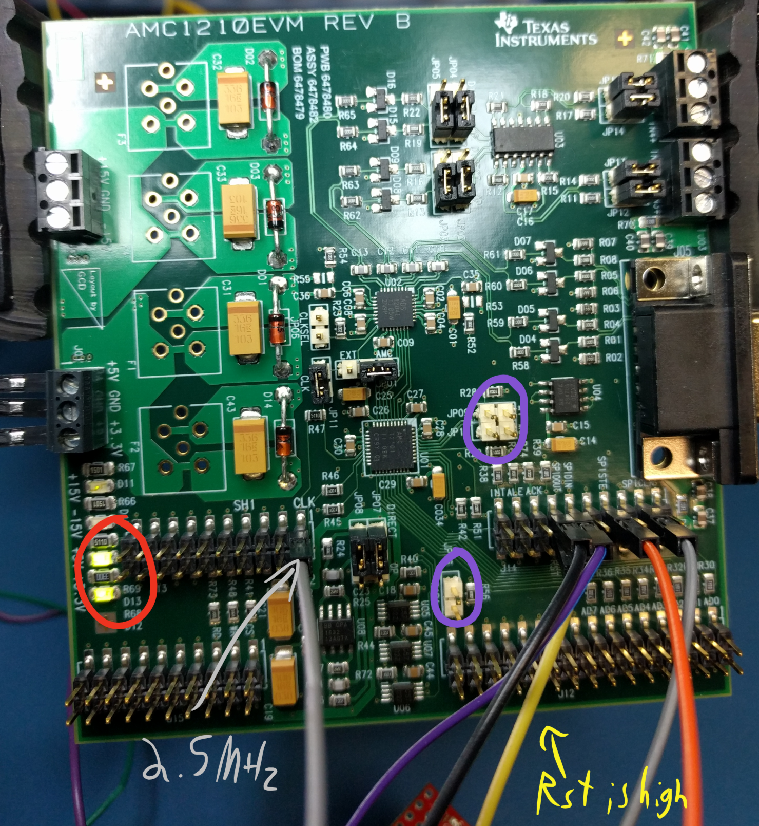

I am currently trying to use the SPI interface in the AMC1210EVM board. I am using a Tiva C tm4c1294ncpdt connected launchpad. The problem is that the EVM is not responding to any commands (The SPIDout stays low all the time)
Here is what I know:
Power: the EVM needs two power supplies, a 3V3 and a 5V and I am providing those from the tm4c launchpad (the picture shows that I am powering the boards because the LEDs light up)
Pinouts: 4 pin SPI interface (picture shows the connections)
Code: I am using the Tivaware APIs and driverlib to setup the SPI interface using SSI2. The settings are: System clock: 25MHz, SSI clock: 1 MHz, master mode, SSI_FRF_MOTO_MODE_1, and 8 bits packages)

What I am trying to do is send a write command bit to address 0x06 and write some values to that register to see if I can get them back.
What I tried: I tried connecting the RST line in the EVM and since its active low I just keep it up all the time. I tried connecting the CLK like in the EVM and feed it a 2.5Mhz clock by using a 50% duty cycle PWM.
What I want to know: Am I doing something wrong? what steps should I follow now to try to debug this?
Here is the picture of my EVM and connections. JP9,19, and 16 are open just like the datasheet says.

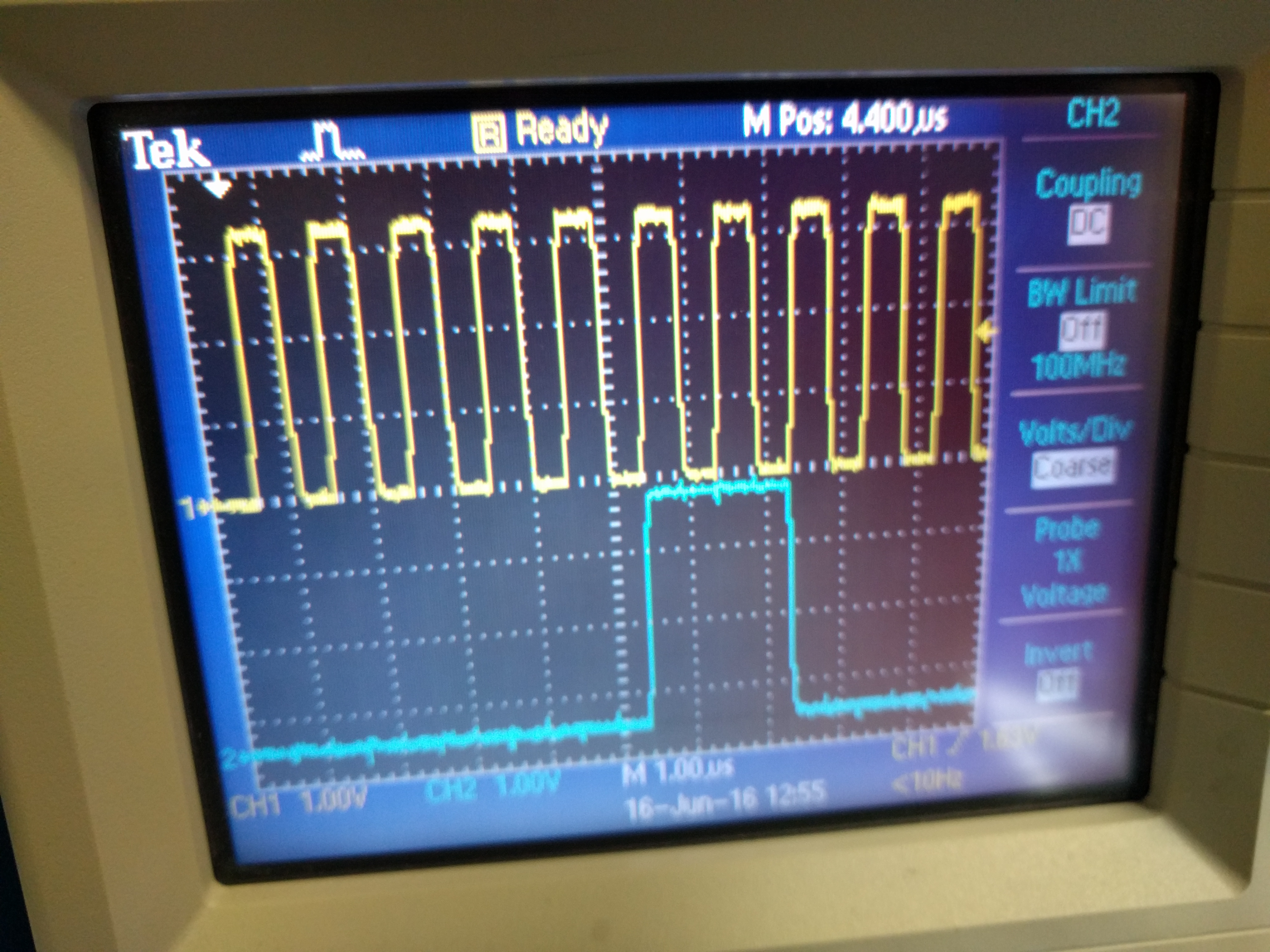

Here is a picture of the write command, CH1 (yellow) is the clock and blue line is MOSI :
