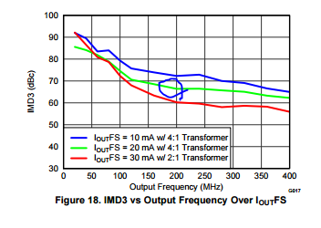

  1. Need 10MHz interval, 2-tone IMD test result
  2. Need DAC3482 Evaluation board Setting method or Setting file(=Config file)
  • Henry,
    1. The two tone IMD test result can be found on the datasheet, figure15 to figure 19.

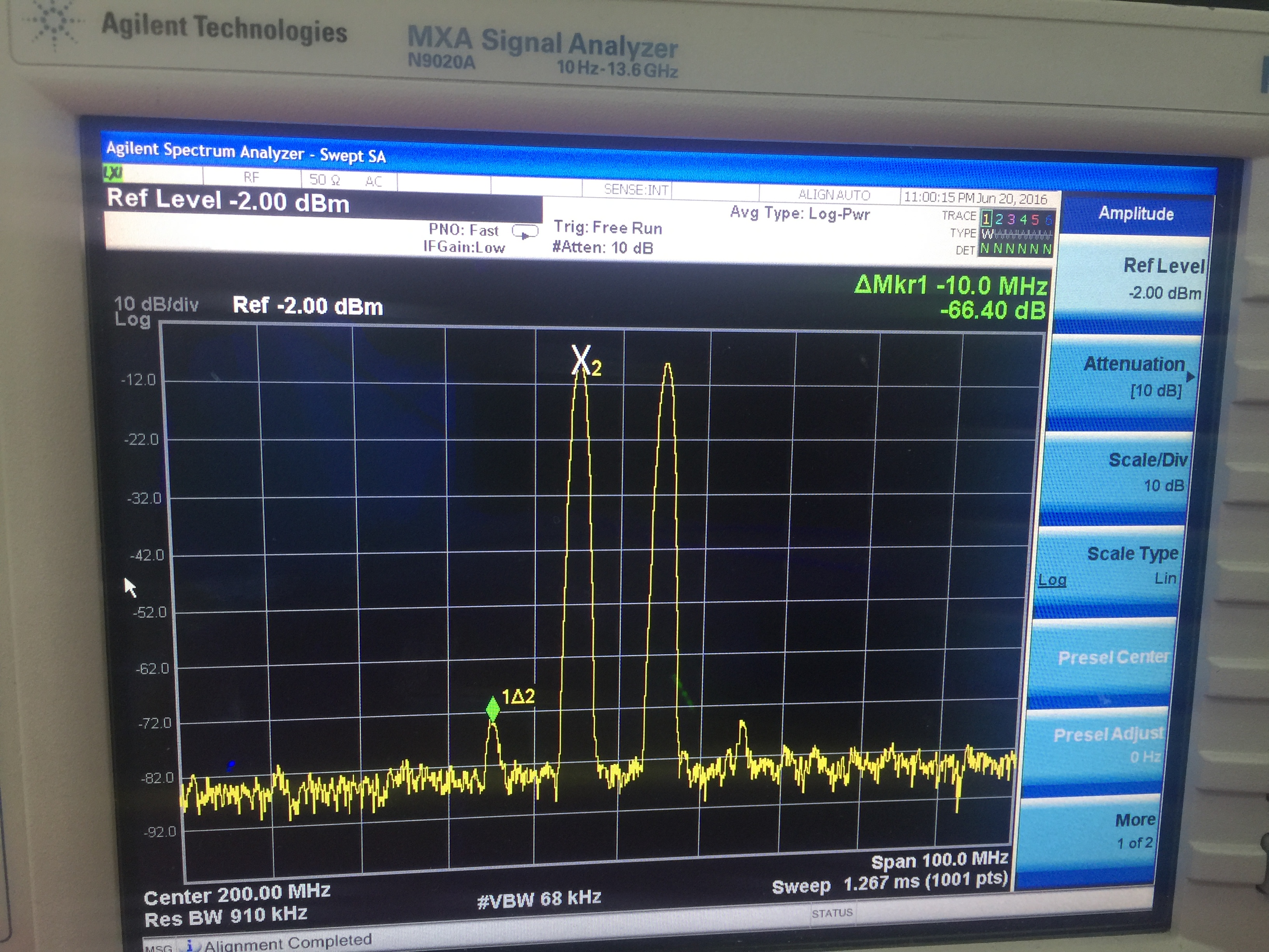

  • KANG
    The test results of DAC3482EVM.
    Datasheet reseult and my result are different.
    Need a detail description for my result.
  • Henry,
    Visiting the DAC3482 datasheet IMD3 result, I saw at 200MHz the IMD3 is around 66dB, which matches your result.
    You may also adjust your spectrum analyzer's attenuation setting to prevent distortion from analyzer itself impacting the measurement. You may need to zoom in on the spurs for finer measurement as noise floor will rise from higher attenuation settings.
