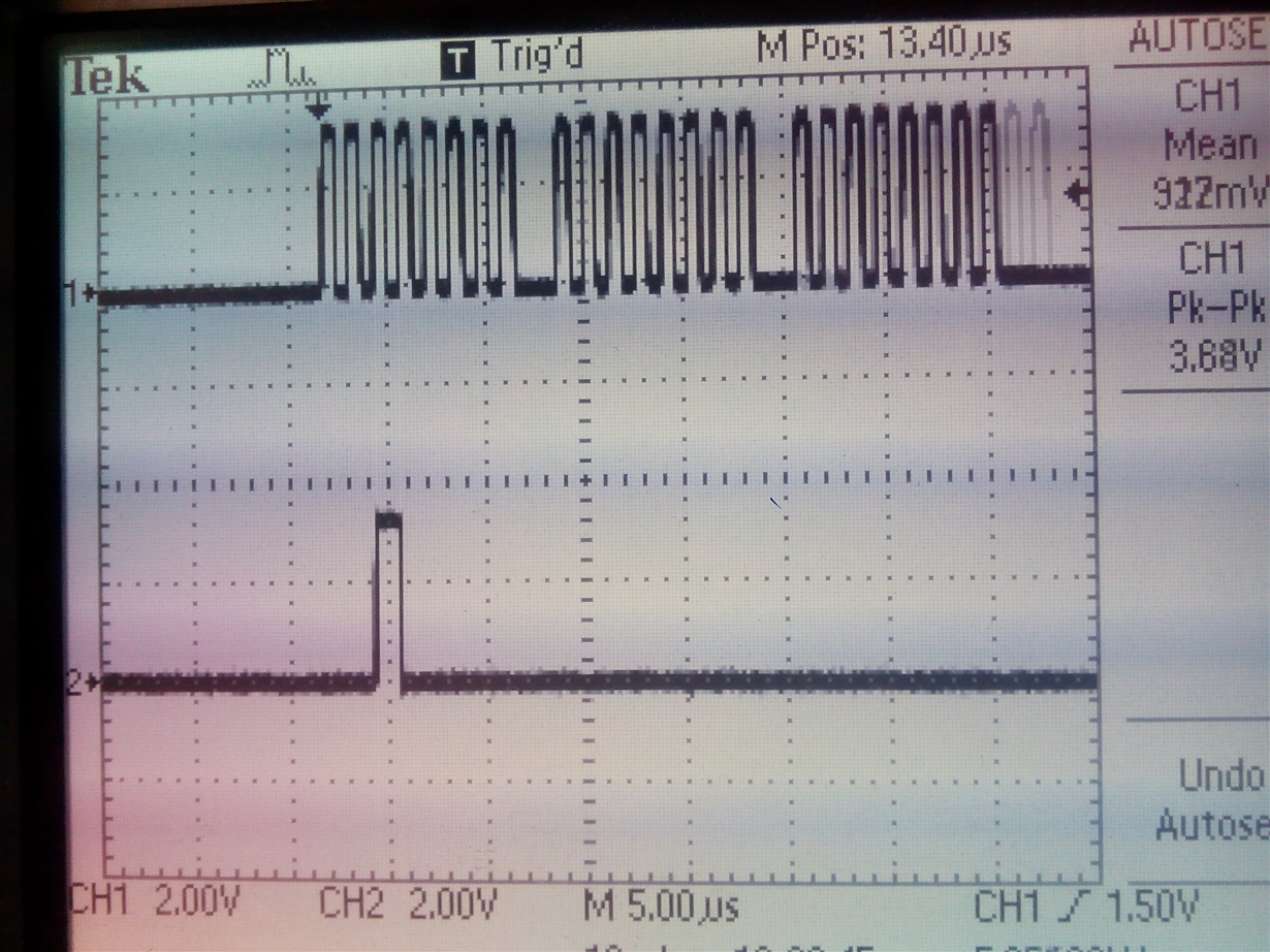

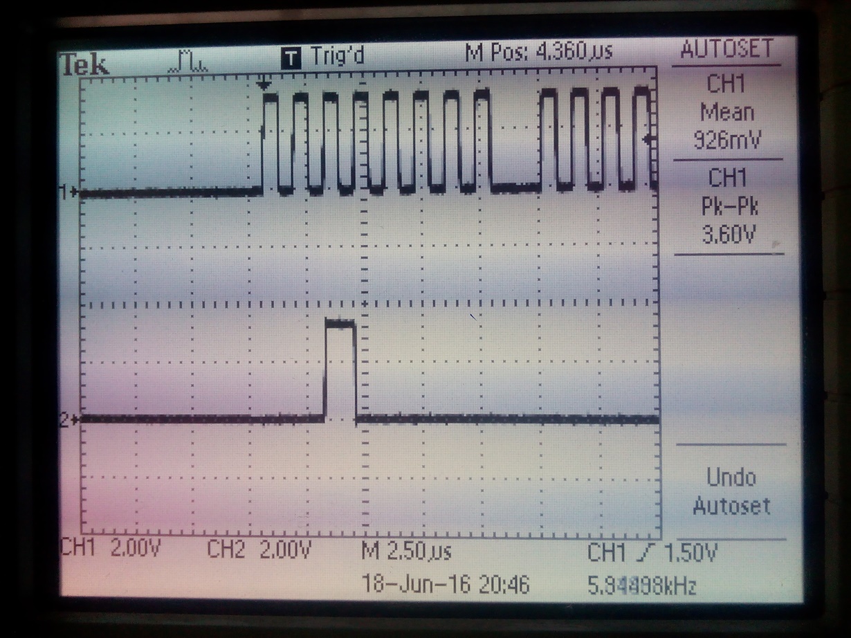

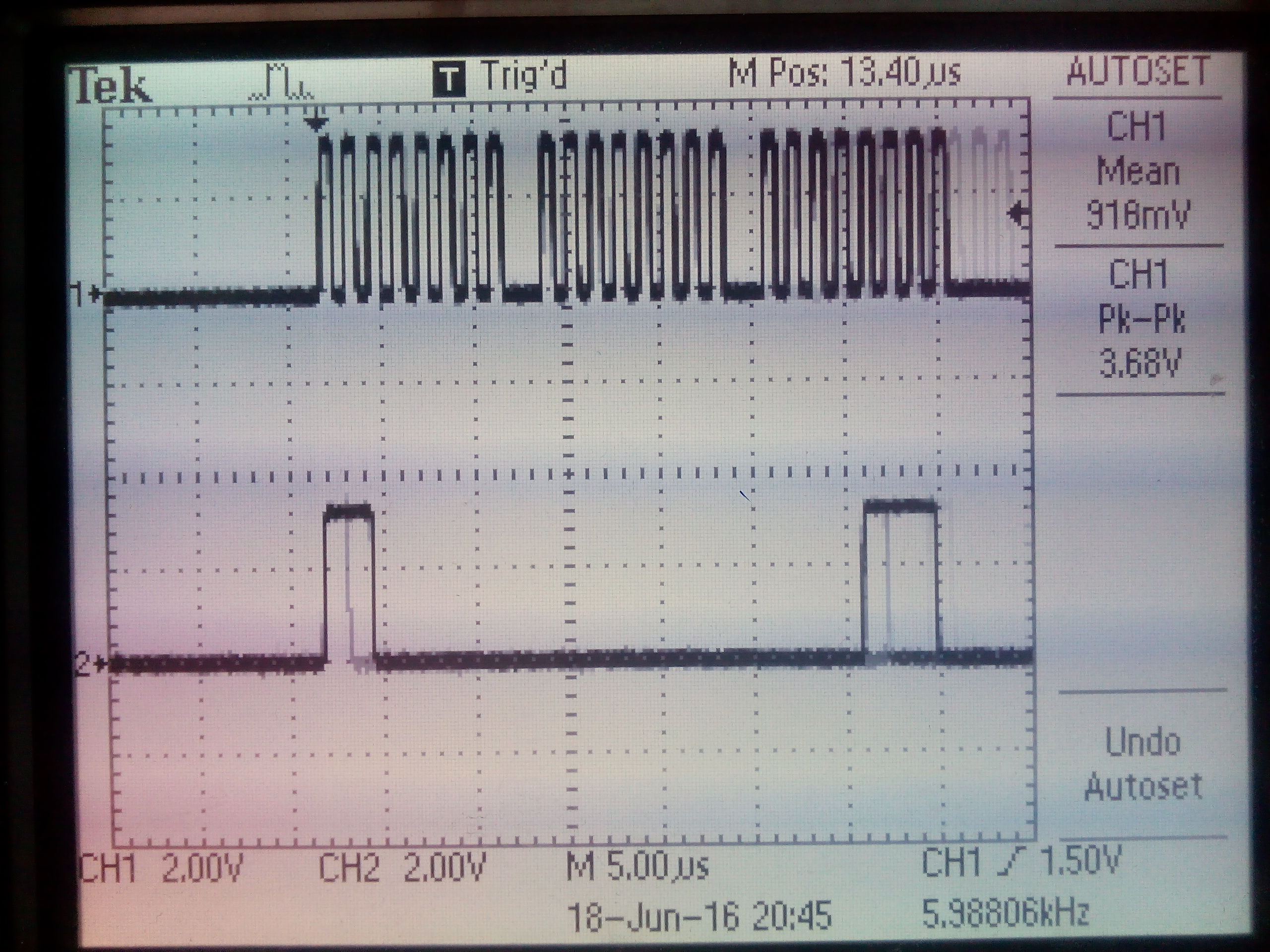

I am trying to read the ID of ads1298.
My scope snaps for din + sclk (zoomed(fig 1) and the one showing 3 bursts (fig2) ) and dout + SCLK( fig 3) are shown below.
Please help me with this .
Fig 1
Fig 2
Fig 3
Any help would be greatly appreciated.
Thanks so much,
Harsh
  • Hello Harsh,
    Was this RREG preceded by an SDATAC command?
    Brian
  • Hi Brian,
    Thanks for your reply,
    Yes I did give an sdatac before this command
    My energia code is given below:

  • Harsh,
    Are you able to see the DRDY signal toggling at the data rate?
    Brian
