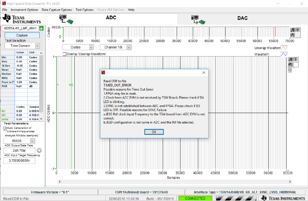

I am trying to capture data with ADS54J66 and TSW14J56. I've followed all the setting steps provided by http://www.ti.com/lit/ug/slau641d/slau641d.pdf
However, when I click on "Capture", the following error appears:
LEDs D3 and D8 are switched on, D1, D2, D4, D5, D6 and D7 are switched off.
Could you please help me solve this issue?
