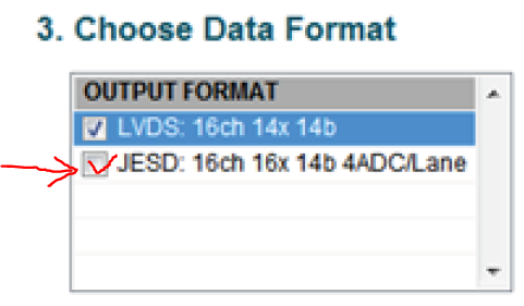

My customer is using ADS52J90EVM with TSW14J56EVM.
He has saome questions about HMC-DAQ GUI.
Could you answer the following question, please?
Q1: What does the below picture window mean at JESD204B interface?
-> For example, What is ADC Output Data rate?
Q2: Could you please give me User's Guide at JESD204B interface of HMC-DAQ with ADS52J90EVM and TSW14J56EVM?
Shimizu
  • Shimizu-san,
    Q1: This window does not have much JESD information. "ADC Output Data Rate" simply means the ADC sampling frequency and does not represent the actual output data line rate. Under the menu item "instrument options" > "Dynamic Configuration" can give you some JESD information.
    Q2: We only have the Quick Start menu for JESD configurability. You can easiliy load your own custom configuration file using the menu item at the top left. The "scripts" folder in the HMC-DAQ directory has some advanced JESD scripts. Otherwise, please contact us directly if there is a specific function that you need help with.

  • Hi Masahiko,
    How are you?
    For Q1,
    more detail, it is Output Data Rate = Sample Clock Rate
    For Q2,
    On the user's guide, on Page 21 (also page 24)
    Please check on JESD mode option:
    Shown as below:
    Thanks and best regards,
    Chen
