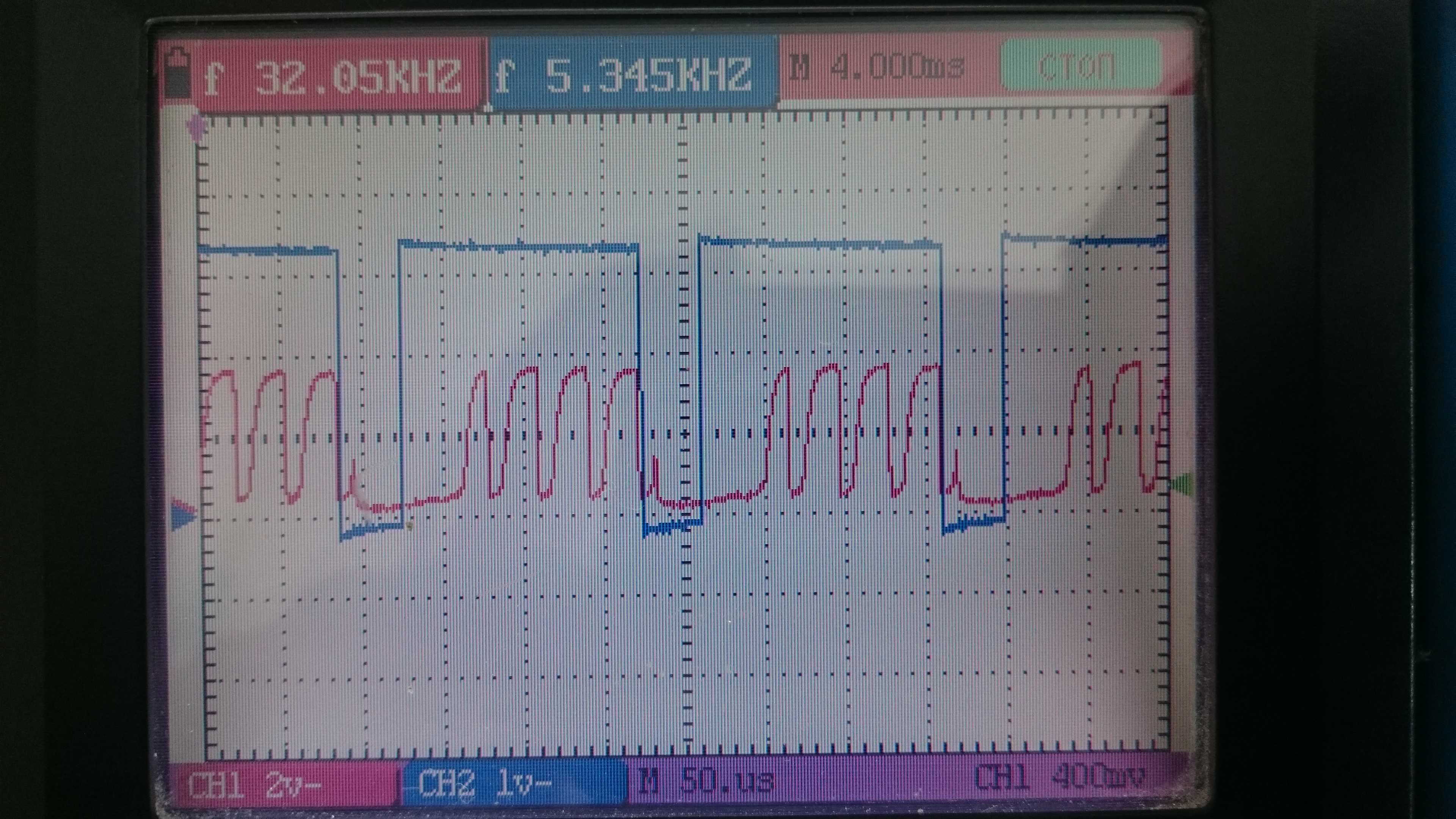

I am using the ADS131E04.
Blue - CS
RED - DRDY signal after opto
ADC.pdf

  • Hello Artem,
    First of all, don't worry about the last bit in the CONFIG3 register. It is a "don't care" bit.
    Let me clarify. Are you saying you consistently read 3 samples of data but the 4th is missing? What could be happening is that your routine to shift the data out could be taking a bit too long and the 4th DRDY never occurs because SCLK is still toggling from the last sample. Please check your interface timing to ensure this is not the case.
    Brian Pisani
  • No.
    3 sample skip for data processing (see first post). After several read DRDY pulse stop. If I set 1kSMP problem still.
    I start reading on rising edge DRDY (rising ADC side -> falling after opto as oscillogram into first post ). Is it right? Or must wait for the second edge DRDY pulse and starting SCLK reading?

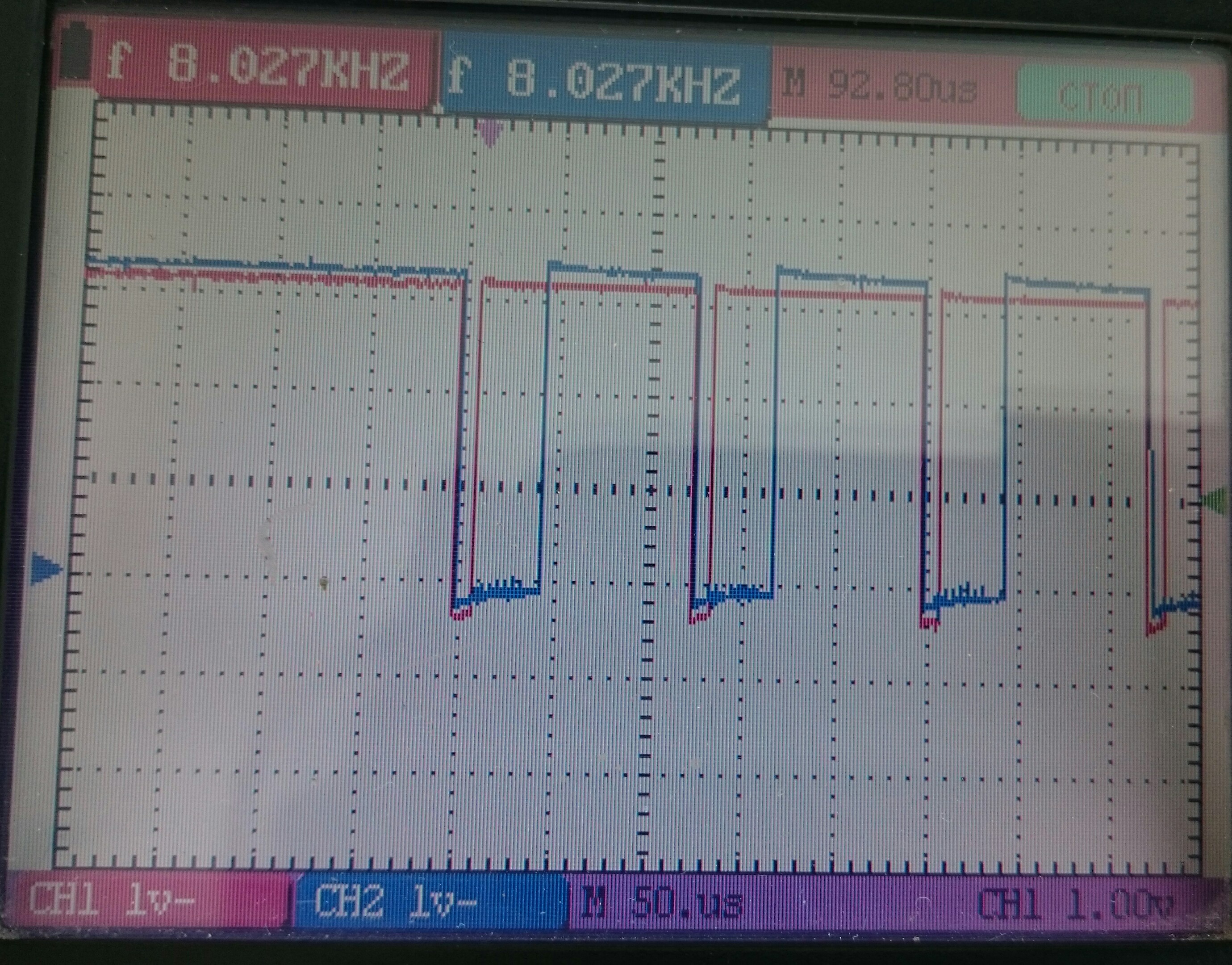

    I changed the optocoupler , and now have a better picture, but problem still.
    red - DRDY (ADC side)
    blue - CS
  • Also, even if not stop DRDY, I reading incorrect values
    (for example, all data 0x00) and sometimes change DRDY freq by default (4kSPS -> 32kSPS )
    The problem does not occur if the input signal is not supplied. whether the correct connection INnN to AGND?

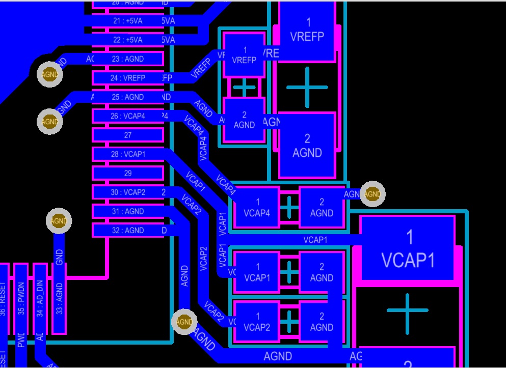

  • Parameters when Input signal not plugged:
    AVDD = 5.4V
    DVDD = 3.28V
    Vref  =  3.92V
    Vcap1 =1.12V
    Vcap2 =2.68V
    Vcap3 =7.4V
    Vcap4 =1.92V
    Parameters when Input signal is plugged to channel 1:
    AVDD = 5.4V
    DVDD = 3.28V
    Vref  =  0V
    Vcap1 =1.12V
    Vcap2 =2.68V
    Vcap3 =7.4V
    Vcap4 =0V
    The first measurement is usually correct. After parameters is left (Vref, Vcap4).
    Vcap4 - ceramic capacitor 1mkF
    Vref  -  ceramic capacitor 0.1mkF and tantalum capacitor TYPE A 10mkF
    what could be causing this?

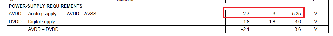

  • Hi Artem,
    I've just noticed that your AVDD = 5.4V is out of the ADS131E04 recommended power supply specs!
    KR,
    Mo.
  • hm.... power supply provided by DC-DC (P6BU-0505) converter +LC filter. Output voltage is higher than the input... I will fix it.
  • I stabilized the parameters.
    Power supply via 3.3V linear regulator. On one channel ADS131 power supply voltage through resistive divider.
    The problem still.

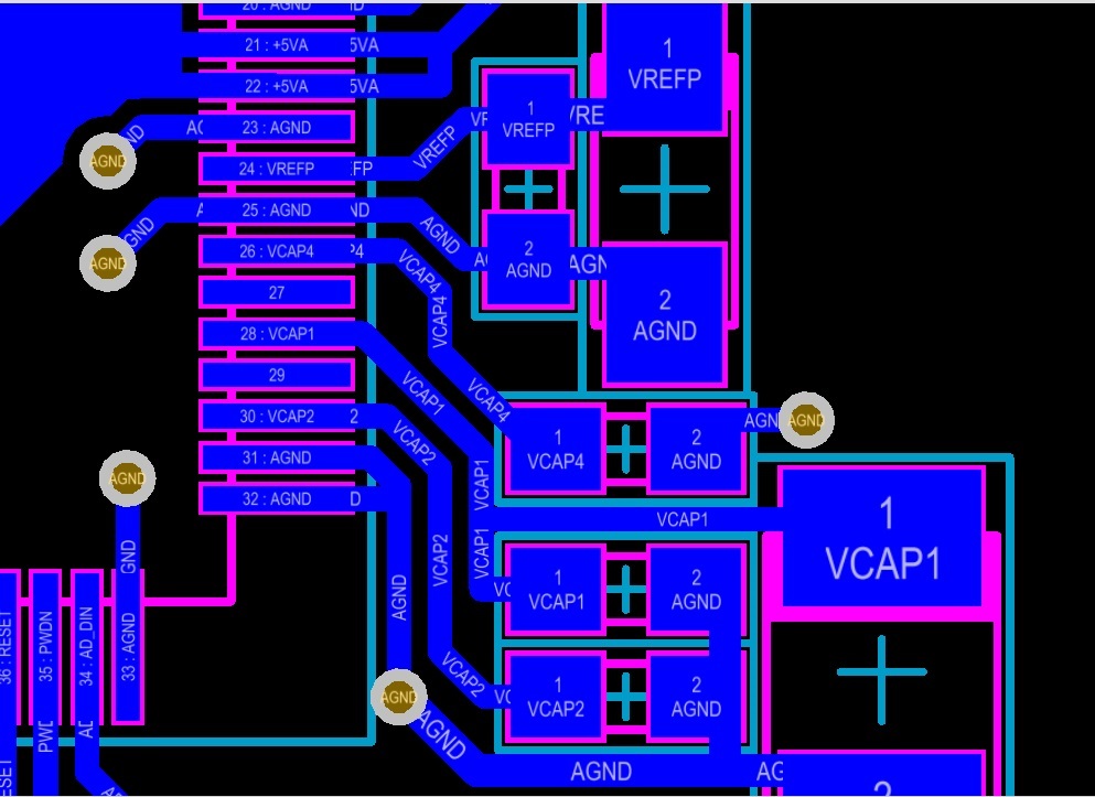

    Please give me an example PCB design, if possible.
  • Hey Artem,
    The schematic at the end of the EVM User's Guide shows how the EVM is built (www.ti.com/.../sbau200b.pdf). Are you using a different IC from the one on the board that was receiving the voltage over the absolute maximum? That one may have been damaged.
