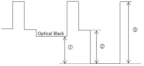

2. About CDS full-scale input span, is it range of a video signal between GND and offset level like case 2?
3. Is there the timing chart and time value for CLCCD, BLKG, OBCLP and ADCCLK?

    2. CCD cells ideally should have no charge at completely dark (optical black) condition, however in reality they have a non-ideal leakage. In order to achieve maximum dynamic range TLV990 samples this optical black offset from CCD cells that are physically covered. Then they are subtracted from the video signal. That way maximum dynamic range is achieved (especially for low-light applications). Since different CCD sensors may use different optical cells, a signal (OBCLP) is needed to tell TLV990 when to sample optical black cells. Optical black compensation is different from CDS(correlated double sampling). CDS samples two different levels within the same pixel. Optical black samples multiple pixels to obtain average offset, and this value is used to compensate for offset each line.
