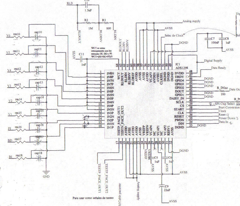

we have problems to get good Stress ECG signal with ADS1198/1298. Diagnostic ECG signal records are fine, but ECG in stress has excesive fast baseline wander. Does anyone know what do we have to do to get good stress ECG signal records?

    we have been trying different digital algorithms alternatives but it seems like the ADS has some problem with baseline wander because normally this kind of fluctuations dont get into the ECG bandwidth. Probably, we are omitting an analog circuitry prior of the ADS. Is there any recommendation?

    We´ve been working with INA122 for some years and we have implemented a lot of those digital algorithms with very good results (we have published some of them, also), but it seems like the ADS1298 does not work well with stress ECG, unless there is something else that we dont know or find in your white papers...

    However, I'd like to try and think through this issue. If you are able to do stress ECG using the INA122, then there must be some difference in the analog front end portion of the circuit. Both chips have front ends with very high input impedance. Could you perhaps point me to some differences between the two designs? Are you using a RL drive amplifier in both designs? Are the electrodes the same? If you are able to share a schematic I would be happy to take a look.
    Brian Pisani
  • I attach below our work paper schematic of a part of the device that uses ADS1298 and the instrumentation made with INA122 that has no problems whith stress ECG. As you can see there, we work with active Right Leg in the ADS1298 design, whereas in the INA122 design we have passive Right Leg. The electrodes are the same (3M).
    Any help will be wellcome!
    Carlos
  • Hey Carlos,
    Interesting note about the RLD. Can you tell me your settings in the CONFIG3 and RLD_SENSP/N registers?
    Brian
