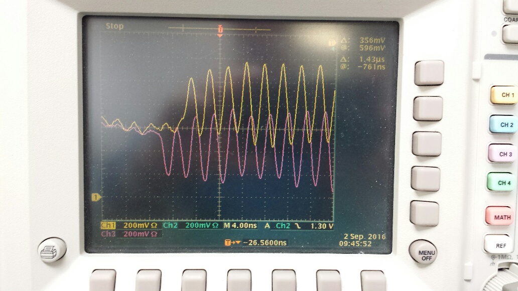

  • So here is the ADC DCLKQ+ output, in the yellow-ish color, when it resumes following the deassertion of DCLK_RST.  I believe we are looking at the positive side of the differential signal here.  The other clock in the pink-ish color is the output clock of a DAC which gets a copy of the same reset.  Anyway, this is the "good" case.

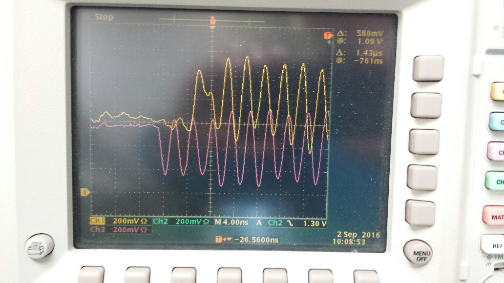

    Here is what it looks like in the "bad" case, which I see about half the time.  Notice the strange double-hump at the start.
    I believe the CLK input to the ADC is a stable 1.25 GHz at this at this time, but it's entirely possible we are messing something up with the DCLK_RST signal.  I believe that signal is being asserted for 500ns, or 625 periods of the ADC input clock.
  • Hi Mike
    I've managed to cobble together a test setup that allows me to apply CLK at 1.25 GHz along with a periodic DCLK_RST pulse and sweep the skew between CLK and DCLK_RST.
    With the same settings you are using everything works fine with the proper alignment of CLK to DCLK_RST. It is possible to adjust the alignment of CLK and DCLK_RST into a range where the transition from the DCLK reset state to the active state is unpredictable, or has a longer than normal initial DCLK period. As long as I keep the CLK to DCLK_RST timing outside that range everything looks good.
    You should review your circuitry which generates DCLK_RST as a function of CLK to confirm the alignment will be consistent, and should meet the setup/hold specifications.
