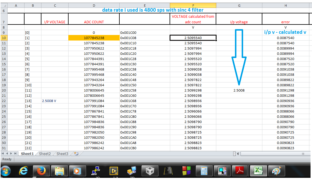

  • Hello Chris,
    i want to reduce noise in my measurement.  i tried almost all data rates from 38k sps to 400sps with different filter configurations.
    i can't tolerate error above 10 micro volt in my application.
    how can i get more accurate result?????
    my input signal is 0-5 volt single ended signal. i am using precise external reference of 5 volt using REF 02.
                                 the below pic contain continuous sample of precise 2.5008 volt input signal at 4800 sps with sin4 digital filter
    why my count is varying that much when my reference is precise and input signal is precise
