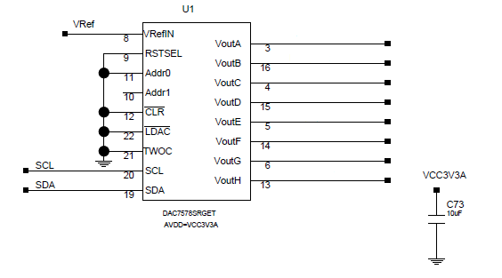

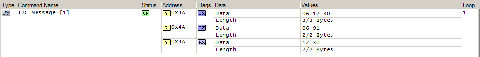

To sum up: DAC7578 is responding on the wrong address and appears to be doing so independent of what the address pins are pulled to. This happening to only a subset of boards and has been fixed by replacing the DAC. I'm looking for some sort of smoking gun or possible root cause, possibly some sort of advice for our contract manufacturer if this related to assembly/handling.
I've built ~100 boards with the schematic/layout detailed below and on a large potion of them DAC7578 behaves as expected, however on a subset of them (~10) it appears to just not respond on I2C. Continuity checks on I2C data/clock show a good connection, visual and xray inspection of the parts show no skew or shorts.
While troubleshooting I decided to try all of the possible addresses that the DAC could be on and I found that the part was responding on the wrong address! The expected address with Addr0 = 0 and Addr1 = float would be 0x4C, on 3 different failed boards I was getting a response on 0x4A instead. This is an address which would be consistent with Addr = 0 and Addr1 = 1.
This is in a test setup where the only I2C device on the bus is DAC7578 and I am using a telos XL2.0 I2C debugger. I am sending a 123 into the 6th channel buffer and then attempting to read back that buffer, 0x4C NAKs, but 0x4A gives the correct response.
The next thing I checked was what would happen if I pulled down Addr1, in case there was some slightly lower impedance pulling it up internally-
It should respond on 0x48 with Addr0 and Addr1 = 0. There device NAK'd and continued to communicate on 0x4A.

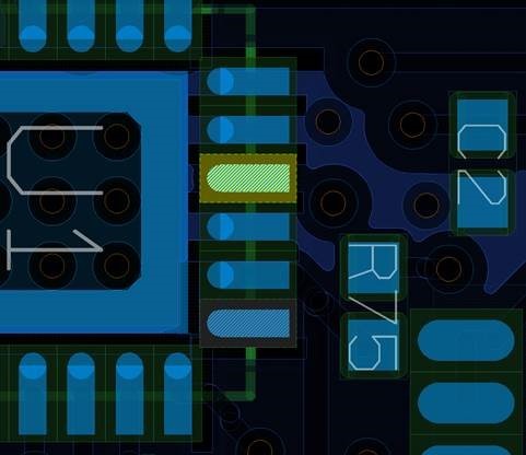

Here is the schematic and layout of DAC7578.
On the board layout there are no pins adjacent to Addr1 that could have bridged solder and pulled it up, every adjacent pin is GND. The via closest to it is -20V and is not bridged.  As mentioned before, visually the chip appears soldered correctly with no skew.

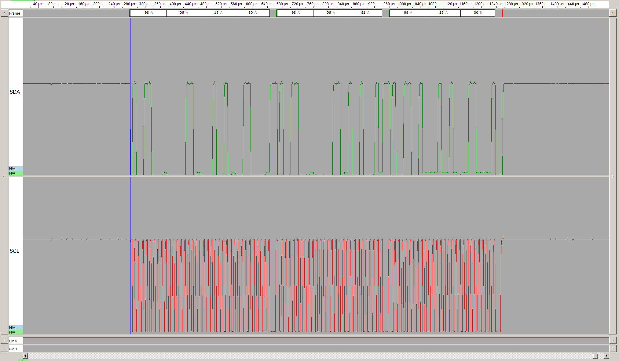

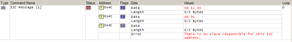

  • Using the I2C ADC in lieu of a scope for expediency- I can get high res scope traces if you need  them.
    Below: 0x4A communicating normally
    Below: 0x4C NAKing

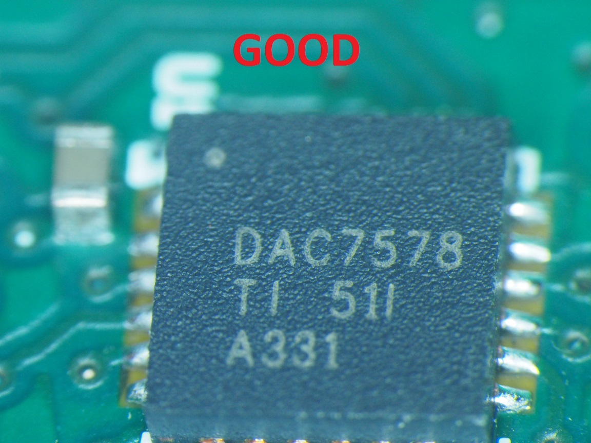

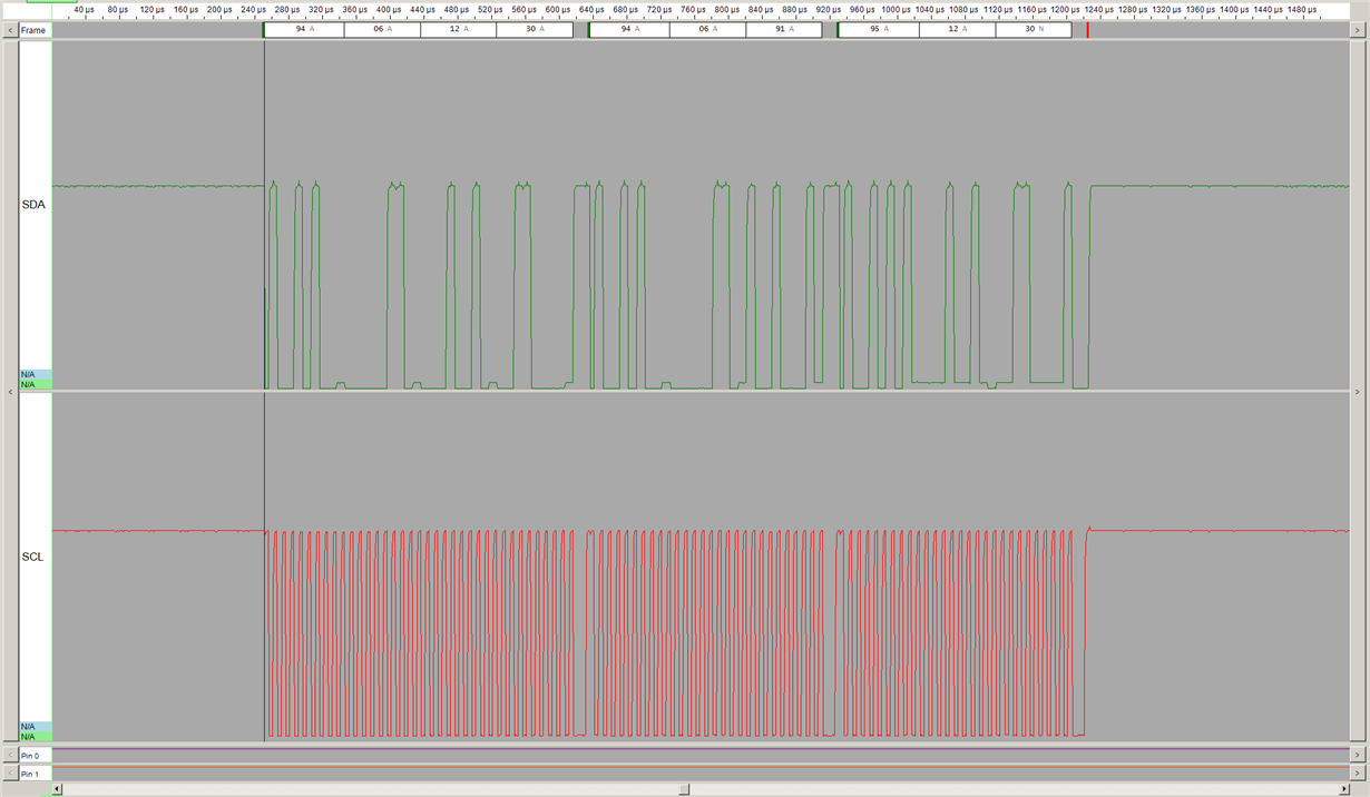

  • For reference, here is the same command working on 0x4C on a "good" board:

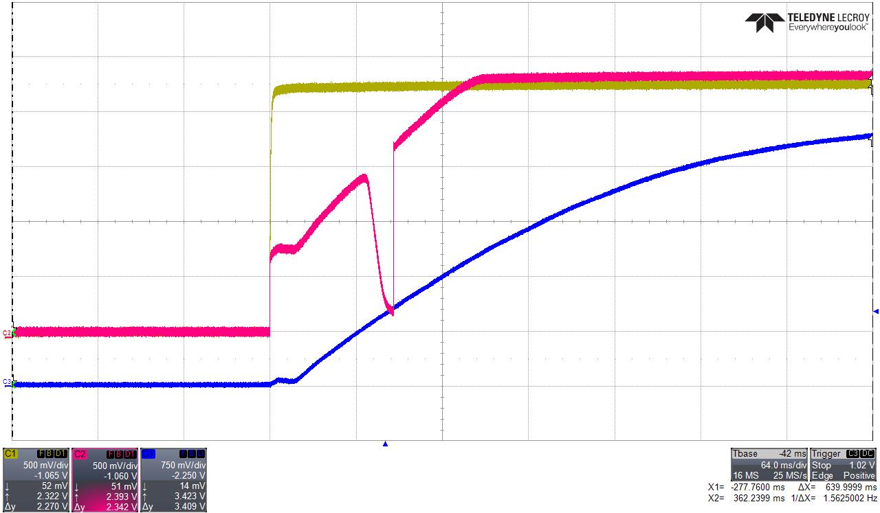

    Is it possible to provide a picture of the AVDD pin when power is applied? If the supply is not brought up linearly there is a small chance that the internal OTP will load incorrect trim values -- this will affect the behavior of the device.
    Matt
  • There's nothing too remarkable in the VDD as it comes up on its own, it's running off a local linear regulator
    I have also plotted what SCL and SDA look like when the board powers up, they are powered from a switcher and come up before the VDD regulator comes up.
    C1 is SCL
    C2 is SDA
    C3 is VDD
    This is what the supplies look like when the system is hooked up to debug equipment, the misbehavior happens regardless of the equipment connected, but I'm including it for completeness sake. The system is hooked up through a USB cable and JTAG in this and is drawing some amount of power, which offsets the initial I2C voltages slightly.
    C1 is SCL
    C2 is SDA
    C3 is VDD

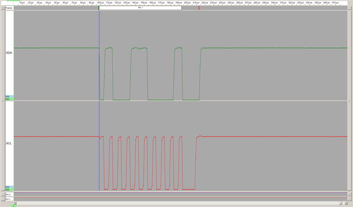

  • Here are some more scope captures of I2C-
    This is an example of a "good" behavior, responding on 0x4C.
    This is an example of "bad" behavior, NAKing on 0x4C
    This is an example of the same board that NAK'd 0x4C responding on 0x4A:

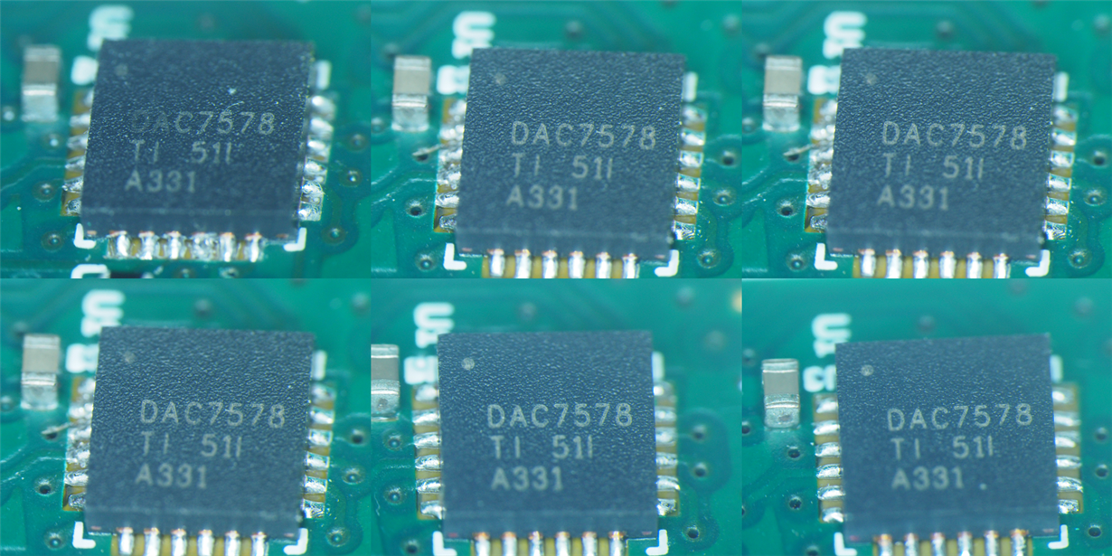

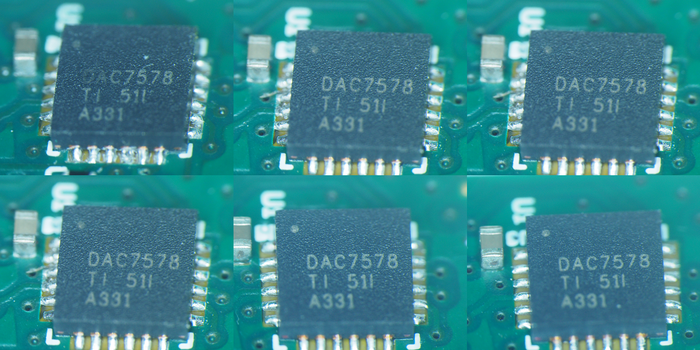

  • This is a responsive dac from our first batch
    From top left to bottom right are oldest -> newest, with the rightmost 2 in the bottom row coming from our most recent batch. These all have the same issue where they respond on 0x4A instead of 0x4C

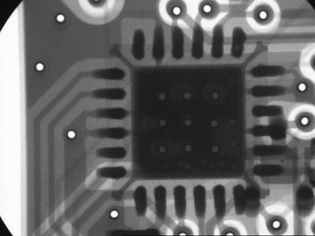

    Our CM will be xraying some of the failing boards to see if there could be anything slight shorts that were missed- do you have any thoughts on which pins could be getting shorted or possibly marginally connected? - This behavior is inconsistent with what would happen if the address lines were shorted.

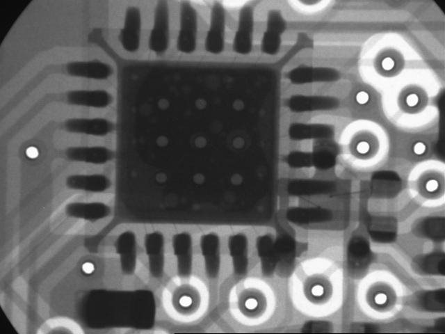

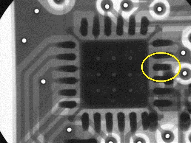

  • We had 7 boards that were failing xrayed, and all of them showed no soldering defects, this seems to indicate that there is some voltage leaking internally-
    The shadow is from a pad on the opposite side of the board.
    Could I send any of these parts in for FMA?  If there are any requirements  (part on/off board) please let me know.
