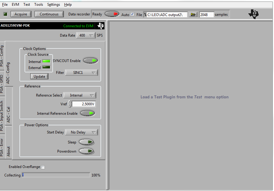

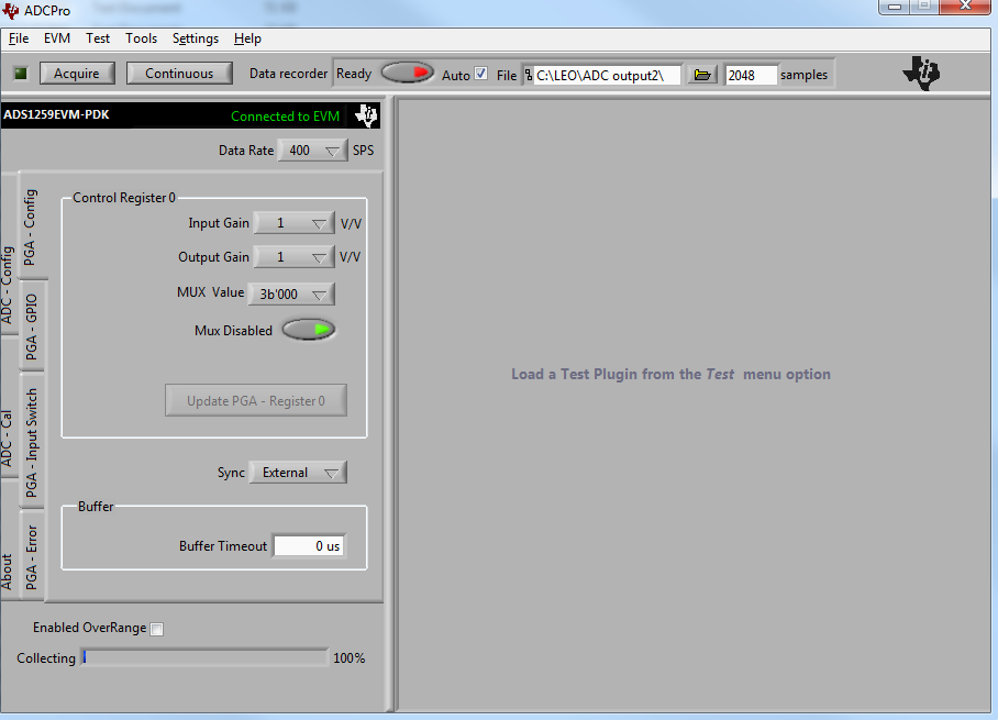

    I am using ADCpro for ADS1259evm. I use the data recorder to record the data. the setting is as following.

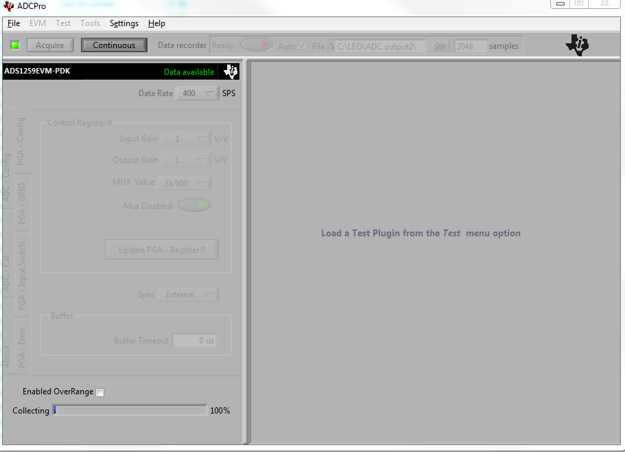

This setting used to work well. But right now it doesn't work. After I click continuous, it only report data available but no data is recorded as following:
Even after re- install ADCPro software or 1259 pdk, it still doesn't work and no data can be recorded.
Is there anyone can help me to fix this problem?

  • yes,  the +- 10V power supply is provided by the HP e3631A DC power supply when I use the EVM.
    I tried many times by rebooting the EVM board. I noticed the ADCpro record the data sometimes but sometime it doesn't.  I also notice if I choose the PGA is sync by the ADC, the ADCpro almost cannot record the data. I think it is weird but do not know why. I even cannot turn off the EVM board  overnight because I afraid it cannot record data next time when I reboot it.  Will it burn if I turn on the EVM but let it in idle for several days or weeks?

  • Hi You li,
    I replicated the issue again I think I've identified the problem...
    You must first load the EVM plugin and one of the TEST plugins from the "Test" menu.
    Without both types of plugins loaded, ADCPro will not be able to collect the data. Usually ADCPro disables the "Acquire" and "Continuous" buttons until you've loaded these plugins; however, by enabling the data recorder you were able to bypass this requirement. Make sure you load a test plugin before you attempt to collect data.
    Let me know if that solves the problem!
