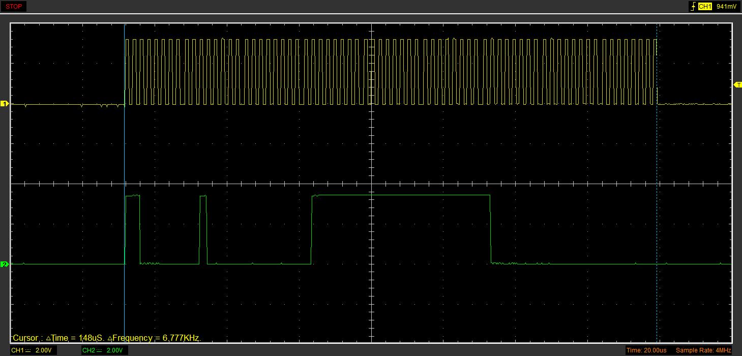

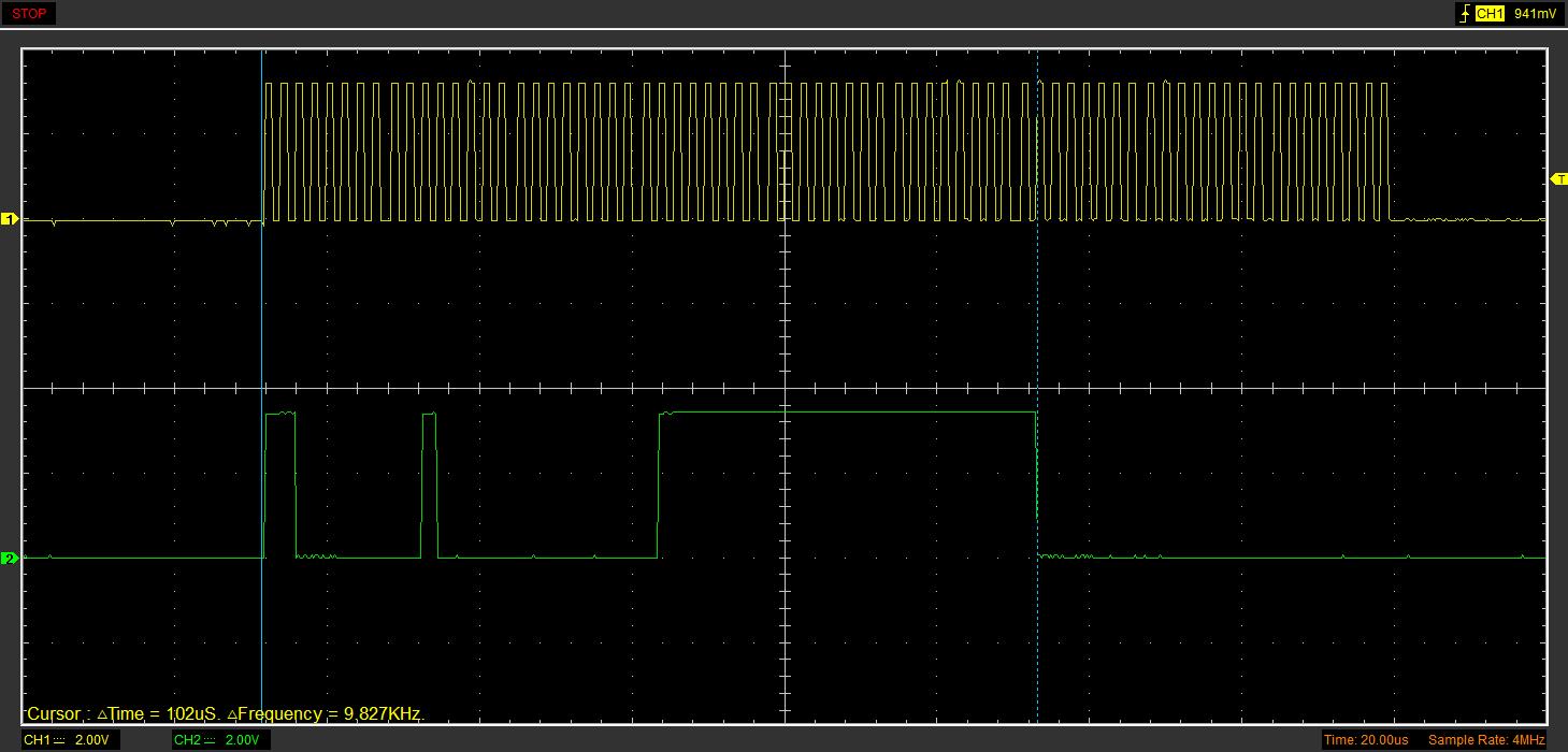

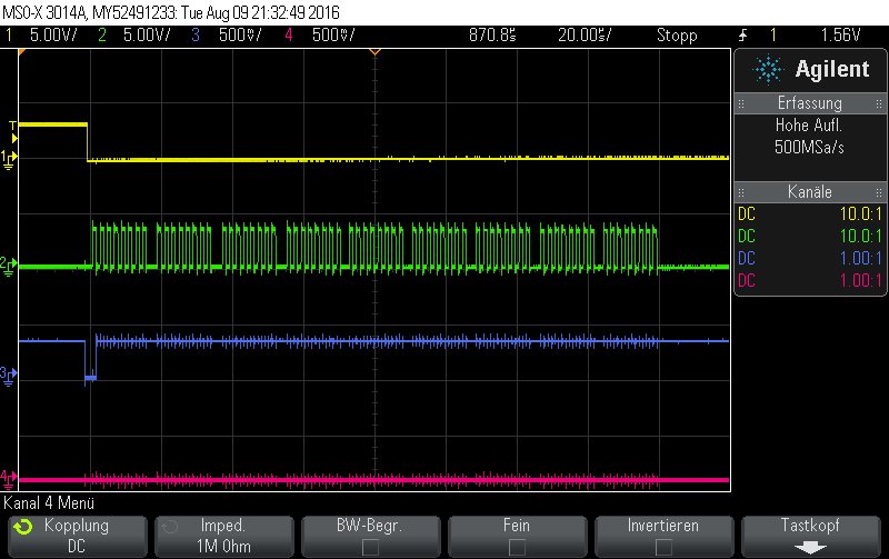

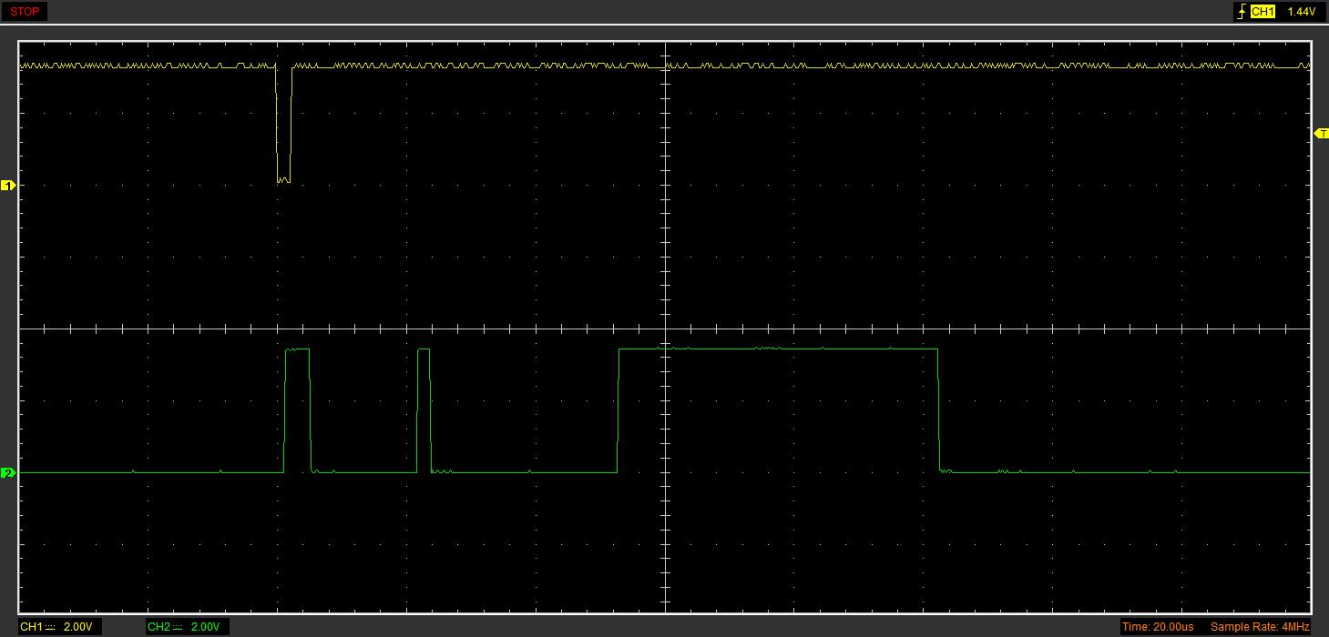

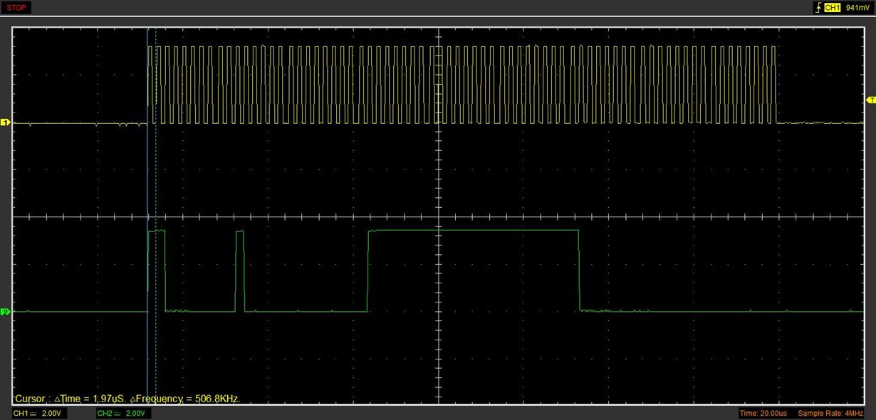

Picture 1  CH1: SPI-Clock   CH2: Pin DOUT from the ADS1292R   CURSOR: Shows the Length of the Data Burst (148µs)

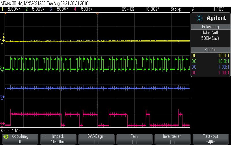

Picture 2:   CH1: SPI-Clock   CH2: Pin DOUT from the ADS1292R   CURSOR: Tclk=2µs -> fclk=500kHz

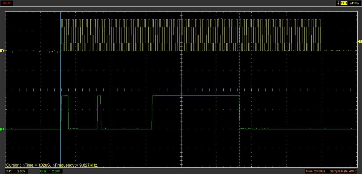

Picture 3:   CH1: SPI-Clock   CH2: Pin DOUT from the ADS1292R   CURSOR: Shows the Length of Data shifted out by the ADS1292R

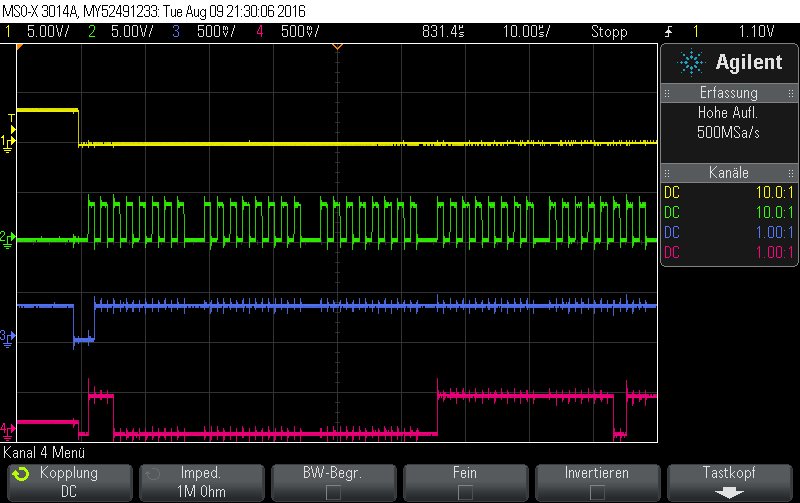

Picture 4:   CH1: DRDY Pin of the ADS1292R   CH2: Pin DOUT from the ADS1292R   CURSOR: Shows the Length of Data shifted out by the ADS1292R

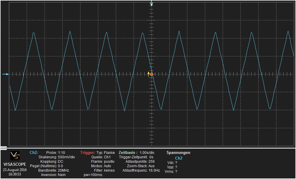

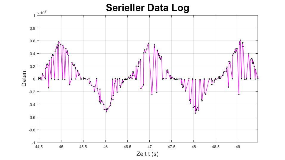

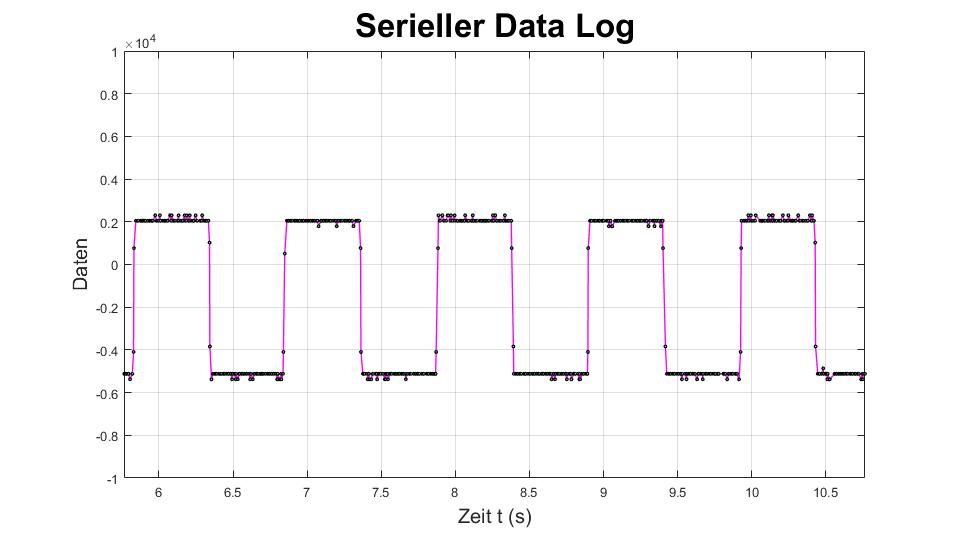

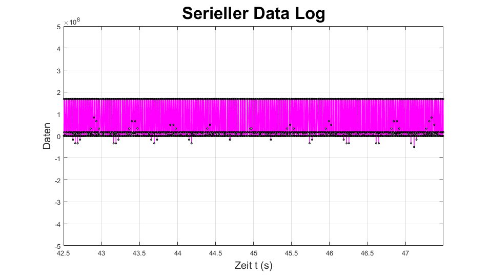

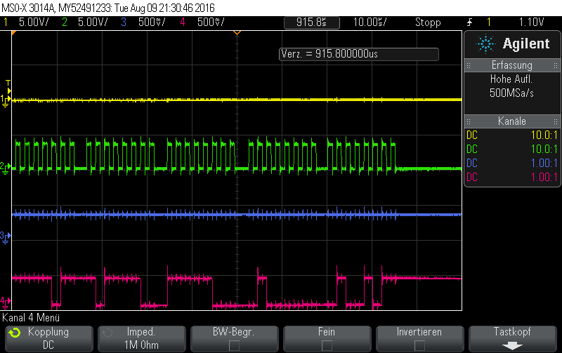

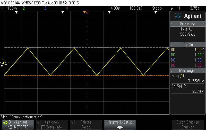

  • Hello Tom,
    thank you for your answer! Meanwhile we managed to get serial data from the ADS1292R.
    As expected, the bits of CH1 and CH2 in the SPI Datagram are moving around when we touch the electrodes. To verify the data, we applied a triangular voltage to IN2P and IN2N, and sent it to MATLAB via UART. Unfortunately the result is a signal, in which we can hardly recognize the applied triangular voltage signal. There is a lot of noise and we don't have any clue where it comes from.
    In RDATAC mode the MOSI line is zero all the time since we are shifting out dummy data 0x00.

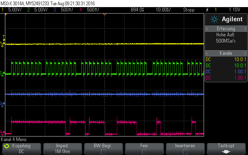

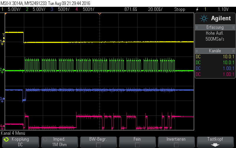

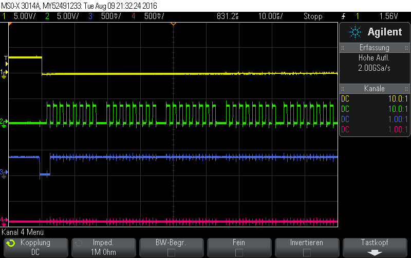

    Is there a major mistake in the schematic? Or do you we have some software problems? Didn't we set up the ADS properly? Any tips are welcome!

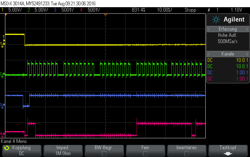

    Input:
    Scope Capture1:
    CH1: /CS CH2: SCLK CH3: DRDY CH4: MISO
    Scope Capture 2:
    CH1: /CS CH2: SCLK CH3: DRDY CH4: MOSI

  • Hey Tom,
    to doublecheck the Connection between ADS1292R<->Microcontroller<->COM-Port<->MATLAB, we enabled the Test-Signal on CH2 and got the following plot:
    Settings of the ADS1292R are:
    I've got 2 questions:
    -The testsignal looks good, but it has an offset. Is that normal? I scaled the glitches to the reference and calculated following values: Vintf=200*(2.42V/2^23)=57.7µV Ist that a regular value? Offset would be like: Voff=1900*(2.42V/2^23)=548.12µV
    -How do i have to set the registers properly to recieve an ECG Signal on CH2 with the following schematic
    ADS1292R-SChaltplan.pdf
    Thank you!!

  • meanwhile we recieved following testsignal on CH2. It's still asymmetrical but we can see noise at both the top and the bottom value. Is the testsignal realistic or does it still look faulty to you?
    Register settings are:
    Recieved signal:
    After recieving the testsignal we changed the registersettings for real data aquisition on CH2. We changed CH2SET to b0000 0000 ([Bit 7]: Normal operation [Bit 6-4]: Gain=6 [Bit 3-0]: Normal electrode input). And CONFIG2 to b1010 0000 (INT_TEST=Off; TEST_FREQ=At DC).
    Then we applied a 0.5Hz triangular voltage with Vpp~2V to IN2P and IN2N and got the following results:
    New register settings:
    Signal on IN2P and IN2N:
    Recieved Data:
    If we don't even get a Signal with Vpp=2V properly, we'll never manage to get a Signal with less than Vpp=5mV. Do you have an Tipps? Is there a mistake in our analog-circuit?
    Thank you, Tom!!
  • Hi m k16,
    This is the test signal that I see when I have the same register settings as you:
    Since these settings put the sample rate at 125SPS, I grabbed 1250 samples to try and match your 10 seconds of data in the first plot. What is your ‘Y’ scale and why is it so different (+0.2 to -0.5) now compared to the plot from the 12th ( +3500 to +~1900)?

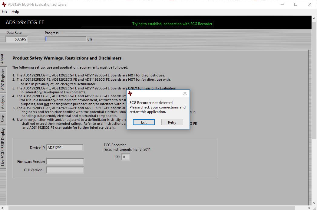

  • Hey Tom,

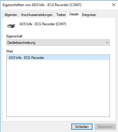

    we purchased the ADS1292RECG-FE (http://www.ti.com/tool/ads1292recg-fe) and followed the installation-Guide. Unfortunately the provided pc-application can not connect to the ADS1292R demonstration kit. The driver installation was succesful, but the device is displayed with a warning in the device-manager. What's wrong here? We used different PC's and OS(Win 10/7/XP) and rund the application as admin. The green LED is flashing.
  • Hi m K16,
    The blinking green light is normal - that at least lets you know the board is working. What shows up under the Driver Details tab? You might have to manually update the driver by clicking on the 'Update Driver' -> 'Browse my computer...' and then navigate to C:\Program Files (x86)\Texas Instruments\ADS1x9xevm\USB Drivers. Let me know if that resolves the problem.

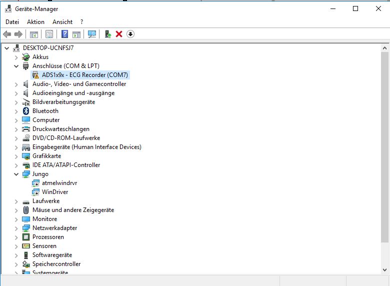

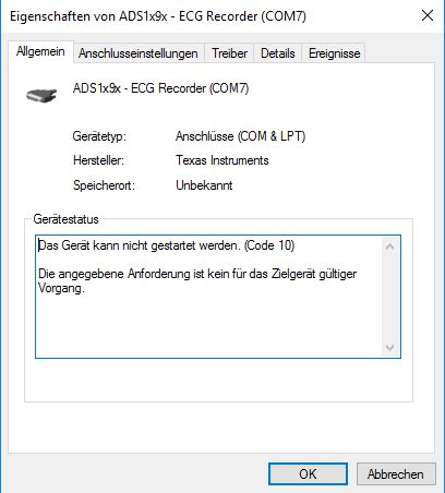

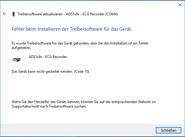

  • Hi Tom,
    thank you for your answer. I already updated the driver manually and if i try it again, i get the message "the best driver software for your device is already installed". The Driver Details tab shows the following:
    thanks
    Marvin
  • Hi Marvin,
    Take a look at this post and let me know if that works for you:
    e2e.ti.com/.../1610010
  • Hi Tom,
    thanks for your answer. That thread does not fix the problem for me. Under Win10 i alredy disabled driver signatures, because i wasn't abled to install the driver. After disabling the driver signature, i installed the driver as it is shown in the user's guide. It finished with the following dialog.
    When I plug the board on to my (or any other) pc, the system does not show any prompt like it normally does ("device conneced" o.s.). Is that a normal behaviour?
    thank you so much, Tom
