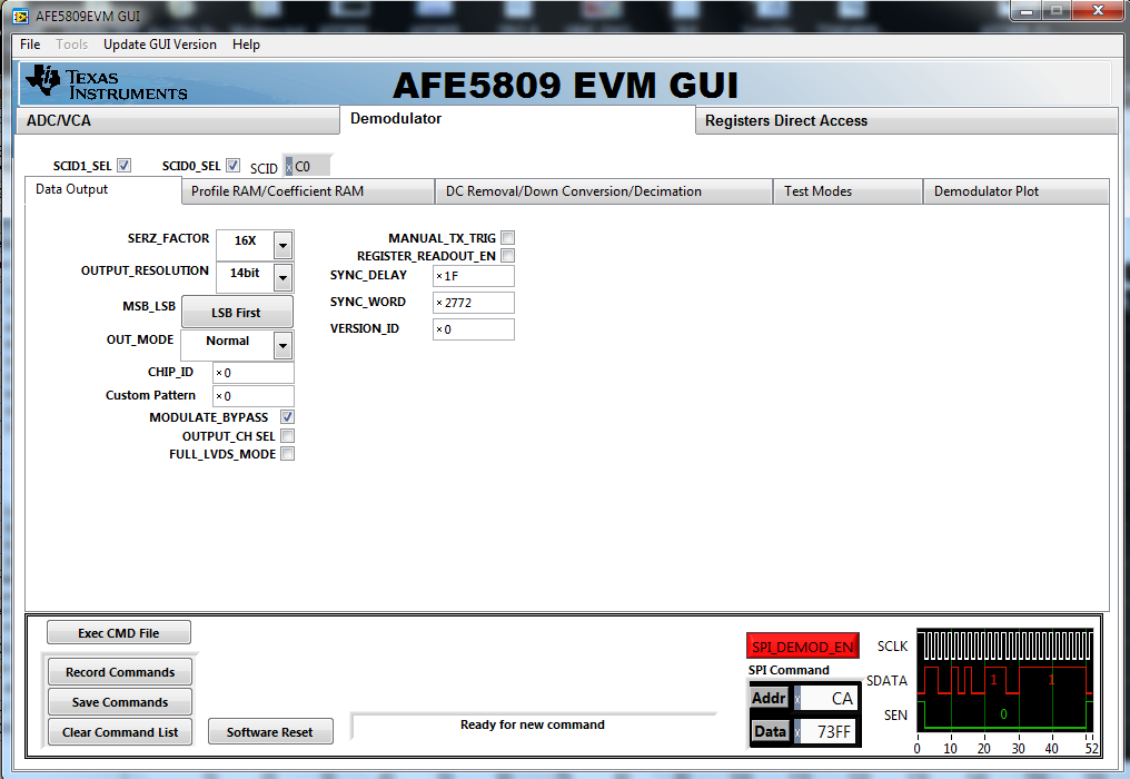

I'm developing a AFE5809 + FPGA + Application SoC system.
The FPGA relies on the sync word in the LVDS channels of AFE5809 to function properly so I can not turn the demodulator off.
Is it possible to leave the demodulator enabled but let it pass ADC data through?
I'm thinking about:
set M=1; MODULATE_BYPASS 0x0A[14]=0; OUTPUT_CHANNEL_SEL 0x0A[11]=0; DWN_CNV_BYPASS 0x0A[2]=1
And set coefficient ram to a single impulse, and set profile RAM to a unit gain.
then ADC data will by pass down conversion, while decimation filter and decimation do nothing.
Is this correct?
So basically what I'm asking is, when down conversion is bypassed, is the ADC data passed unchanged to the I channel while Q channel is always 0?

  • Dehuan,
    Yes, if you want to bypass the DEMOD block, but keep the sync word,  please follow this configuration:
    EN_DEMOD =0
    DC_REMOVAL_BYP, DWN_CNV_BYP, DEC_BYP = 1
    M=1
    Modulate_Byp = 0 (enable to remove the sync word)
    Output_ch_sel = 0 (ch A)

  • Hi Dehuan,
    According to your bypass settings for DC_removal, DWN_CNV and DEC.
    there is shown on the GUI:
    Then, First:
    1) Set the DEMOD block = ON
    Then, we tested and got the result (your signal + sync word):
    2) Set the DEMOD block = OFF
    Then, we tested and got the result (your signal + NO sync word):
    This just looks like only input signal without using Demod mode.
    Thanks and best regards,
    Chen
  • Hi Dehuan,
    Here are the explanations of the setting to display Sync Word signal.
    1) Here is the AFE5809 register settings:
    2) After that when you are running TSW1400 GUI to the AFE5809 device,
    you should see the Sync Word showing including the capture data as well.
    One shows the captured data from CH3.
    The other shows the captured data from CH4.
    Thank you very much for using AFE5809 EVM and TSW1400 EVM.
    Chen
