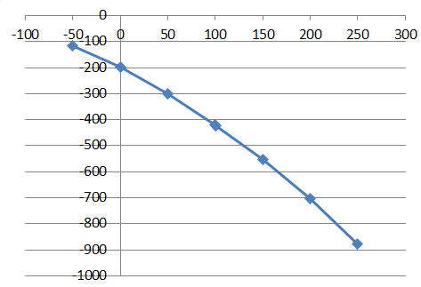

    Going back to your results and assuming that you have somehow gotten a full scale of 2^16 (65535), I'll just assume that the Observed Count is the ADC data. If you take the Observed count and subtract the Expected Count, you can see the error in the system. It's plotted in the data and graph below:
    IpTemp ResPT1000 Expected Count Observed Count Error
    i/p CntbyAdc/0X7FFF Practical
    -50 803.1 19493 19376 -117
    0 1000 24272 24074 -198
    50 1194 28981 28682 -299
    100 1385.1 33619 33200 -419
    101 1388.9 33712 33290 -422
    150 1573.3 38188 37634 -554
    200 1758.6 42685 41982 -703
    250 1941 47113 46237 -876
    You can also see that the error gets larger with the input. While there is a small amount of non-linear bow in it, it also looks like the error is primarily a gain error with an offset error added in. There's about a 100 counts of non-linearity error also.

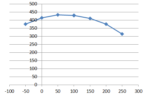

    Let's assume the reference resistor is 2.77k instead of 2.7k, the you get this curve set of data:
    -50 803.1 19000.7 19376 375.2918412
    0 1000 23659.2 24074 414.7942238
    50 1194 28249.1 28682 432.9083032
    100 1385.1 32770.4 33200 429.6340794
    101 1388.9 32860.3 33290 429.7290975
    150 1573.3 37223.0 37634 410.9715523
    200 1758.6 41607.1 41982 374.920722
    250 1941 45922.5 46237 314.4815884
    By adjusting the reference resistor, I'm just showing that there is a gain error that is part of this measurement. Here the gain error is adjusted out by a change of 0.07k out of 2.7k or 2.6%. There's also an offset of 300 to 400 counts. Both seem like large amounts of each error. I'm not saying that the error is coming from the reference resistor. I'm just using this to show approximately how much error is part of the system. Some quick sources of error might be the gain error of the ADC (0.5% max), the mismatch error of the IDAC (0.15% typ), but neither are enough to explain the large error that you're seeing.
    If your reference resistor had an accuracy of 2%, then you might see this kind of error. Other than that, you may be losing current through some of the circuitry connected to the reference or RTD.
