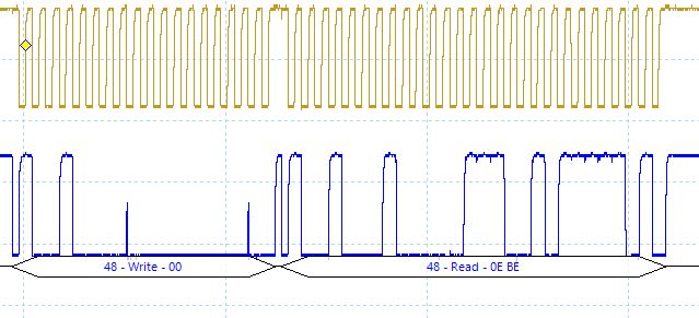

I haven't been able to get the conversion result out of the ADS1115 - it always returns 0x85 0x83 no matter what I do.

This is the screenshot from my scope with I2C analyzer:
What I can see is that after the first four bytes are sent (0x90 0x01 0x84 0x83), the last byte of this group (0x83) is NACKed and so is NACKed the second readout byte (0x83 again) at the end of the scope trace. The last two bytes 0x85 0x83 are the bytes I am reading out no matter what I do with the converter and it never changes.
Any ideas what I might be doing wrong? Thanks!
