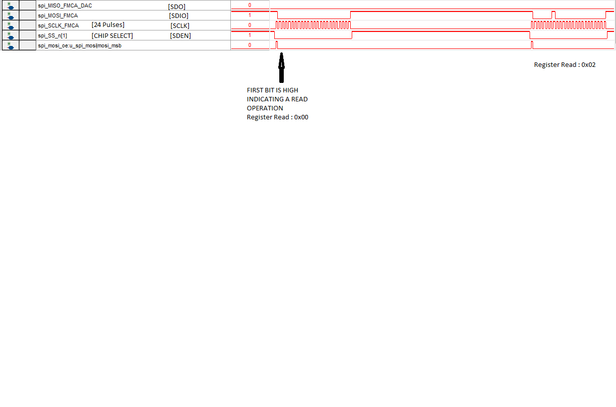

I am trying to configure the DAC chip with SPI 4-wire interface. I initially perform SPI write of all DAC Registers and then try to read some of the registers. I believe the SPI write operation happening effectively as I can see that from the MOSI signal from the scope. But when I try to read few of the registers, I see that the MISO signal remains LOW(0) all the time. I also ensured that I am not reading only the registers with "0000" default/written value. Irrespective of any register read, I see MISO signal to be LOW(0).
I have previously worked on ADC where ADC had a 'SPI_CONFIG' register to set the MISO voltage which controlled its operation. However I don't see any such register mapping or option for DAC. So can you let me know what might possibly the problem to be? Should a Voltage be set for this MISO pin for its operation? If yes, what should be the ideal value or range?

  • Anuj,
    A scope shot consist of a 4 signals including SCLK, SDEN, SDO, and SDIO will be helpful in the debug. Also keep mind that there is a write/read transaction bit at the beginning to identify either write or read process. Some folks miss this and was not able to talk to the device correctly.

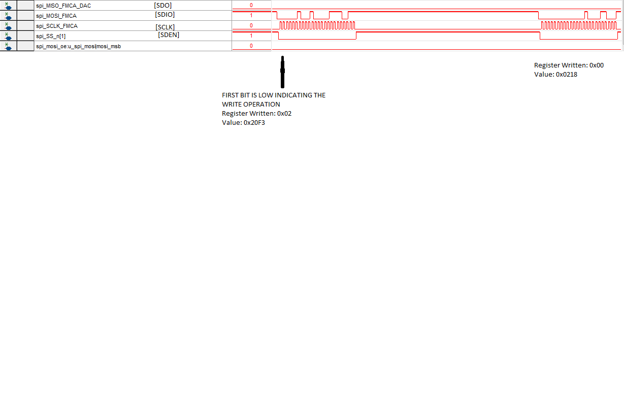

  • Hello Kang,
    Please find attached the screenshot for both READ and WRITE Operation. I have mentioned the register address and the data being written and read in the screenshot.
    For Write Operation: First BIT of SDIO is LOW(0) indicating the WRITE Operation.
    For Read Operation: First BIT of SDIO is HIGH(1) indicating the READ Operation.
    I hope this part is correct and as expected.
    Do let me know if any further information is required.
    Anuj
    FIGURE 1: SPI WRITE OPERATION
    FIGURE 2: SPI READ OPERATION
  • Anuj,
    I am really looking for a true scope shot measured with actual setup/hold time of all the waveforms. A simple chipscope capture may not see issues such as actual IO levels and timing. (You are seeing what you think you are sending, not measuring what you are actually sending).
