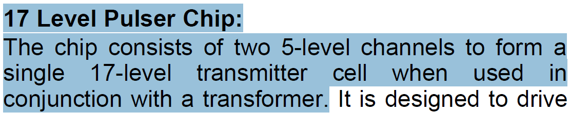

    There are two analog outputs (with very high voltages) from the TX517.
    One is CHA OUTA and the other is CHB OUTB.
    We use a transformer to combine OUTA and OUTB together
    to create the OUTA-OUTB output to multi-level pulses.
    You can see the explanation from our TX517 data sheet and users guide:
    also shown below:

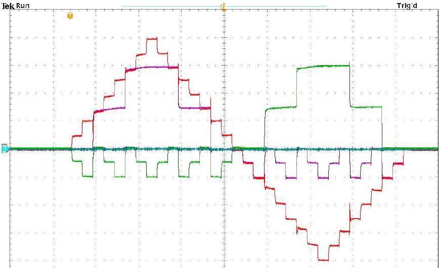

    For example:
    Here is the plot showing:
    CHA OUTA (shown in purple color) 5-level
    CHB OUTB (shown in green color) 5-level
    OUTA-OUTB (shown in Red color) 17-level
    (Can be done by using a transformer)

  • Thomas,
    The TX517 can be used as a dual-channel, 5-level TX, or a single-channel 17-level TX.  To achieve 17-level, you need to use a transformer to subtract OUTB from OUTA.  For instance, OUTA=+60V, OUTB=-20V, then XFMR output is then +80V. The diodes are for damping.  when the signal drops below ABS(Vdiode), then the output at C11 is isolated from the TX517 and XFMR output.

  • Hi Thomas,
    The advantage of using a transformer is:
    Each channel output has 5 levels with high voltages.
    You can just use one channel output with its own load resistor for that channel.
    In this case we don't need to use any transformer.
    You can use two channel OUTA and OUTB with different output signals
    and connect them to a transformer inputs to generate OUTA-OUTB signal at the end of the transformer output.
    In this case the output has 17 levels with very high voltage.
