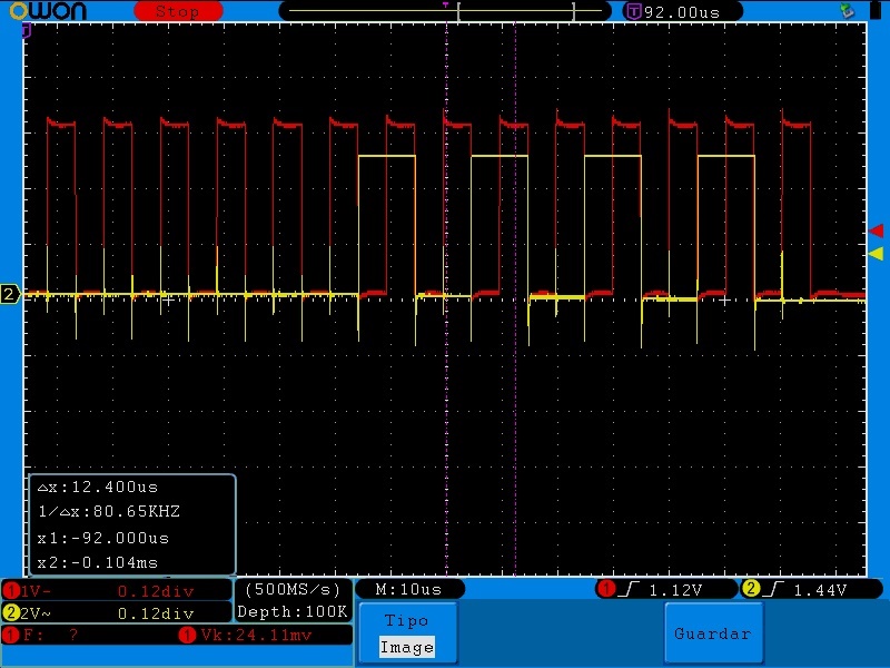

I've been reading different post in here but non of it represents my problem.
I made a prototype using ADS1298 and a NXP1769 MCU, decided to use bipolar in the design but until yesterday I used unipolar power supply with no problem at all for reading the ID and write in the GPIO registers of the ADS so I thought that is was working fine. Today I connected the bipolar power supply and its not working at all. I double check the voltages of:
AVDD: 1.5V
AVSS: - 1.5V
DVDD: 3.3 V
Using this bipolar configuration and the same code I'm not able to read ID register or use the GPIO, BUT rarely when the code start for asking samples of the testing signal (the same code used to get ID, GPIO and the testsignal) Ive got a 16KHz DATAREADY, but I dont know what this means because the code is made for a 500SPS sampling.
I use the internal oscillator, which I understand is 2.048MHz, by connecting the pin CLKSEL (52) to DVDD, 3.3 V.
Then, i set the following sequence:
Wait for oscillator to beggin.
Get all pins to 0.
Wait for power supplies,
Set PWDN to 1.
Send Command RESET 0x06
Ive also test that the Voltage between VCAP1's terminals reachs 1.1V before sending any other command command.
Then send SDATAC, and write configuration registers as:
CONFIG3 0xC0
CONFIG1 0xC6
CONFIG2 0x10
After this, if only connect the positive power source, im able to read ID correctly and use the GPIOs. But with the bipolar configuration that do nothing (read 0x00) and GPIOS do not activate.
If code nedeed, I attached it in this post. I use several functions CMSIS so if you have any idea whats going on I can debug it and reply.

  • Thanks for the reply Brian. Are you sure about that 1V? Because as you said "VCAP1: AVSS + 1.2V" and in this case AVSS = -1.5V seems like fine to me the -300mV in that pin of the ADS.
    Please confirm to me this values  and I will check againt the soldering.
    Also, I got a base board where I tried the SPI comunication, but I dont know if the configuration is the correct one for ADS1298. Can you also confirm this to me?
    Red: Clock
    Yellow: MOSI
    Image:
    I try to send 0xAA just to probe the SPI com, I know that is not a code to the ADS, but I'm a litle bit confused about CPOL and CPHA in the ADS1298. Is the picture correct?
    Thanks in advance
    Juani!

  • Ok, I fixed that. The previous picture was taken incorrectly by setting both channel triggers. The polarity and phase were fine.
    I solved another problem that as you can see, the SPIcomm was for 16 bit and not for 8.
    Now Ive got another problem. I can see the 2.048MHz CLK, and ADS sends DataReady to the MCU external interrupt. But the value in the MISO is always 1, so the reading in MCU is always 0xFFFFFF.
