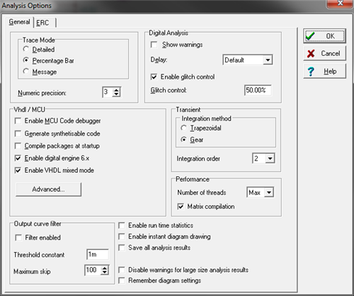

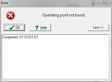

    I tried to simulate (menu Analysis\Transient...) the file you sent, but unfortunately I get  the following error:
    In menu 'Analysis\ Set Analysis Parameters' I loaded the 'TINA default' setting and I also tried to increase the 'DC max. iteration number' to '10 000' but I still get the same error.
    Do you know what it could be? Do you use the same settings in TINA-TI? These are my settings in menu 'Analysis\Options':
    It would be great if I could also simulate the circuit.

  • Hi Sebastian,
    I used the full-version of TINA Classic; where the convergence issue does not appear to occur.  While performing the simulation with the TINA Basic version; I obtain the same error; it may be that the basic version has trouble converging with the complex circuit.
    Attached is a new simulation using a simplified model for the Ref Input of the ADS8860.  The simplified model (developed by colleague Tim Green) is a conservative approximation, as it assumes the worst case where the Reference pin is sampled by the MSB capacitor several times during the 710nS conversion period (the reference is sampled by a binary weighted capacitor for every bit decision during the conversion period).  The conservative result approximates the ADS8860 TINA model on the web but converges much quickly.  The droop on this simulation is around ~47uV, still within ~1LSB 16 Bit requirement for VREF=4.5V
    Please find attached.
